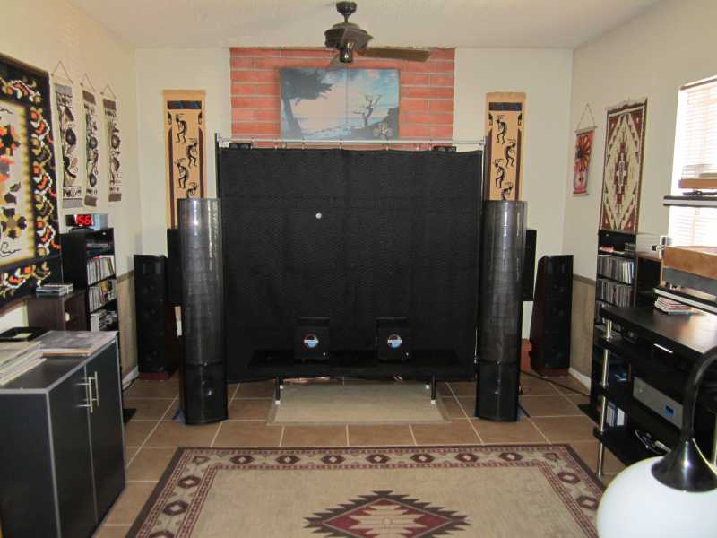

Hi Ben, I can try. This is probably relating to only ESLs with curved panels. For the angle from the center of the front face of the panels I find mine need to be approximately 10 degrees outside of the center line to the listening position. The more on center they are the less (surprising but it is in agreement with what Martin Logan suggests) high frequency you get. If you cross them inside the center line the treble will go up, but the imaging will suffer as there will be too much in the way of side wall reflections. BTW the complicated formula that ML provides for best placement does not work in my room. For the tilt or rake the angle will be harder to relate to the listening position. The top of my ESLs are approximately 1.5 inches tilted rearward from the front of the base. The amount of rake definitely alters the response. I find that too little will cause an exaggerated treble. Too much will result in a warmer sound. Not unpleasant, but lacking id detail and definition. The exact angle of the rake seems to depend a lot on how high the ceiling is. The distance relates to both reinforcement and reduction of low to middle mid range sound. Very high frequencies have such short wavelengths as to not matter, but mids can have issues. How reflective the ceiling is is also a factor. Smooth ones reflect more. What all this is about is that with ELSs (and other bi-pole speakers) the room reflections are key to good or bad performance. Too much reflected sound results in a spacious but unfocused sound stage. Too little and they sound rather dull. I use lots of anti reflective wall hangings, a large rug in front of the speakers and a sound absorbent panel in between them. (my room is very live) ESLs are a love hate thing with me, I love the sound (when set up well) and hate the process of getting them set up. I don't know if this helps or even answers your questions. I attached a fairly recent photo of the present set up. The white spot on the back drape is from the flash and I have no clue why it showed up there.
From what can be seen in the photo, that is a very lively room! Without being in the least judgmental in personal taste or values, I'd say it is far livelier than most domestic settings. It is a very handsome space, but it is sure more of a challenge to make good sound reproduction when the room is prominent sound-wise.
