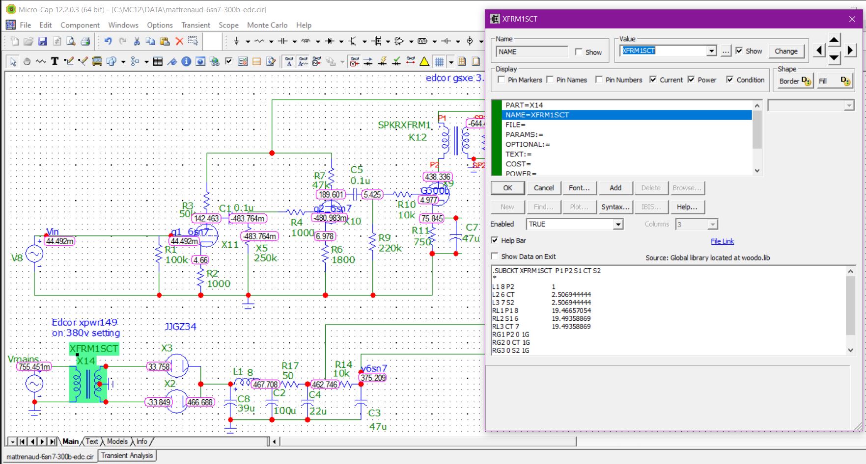

Hi, I used elecalc to come up with the spice model for the edcore xpwr 144 power transformer (240v ac in Australia at 50 hz). I notice you need to input the inductance value of the primary and the default value was 10H. How do you determine this for a transformer. I don't see any value on the Edcor specifications.
I use this in a 5ar4/6sn7/300b valve/tube power amp. modelled B+ voltages are a bit higher than actual about 15%.
The model for the output transformer looks reasonable. I used the gsxe 3500 8 15w model. I didn't use ltspice though, I'm trying to learn microcap and imported the spice model into microcap which seems straightforward enough.
Appreciate any pointers. Thanks for the elecalc, very useful.
