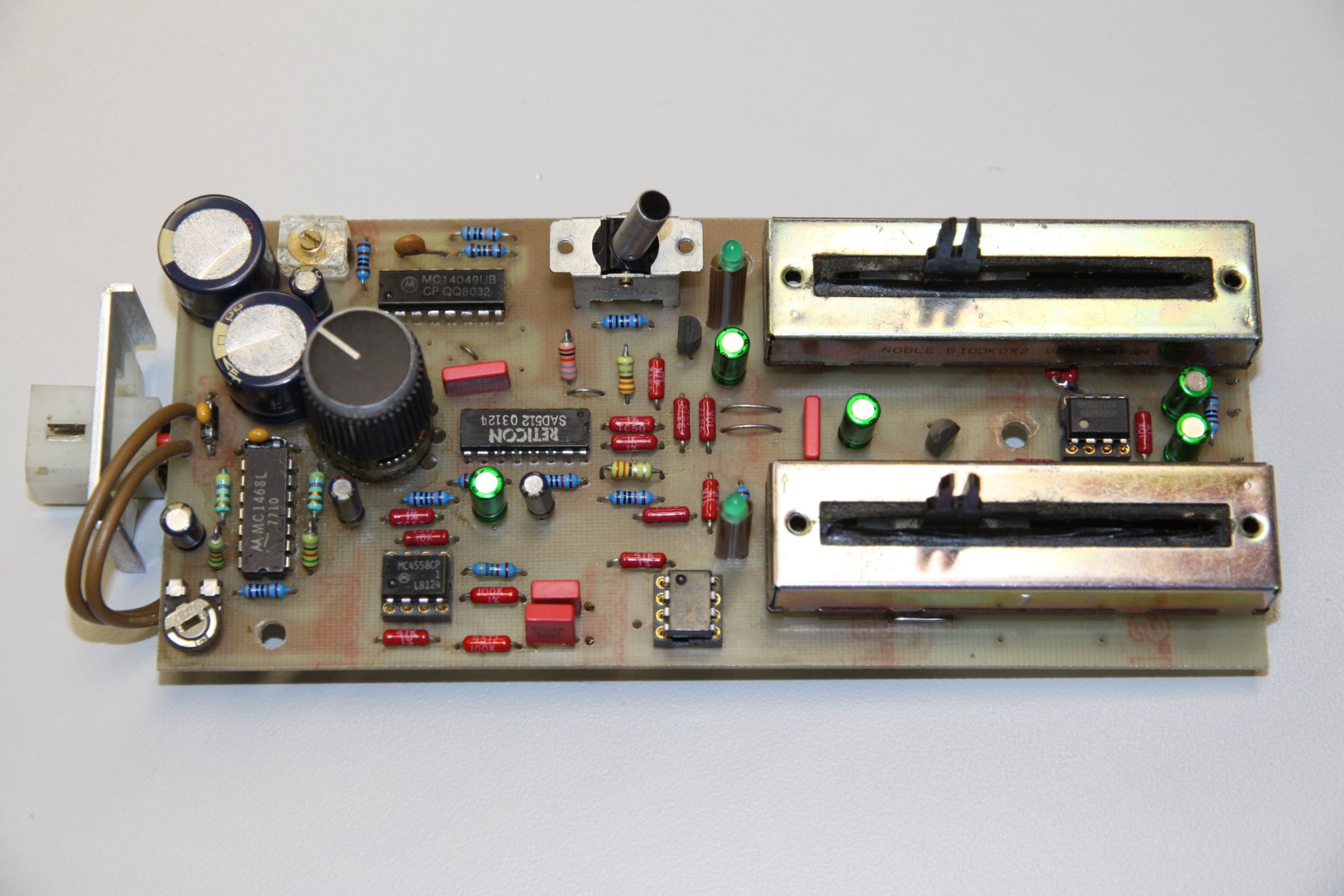

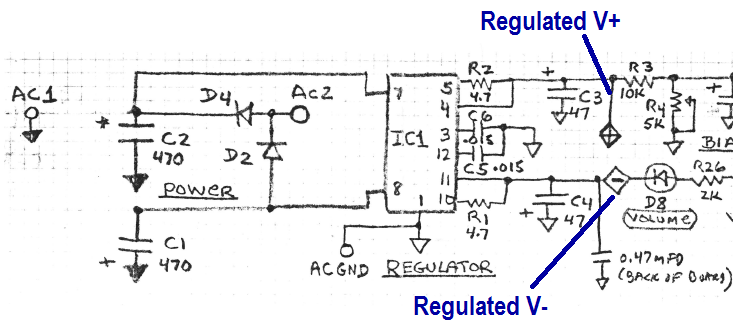

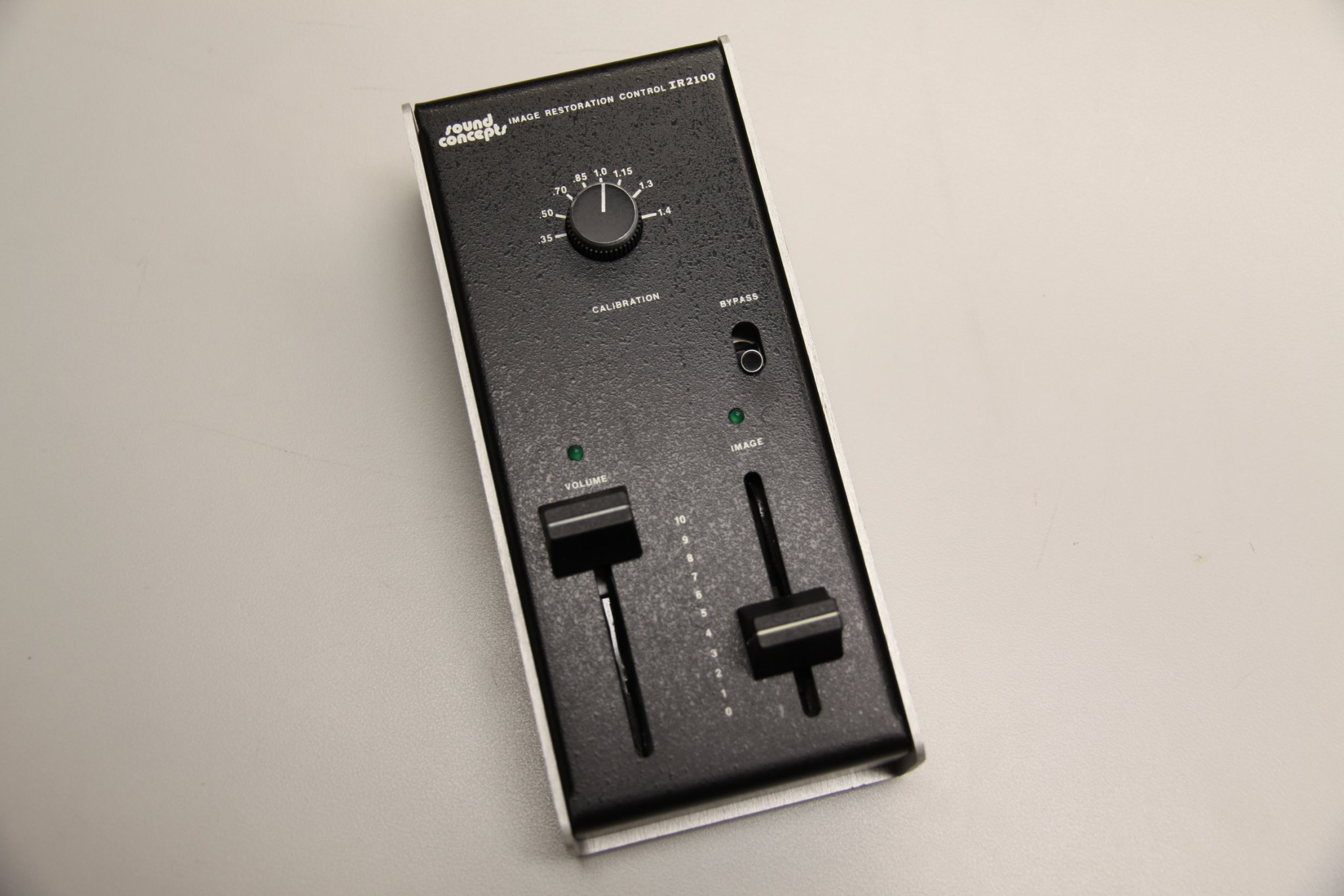

We can start with the Sound Concepts IR2100 Image Restoration Control which was my first foray into crosstalk cancellation. It can still provide stunning results with a wide and deep soundstage provided the source is a well recorded stereo track. The drawbacks are a poor signal-to-noise ratio of barely 80dB which was fine in the day for vinyl LPs and cassette playback. The other is the use of a Bucket Brigade Device where the delayed signals are processed. It is a Reticon SAD512 similar to the SAD1024 used in older guitar effects pedals. Attached is the owners manual with theory of operation and the hand drawn schematic provided to me by Joel Cohen decades ago.
Exterior and internal pictures. Unit shown has had PRP non-magnetic resistors and better caps installed. Won't help the s/n ratio but will improve the clarity. Opamps will be replaced with better sounding ones eventually.

That low-ish 80dB SNR figure is almost certainly due to operation of the bucket-brigade device.

The other processors are not exactly the same type of device as they do not provide a time delayed correction for crosstalk cancellation as far as I know. They are similar in that they all manipulate the stereo difference information (L-R, R-L). The only similar products I am aware of were the JVC BN-5 Biphonic processor and the Carver C-9 Sonic Hologram Generator. The advantage of the IR2100 is that it allows for continuous adjustment of the speaker/listener angle where the C-9 requirement was that one had to sit in a premeasured fixed location while the BN-5 allowed for 3 common settings of 30, 45, and 60 degrees. In my view, the IR2100 produces better results than the Carver or JVC units as it provides the widest and deepest soundstage.I'm curious to read about how you judge your old Sound Concepts IR2100 processor to subjectively compare to your much newer and more sophisticated XTC processors?

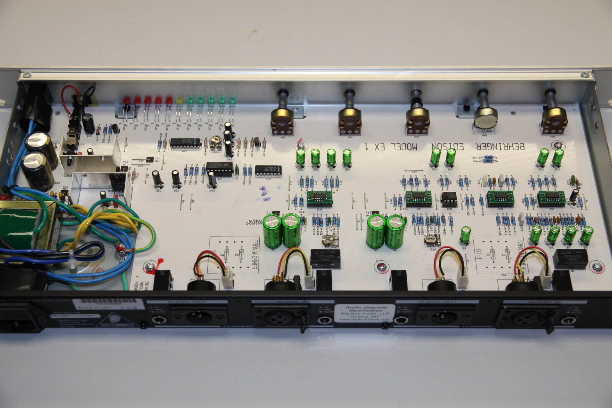

The Behringer Edison EX-1 is an early 1990s unit like the Hughes and SRS. They were made for a number of years but I do not know when they were discontinued. I owned and operated a service center for ADCOM and Parasound along with restoring and upgrading power amps and preamps. We did some processors too like the EX-1 where good improvement can be made simply by using better opamps and better quality caps without installing expensive boutique components.
Beautiful recapping, thank you very much for the nice pic!

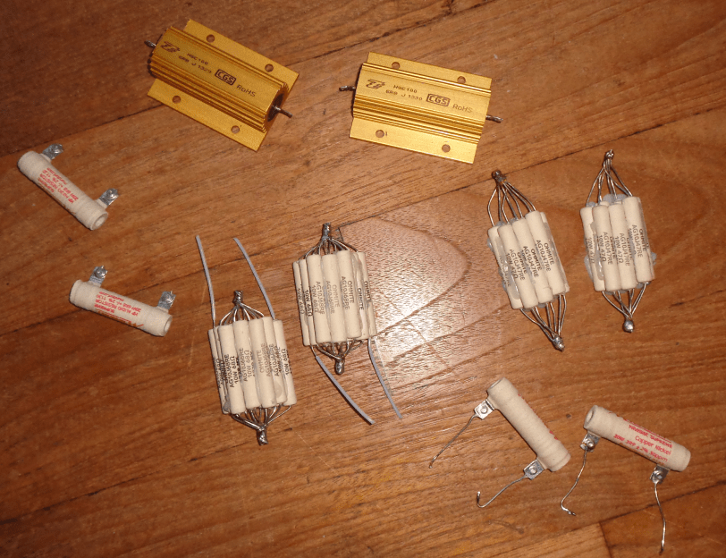

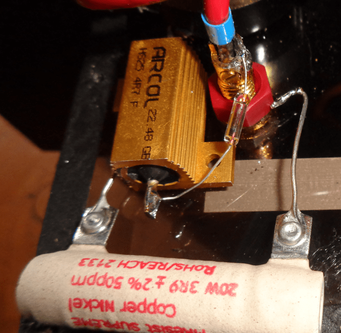

As a matter of fact I've just replaced a resistor Mundorf M-Resist Supreme with an ALCOR Wirewound one in the crossover of my loudspeakers (please note that obviously the Mundorf resistor had already replaced the existing standard resistor. Values are slightly different because the Mundorf M-Resist 4R7 was not available illo tempore) just because I'm convinced that the latter (even if not a "boutique" component) sounded better than Mundorf...

That Arcol is a nice looking resistor. Since it is gold colored it must be better!As a matter of fact I've just replaced a resistor Mundorf M-Resist Supreme with an ALCOR Wirewound one in the crossover of my loudspeakers...

Excellent bigskyaudio, please note that it may (even) be that I'm an idiot - on the other hand no one ever realizes that he is - but even if I'm then I'm not up to that point, trust me (at least once).That Arcol is a nice looking resistor. Since it is gold colored it must be better!
I’ve only done several tests over the years in order to (try to) remove the L-Pads from signal path of my loudspeaker and remembered that Arcol resistors (or related brand, but always of colour GOLD!!!) sounded good.
