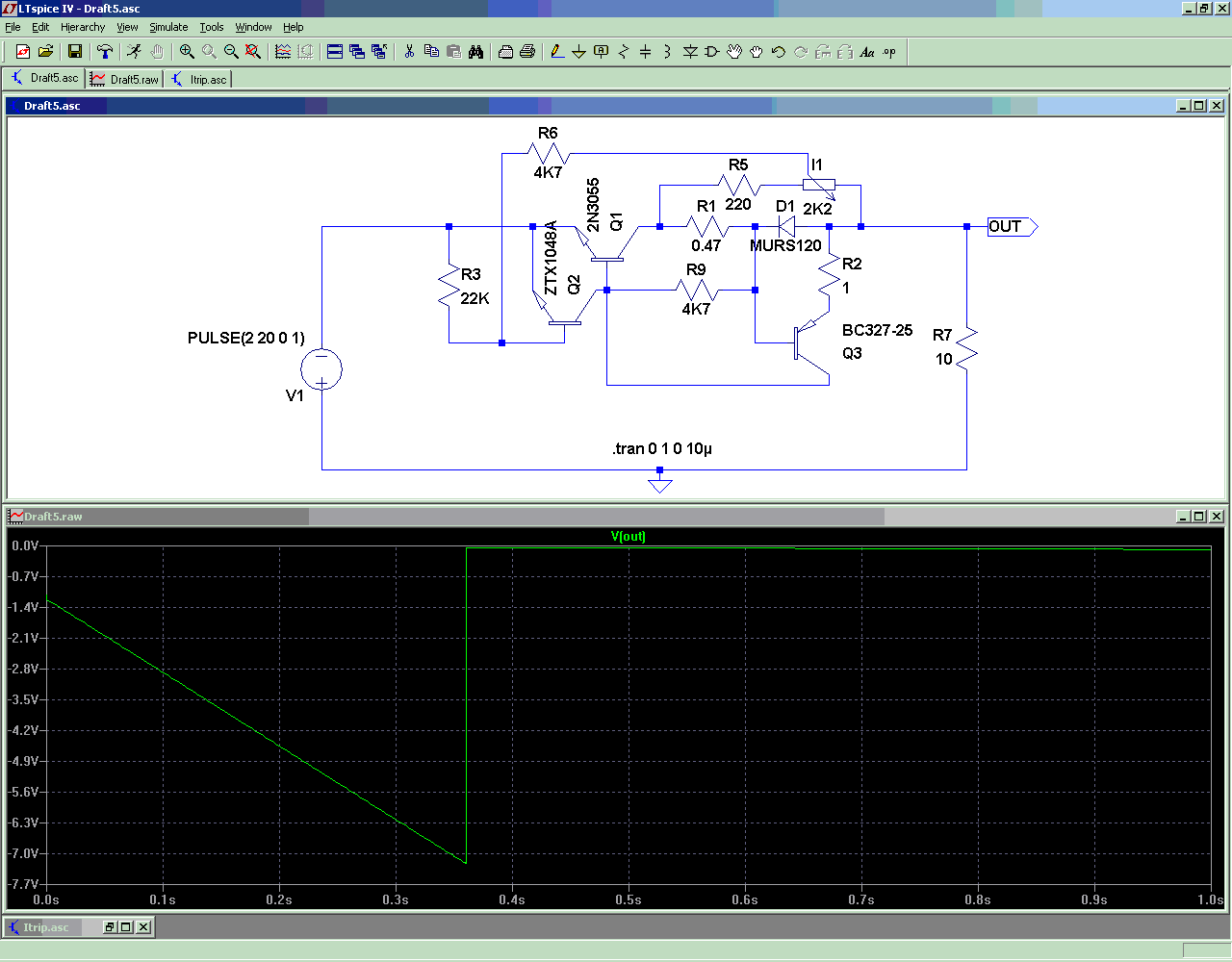

I have tested the second circuit as presented by Elvee in post 38, which uses an additional transistor to sense the output current and block the restarting if an overload condition is still present. Test conditions were 22V at the input with a variable load of 25W. It works as it should. Elvee, thanks again. What a relief, no more fuses to change in experiments.
I have played somewhat with different values of the sense resistor, which sets the maximum current at which the electronic fuse stops passing current. With R-sense = 1 ohm, the maximum current is some over 1A at a load of 25 ohm. I have made two switchable options in my jig: 1.35 ohm with a maximum of 800mA, and 3.5 ohm for about 200mA. This is what I actually measured as shut off current. Elvee, please tell me if I talk non-sense here.
Some points that may require attention:
- Before turn on, or after shut off there is still a small voltage present at the output. At 75 ohm this results in 2,9V at 39mA (In the first circuit this was 1,5V at 19mA). I guess this is of no harm, unless you want to test at very low current. Elvee, what could be the cause of this?
- A nice visual feature to add might be a led when the fuse is ‘refusing’ to pass current, and for the case when an overload condition is still present.
- In post 37 is mentioned it is a two terminal circuit, and the transistors could all have their polarity reversed. Does this mean it is useable in a positive as well as a negative supply without further changes?

Values look consistent. Values could certainly be optimized, as the calculations were in fact quick estimations.I have played somewhat with different values of the sense resistor, which sets the maximum current at which the electronic fuse stops passing current. With R-sense = 1 ohm, the maximum current is some over 1A at a load of 25 ohm. I have made two switchable options in my jig: 1.35 ohm with a maximum of 800mA, and 3.5 ohm for about 200mA. This is what I actually measured as shut off current. Elvee, please tell me if I talk non-sense here.
This is normal: it is caused by the 1K base resistor of the shutdown transistor.Some points that may require attention:
This resistor could be increased, but at the expense of the tripping threshold (it will increase).
It is possible, by wiring an LED in series with a resistor between input and output, but it will also contribute to the off current.- A nice visual feature to add might be a led when the fuse is ‘refusing’ to pass current,
This is extremely difficult: in order for the circuit to "know" there is an overload, it has to sense it by sending the power.and for the case when an overload condition is still present.
Indeed.- In post 37 is mentioned it is a two terminal circuit, and the transistors could all have their polarity reversed. Does this mean it is useable in a positive as well as a negative supply without further changes?
You can build a P version or an N version, and use any of them on either polarity.
The circuit only sees the difference between input and output, and if the polarity of this difference is compatible with the transistors used, it will work.
It is probably preferable to opt for a N version (main transistor): a 2N3055 would do in all cases.
The protection transistor could be a superbeta, ZTX869 or similar: the 1K could be increased to 4K7, or something like that.
If you put the circuit inside a rectifier bridge, it will also work in AC. Some adaptations would be required to cope with the zero-crossings.

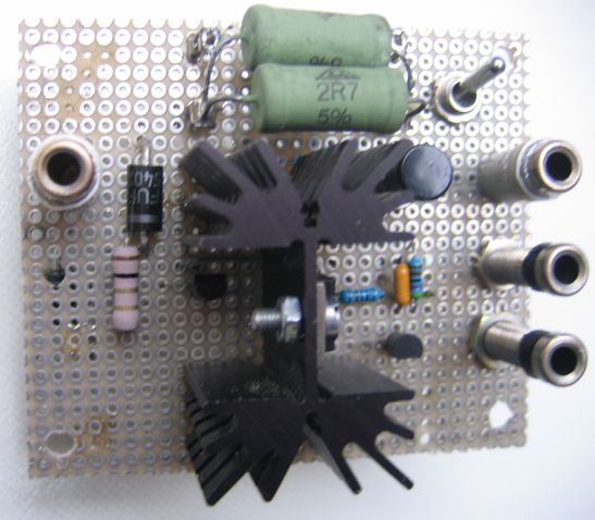

Just for inspiration, I attached a picture of the simple version of the electronic fuse (upper schematic of post 38). The layout measures 6 x 8 cm, and includes a switch to toggle between two sense resistors. Indeed, somewhat bigger that a real fuse, but more versatile and green. In smd the foot print can be much smaller of course. The layout is straight forward. In order to prevent mistakes in direction I added a diode of 3A at the input, and at the output. To the upper right is the input banana chassis part, the left is the output. Disregard the two banana inputs on the lower right, as they are only there for convenience to connect two ground wires and not connected to the fuse.
