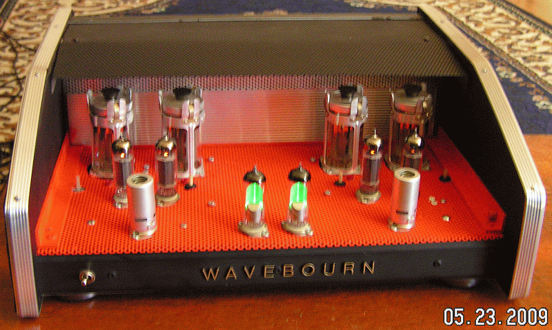

Once again: it is not about "Usual" damping factor. My Pyramids have HIGH damping factor, but despite of LOW THD, WIDE BANDWIDTH, and HIGH DAMPING FACTOR they don't sound like transistor amps. One Pyramid during BAF 2008 festival was used to listen to Hi-fi speakers with crossovers, and nobody heard anything "transistor" in it's sound. Jan Didden when published it's picture called it "Sweet sound of Anatoliy's Russian glassware". SY saw distortion pattern of the amp on the screen of his computer, but he did not see anythging that can "add sweetness". 0.01% of 2'nd order harmonic can't add any "sweetness" to the sound, right? What can add "sweetness", absence of higher order harmonics, and LOWER distortions the LOWER is loudness, and absence of audible phase intermodulation.

Here is the amp that kills the myth about "tube sound is the result of high low order distortions and low damping factor":
http://www.diyaudio.com/forums/club...festival-audio-happening-124.html#post1636391
Nice front panel!
Are you kidding? 😀
Plastic letters glued to cut by scissors peace of aluminum. 🙂
No way. In the photo is looks all metal, like a cast piece.
They don't sell them anymore in Office Depot. The first time I saw such letters on a glass of the window of one doctor's office. I liked them. 😀
