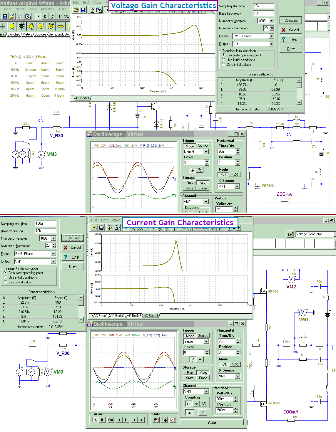

So, you agree that with solid state is better, right?😉 I am able to remove the tubes and get better with solid state with this buffer, see attached. Very good stability and supply ripple rejection.Well, may be tube-only amps reached their limits somewhere, but I design tube amps assisted by solid state devices.
