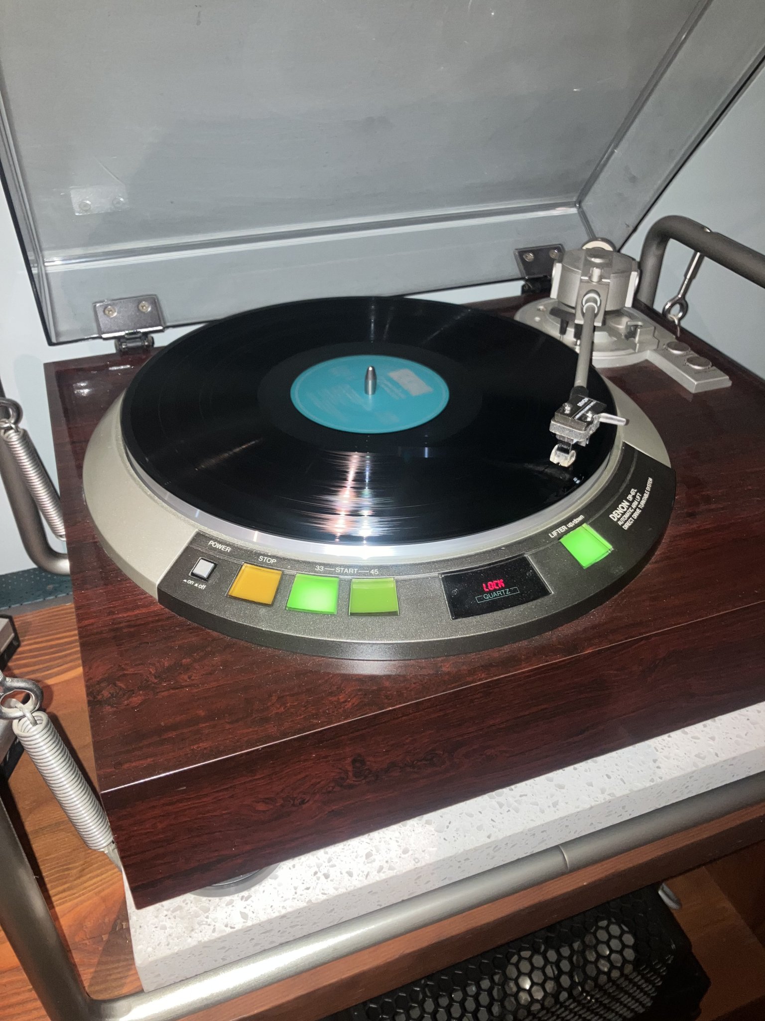

The schematic of the DP-67L shows both lateral and vertical, static and dynamic electronic control of the tonearm.
The steps to adjust vertical forces are as follows - first, with the table powered down, the cartridge mounted on the tonearm and the fine adjustment screw zeroed, adjust a substantial counterweight until the tonearm sits steady, balanced and horizontal. Then turn the power on, lower the stylus (on to a gauge, for instance) and adjust the fine adjustment screw (which positions a smaller counterweight internal to the tonearm assembly) to set the vertical tracking force to (say) 1.4g.
With the tracking force set, apply dynamic damping by setting the “Q-Damping” knob to read 1.4, the same as the vertical tracking force. Internally, “Q-Damping” adjusts one gang of a potentiometer to set the proportion of the voltage generated by the velocity of a vertical sensing coil that is fed back to the input of a small amplifier. That amplifier, in turn, drives a vertical moving coil motor to counter the velocity detected by the vertical sense coil.
The second gang of the “Q-Damping” potentiometer acts in a similar fashion to the first, acting instead on the output of a horizontal sensing coil, which drives a horizontal moving coil motor to counter the lateral velocity detected by the coil.
Another knob labled “Anti-skate” internally adjusts a separate potentiometer to drive the amplifier for the horizontal moving coil motor so that it delivers a static, lateral anti-skating force to the tonearm. As for the “Q-Damping” knob, Denon calibrated the recommended “Anti-skate” setting to read “1.4”, identical to the vertical tracking force of 1.4g.
Denon’s approach to the tonearm and other elements of the turntable are set out in the scan of the Denon turntable catalogue I received in 1986, attached to this post. The catalogue shows Denon’s range of direct drive turntables, along with their various features. It is a snapshot in time and by no means a comprehensive listing of Denon’s many direct drive turntables.
