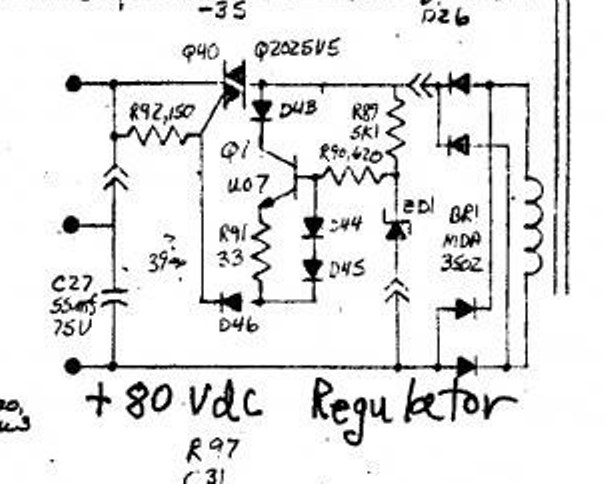

Hi - I purchased an Eagle 7a new back in 1986. It's been a great amp, but by the late 90s the right channel stopped working. I recently got together with an electronics friend and we took a look at it. Besides several cold soldered joints, we found that the bar attached to Q16 had become unsoldered. We resoldered it and checked the voltages. We got 75V for left and 88V for the right. Searching some more we found that zener diode ZD1 has a crack through it. The schematic online here doesn't say, but we're wondering what is the voltage and wattage of the ZD1 zener diode in the power supply so we can get a replacement. Attached is a pic of the subsection of the schematic we're referring to.

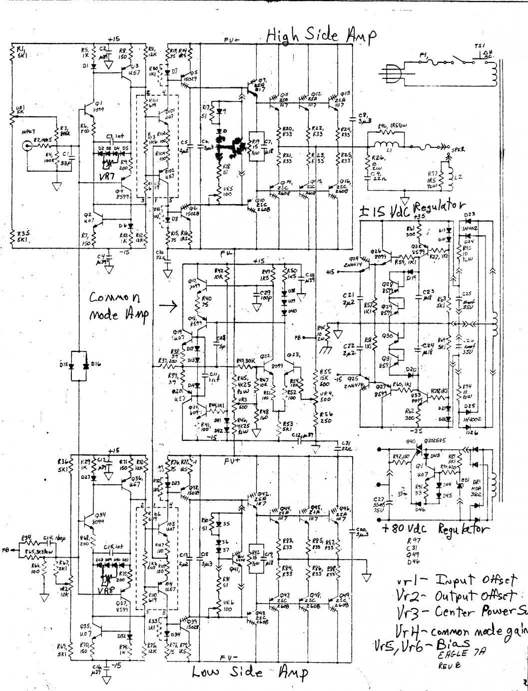

Attached is a schematic which is supposenly for the Eagle7A revision 2.
The Eagle 7A "common mode amplifier" topology is said to provide excellent low bass.
That's all I have. I do not know if the schematic is accurate.
Yes, that's the schematic I'm referring to and extracted my image from. That diode is not labeled with the voltage or wattage in that schematic so I'm looking for something else that may have it listed or specified. The diode is located on the little pcb located near the front right of the amp (when viewed from the front). It's shown in your schematic in the section just above all the text in the lower right corner of the image. Not that it makes a difference, but the schematic has Rev B at the bottom right and my amp's pcb's say Rev D. Thanks
When we started the left channel worked and the right channel was dead. We measured the large FV+ 80V filter caps in the center of the amp. The one for the left channel had 75 volts and the right channel cap had a fraction of a volt.
We traced the problem to a cold solder joint on the bus bar on Q16. After soldering that we had clear audio on the right side (good news!).
We measured the large FV+ 80V filter caps in the center of the amp. The one for the left channel had 75 volts and the one for the right channel read 88 volts (kind of high).
While troubleshooting the power supply I was measuring the zener diode and when I pushed on it with the test probe to measure the voltage the voltage dropped. I did not have extra hands for accurate measurements, but I did see the right filter cap drop to a voltage similar to the left side while pushing on the zener. The zener has a crack through the center, so we know that is bad.
Questions:
What should the voltage be on the large FV+ 80V filter caps in the center of the amp? The Rev B schematic says 80 volts, but our left channel power supply has 75 volts on an amp with Rev D printed on the circuit board.
What wattage and voltage is used for ZD1 on the 80 volt regulator card?
Does anyone have a layout diagram that shows the location of the components with reference to the names on the schematic?
Does anyone have an adjustment procedure for things like bias and offset? I see some notes on the bottom right of the schematic, but I need more details.

Crown used this "theory of operation" in many of their amplifiers. In a "normal" amplifier you have a positive and a negative supply both referenced to ground. In this amplifier there is only one supply with the low side of the amplifier being the reference. Both the high and low sides are the same but run output of phase. When a positive going signal is input the positive output transistors conduct on the high side and the negative output transistors conduct on the low side. Since the output or would be output of the low side is grounded FV-, the negative side of the main supply capacitor, is pulled toward ground leaving FV+ for use by the high side. A negative going signal does just the opposite, FV+ is pulled towards ground leaving FV- for use by the high side.
As far as the bad zener goes there should be another just like it in the other channel. Just measure across it to find the voltage. The wattage can be determined by the physical size. The triac does the regulating, should be open when off, check to be sure it's not shorted. Could be the reason the zener went. According to the Eagle site the regulator was eliminated later on and the power went up due to the higher unregulated voltage.

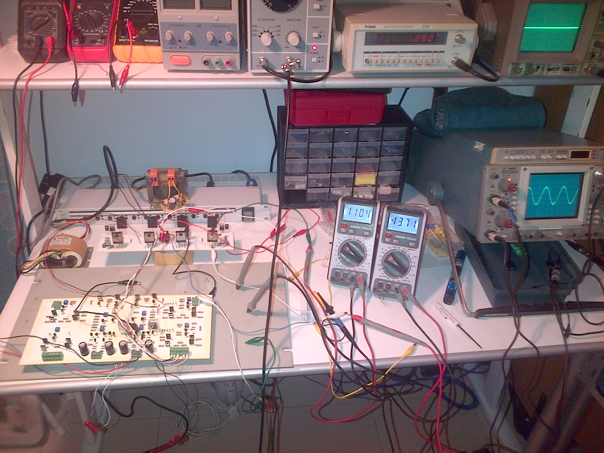

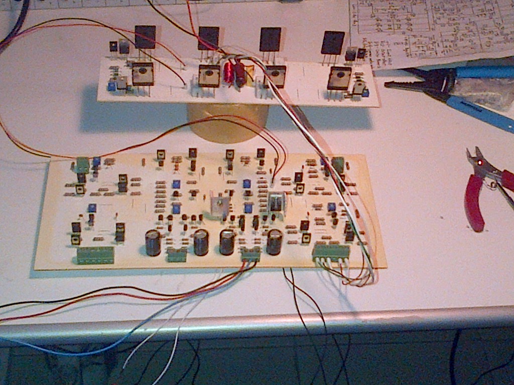

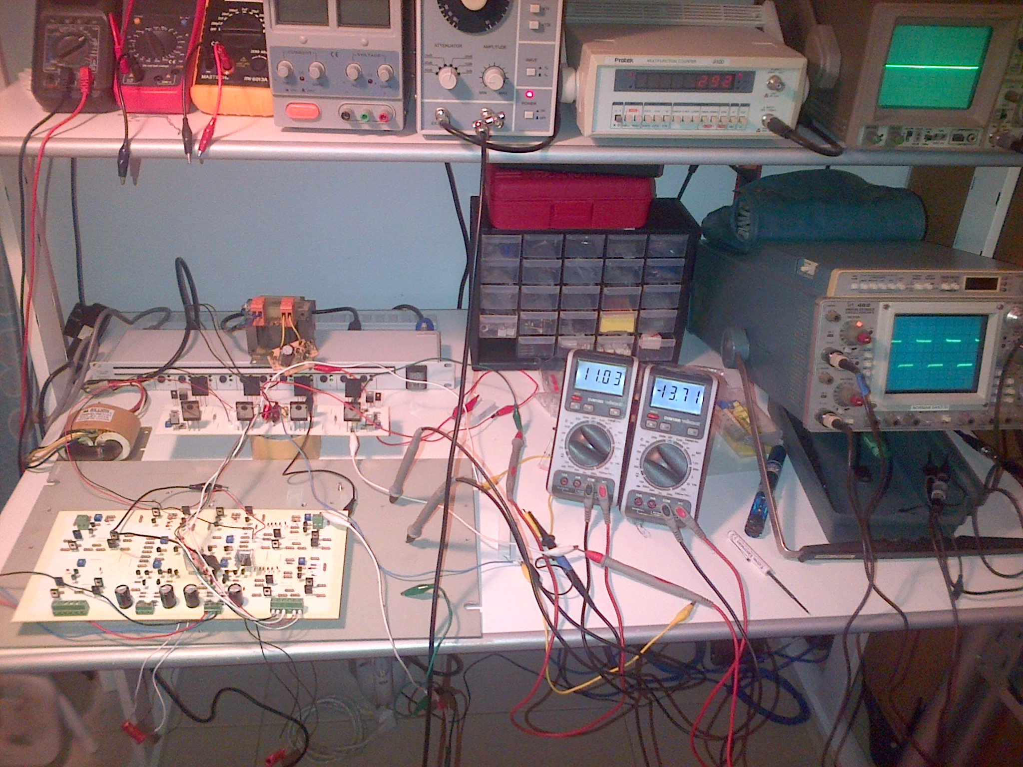

I made diy version of the Eagle 7a based on that schematic above. I did some test at low voltage and seems to work fine.
