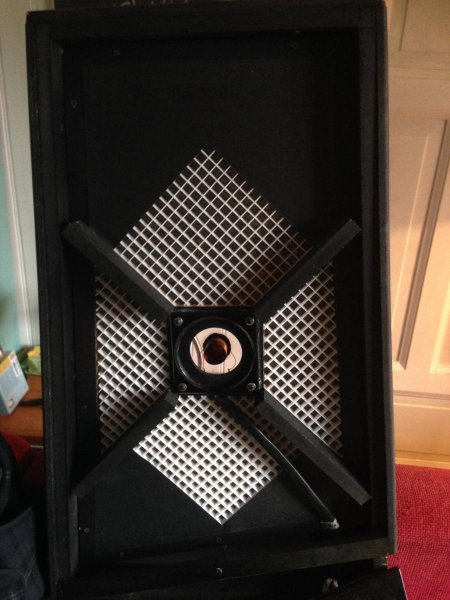

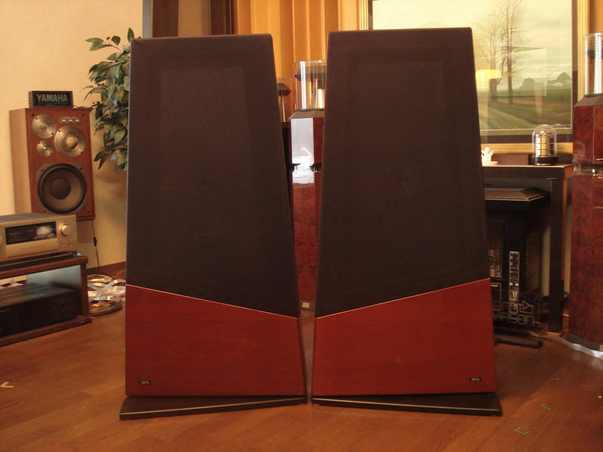

Museatex Melior One sounds similar to what you are describing (but only driven by one coil).
Thanx, that is the one i was thinking of. Made in Calgary. I saw and heard one pair. Promising but they never completely debugged before it failed as a project.
Our member @moray james had a lot to do with its development.
http://www.museatex.com/mel1man.htm
dave
