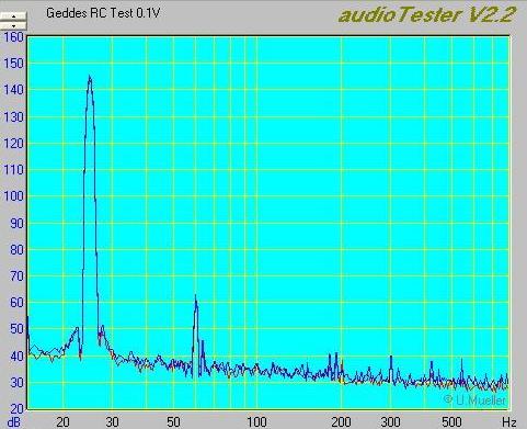

Earl, I played around with your suggested test today. I only had one cap that I could use in the current setup, a 1uF bipolar Radio Shack Bubble Pack Special because of the frequency restrictions.
For the first test, I drove it with about half a volt through a 1k resistor. Signal source was the output of an M-Audio 192 set for 48kHz/24 bit buffered by a BUF03. Test frequency was 25 Hz.
Using my rusty/trusty HP333A, I measured THD. It was below the point where I trust this instrument (0.001%). Looking at the residual on a scope, the distortion seemed to be dominated by third, the noise by 60 Hz pickup. I didn't see any of the blips at zero crossing indicative of crossover.

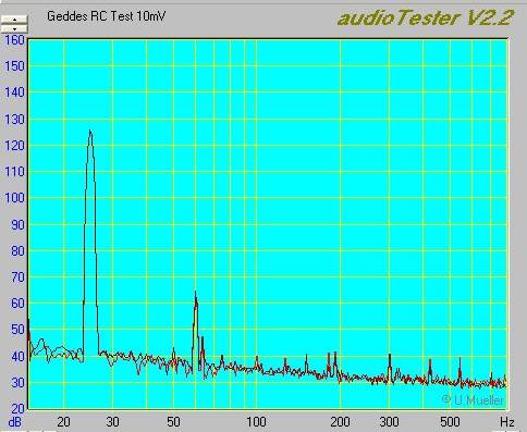

I then ran a spectrum analysis using Audio Tester and the same sound card. Across the cap, there was more 60Hz pickup, but the second and third were not significantly different than the drive signal. One repeatable difference, though, was an overall rise in the baseline starting at about 60 Hz and leveling off about 8dB higher than the input signal (-114dB ref fundamental versus -122dB). I'll try to beat the spectrum into postable shape, but there's nothing like the 0.1% that was speculated about.
Note that there was no input buffer to the sound card in the second experiment, so the residual distortion was somewhat higher.
Earl seemed to feel that small signals would show the crossover effect better. If it's the mechanism he posits, I'd agree with him, that's where you'd see it.
There's plenty of large signal THD data out there. I think Steve Bench might have done some, but I know I've seen it around.
Spectra.
