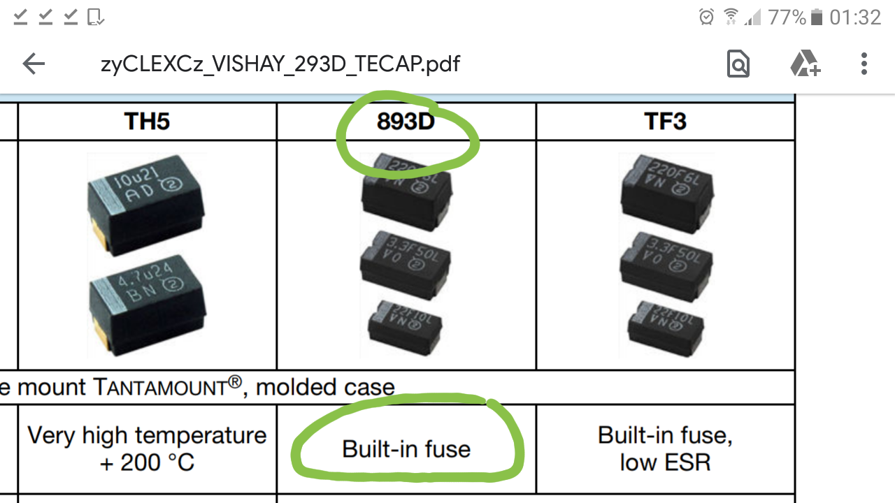

When I worked in design at HP, in the mid 90's, we were only allowed to us fused tantalums, just in case one went in backwards or failed short, kemet still makes them, but I would use a Nichicon UKL instead for audio if you need low leakage.

Good info Monte, I do recall seeing a board severely damaged with a failed tant, burnt a hole right through it. Seen them glow orange too, when put in backwards. Kemet is the only mfg that I know of that makes fused tants and only in smt packages.
