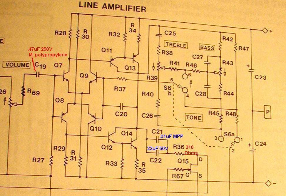

What I am hoping to do is replace an output coupling cap arrangement that consists of a 22uF 50V BiPolar electrolytic bypassed with .01uF 100V MPP.
In case anyone would like to know, it is a DH110 preamp and I am talking about C21 and C22. Schematic at Hafler.com

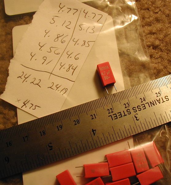

If I parallel 5 of them and stack them on their sides, vertically, they will sit right on the stock circuit board using the space and original holes for the electrolytic.
One thing I have been wondering about is whether I could go with a smaller uF value when switching the electro to film. To tell the truth, I am looking to pick up a little in the bass floor, so I thought the 5 4.7uF caps at about 23.5uF would be a good replacement for the 22uF electro.
My two 5 cap groups have been selected with a precision cap meter to have matched sums of 24.22 and 24.19 uF - closest I could get.

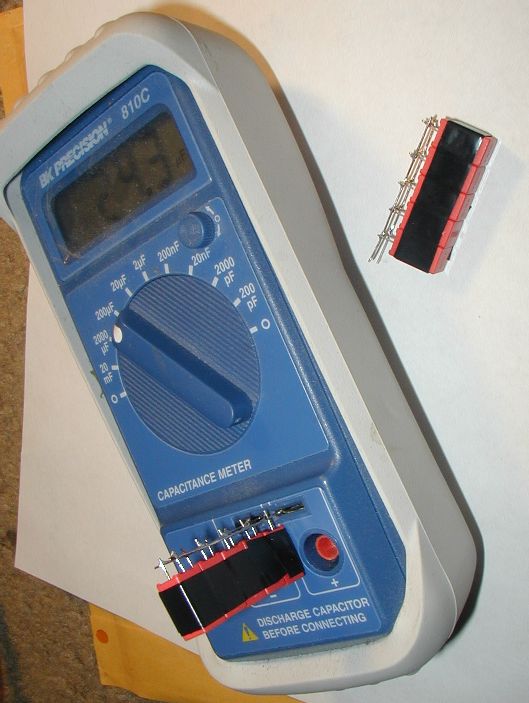

As usual this project has run late (1 AM by me) because of unscheduled interruptions and humbug.
I have finished my 'supercaps' and am attaching a pic. For anyone that noticed, I did match the caps closer by flipping a couple -- 24.2 and 24.21.
Once finished they tested 23.3 each on a lower resolution scale.

Here is the DH110 schematic link:
DH110 schematic
To Keith:
My amp is direct coupled. No input cap whatsoever. It is a Hafler XL280, and is in fine working order. Am I gathering correctly that the output caps on the preamp are mainly to block DC from backing up into the preamp and thus largely unnecessary in this situation?
I don't plan on eliminating the output caps, just finessing them so to speak.
I don't know if anyone will be able to make it out, but I will attach a lowres pic of the caps in the circuit...

The schematic picture is clear. Hopefully some of the guys can make suggestions to some of the values of the different caps and resistors for best sonic results.

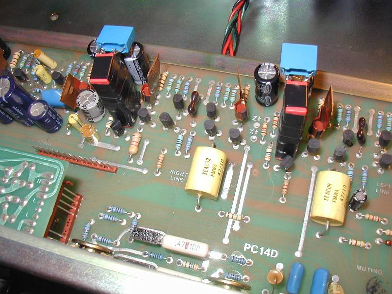

Listening tests: Electrolytic vs Polyester
Man!!!!!! that cat has a face for radio!!!!!
You bet. 🙂 Kitty was a one-eyed love machine that added to my understanding of life. May she rest in peace. :angel:
Listening Tests
First off, I think it is important to detail what standards I am testing against. I am testing against almost 18 years of uninterrupted, unmodded listening on this system.
I am using old and new source material that is familiar to me on my stock original system.
I did not 'burn-in' any of the caps before testing.
Configuration #1 -
Original config from Hafler =
50V 22uF BiPolar IllinoisCapacitor brand circa '86 bypassed with a rolled, .01uF 100V M. Polypropylene (SEACOR, I think).
Let us call this the reference standard.
Configuration #2 -
50V 22uF XICON NPRL series w/original bypasses.
I listened to these for quite awhile. The sound could be described as neutral compared to the IC caps. The bass was not as pronounced, but there was a nice, clean quality to the high end. Not as dynamic because of the slightly reduced bass, and lacking the 3D image of the original caps.
Still, I found these caps listenable.
Configuration # 3 -
(5) 4.7uF (24.2uF) 50V WIMA MKS2 in parallel with no bypass.
These are the 'supercaps' in the pics. I wanted to like this. It just seemed cool to go from electrolytic to all film across the signal path.
But...
I noticed a 'flatness' to the sound almost immediately. Disappointed, I listened to quite a few tunes, but there was a most peculiar trait - instead of depth, things in the rear of the soundstage simply sounded quiet not further away.

Configuration #4 -
Above config bypassed with .1uF 160V EPCOS MPP
Little change from the above. Disappointing.
Configuration #5 -
(4) 4.7uF (about 19.6uF) 50V WIMA MKS2 in parallel w/ no bypass.
Just clipped off the top cap and it's epcos bypass for this arrangement...
Better. A more open top end... but still no bass. I tolerated this arrangement for a night of listening, but I eventually began to get that yearn to hear that special something that only audiophiles understand.
So...
After all of the above listening tests were concluded over a couple months (mostly with the XICONs), I soldered the original IC caps back in along with their original bypasses. Beautiful, original stock - I even installed them to original channels and facing the original polarity.
WOW. It's almost sad. There is no comparison, it's like my system has come alive again. So much soundstage, so much bass, and ooooh so real.
All I can say is I feel extraordinarily priveleged to have owned this preamp in it's factory original condition. I have replaced the PS caps, but there is no comparison, the coupling caps at the output make all the difference. I noticed changes with the PS caps, but without the original IC coupling caps, this pre was dead in the water either way.
So, I guess it just goes to show that there are an amazing number of variables here - all of which can affect the sound.
I doubt I can ever best the original caps, so I sure hope they last a good long time.
