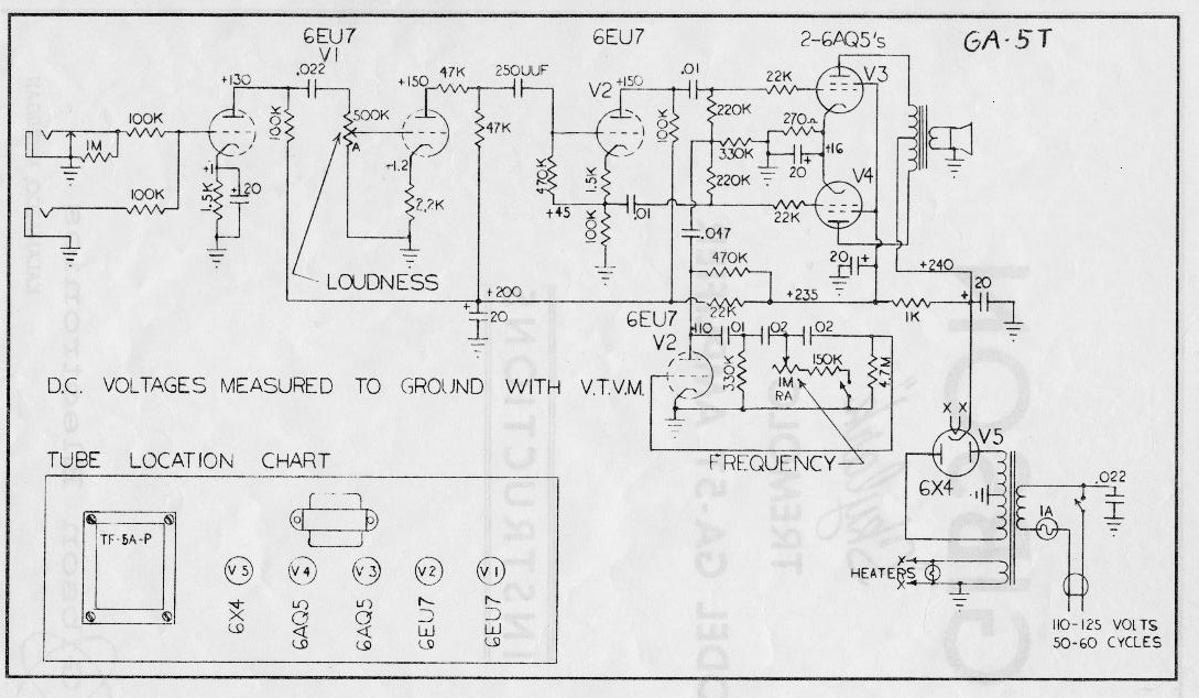

update but need more info on gibson ga5t
after replacing the electrolytic multi-cap with three separate new electrolytics, the gibson ga5t is quieter but still has the "spikey" sound that i was trying to eliminate. it appears to be coming from the tremolo circuitry. when i strike the guitar strings rather hard it emits a "spikey" sound through the speaker as if too much currency is flowing through.
here is the schematic for it. i believe i either need to change the .047 cap or the three small ones attached to the tremolo frequency pot (or all four).
any suggestions?

The three filters eliminate hum and decouple the preamp, they are not the suspects for spikey. The caps in the trem circuit determine how fast the trem goes, and are not suspects in spikey.
Spikey is a frequency response thing. Try playing the amp through different speakers just to see. Well, to hear, really.
See that 250uuf cap between V1 and V2, top center? Try increasing that to 0.001uf or something. Just tack a larger cap in parallel with the 250 if convenient.

enzo: yes, i not only swapped out the 6eu7 tubes but i ran it through a different speaker and it did the same thing.
sounds like it may be worthwhile to change out all of the caps. or, is this one of those, if it ain't broken, don't fix it?

Try just increasing that one cap I mentioned.
