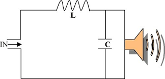

Your drawing is close but not quite right. However, it is quite tricky to translate what's on the crossover board onto paper. You show the capacitors in parallel with each other, in which case they should be in series with the midrange. I may post my version later for your future reference.
It doesn't matter though, just replace each capacitor with another of the same value.
Capacitors for mid range is not in series like it is on tweeter where cap is in series to speaker...dunno why
I've checked out the crossover board connections.
The two capacitors are in parallel with the midrange and the inductor is in series with the combination.
This arrangement gives a steep low pass (high cut) filter on the midrange - see attached diagram.

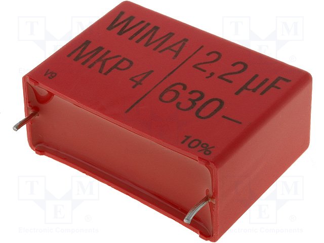

Does it have to be specific audio MKP capacitor for the tweeter or any polypropylene MKP capacitors will do like for example filtering capacitors?:)
Doesn't necessarily have to be audio specific. Choose one which will best fit your crossover board in terms of physical size and lead spacing.
The higher the voltage rating the better. I've had good results with WIMA polypropylenes like the one shown below.
This arrangement gives a steep low pass (high cut) filter on the midrange.
Also what i found strange is that if crossover uses second order with 12.2uF cap on midrange with inductor the midrange driver gets high freq cut off at like 1150Hz
and if crossover uses first order for tweeter with 4.7uF cap - tweeter gets low freq cut off at like 4200Hz
so when question is where is the remaining 1150Hz-4200Hz frequency gone or i dont understand something here and make stupid questions :confused::confused:

Your interpretation of the crossover circuits is correct. I wouldn't worry about the exact value of the inductor.
It would appear that the midrange starts to droop around 1.2kHz and the tweeter comes in below 4.2kHz. (Remember that the filters act on the drivers gradually and not exactly at the frequencies you have calculated.) The two drivers will overlap for a while.
The output of the midrange cone will begin to fall away, leaving the job of reproducing the higher frequencies to the tweeter cone.
