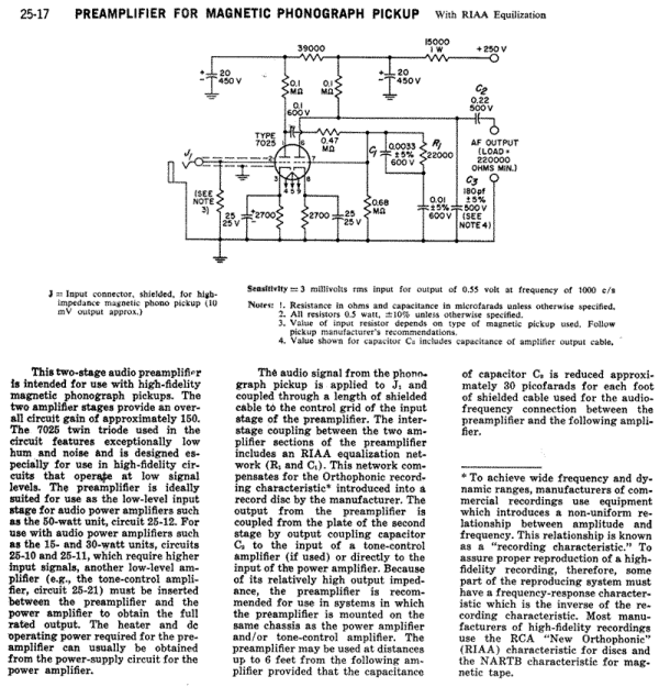

The difference between a 12AX7 and a 7025 lies in the construction of the heater. The 'X7 heater is folded, while the 7025 heater is spiral wound and hum bucking. The stock of either variant needs culling out of "phono grade" specimens. Where a 7025 or equivalent, like the Sovtek 12AX7LPS, always provides a benefit is when the tube is AC heated.
RCA's original passive EQ phono preamp specifies 7025s, as AC heating was allowed for. Back when the design came out, a DC heater supply was truly a royal PITA. It is possible to obtain acceptable residual hum levels in an AC heated phono section, but it is LOTS of work.

So if I’m following this correctly, a 7025 is a 12AX7 with a spiral wound filament. Which means the Sovtek 12AX7LPS (LPS = Long Plate, Spiral wound filament) is a 7025, or does a 7025 always have a spiral wound filament and a short plate?
One way to say it is that type 7025 is a designation that RCA gave to their own special version of type 12AX7. Today it can mean anything the builder wants it to mean. In American manufacturers parlance, four numerical digit valves were often the "industrial" and "special series" versions of commercial types.
