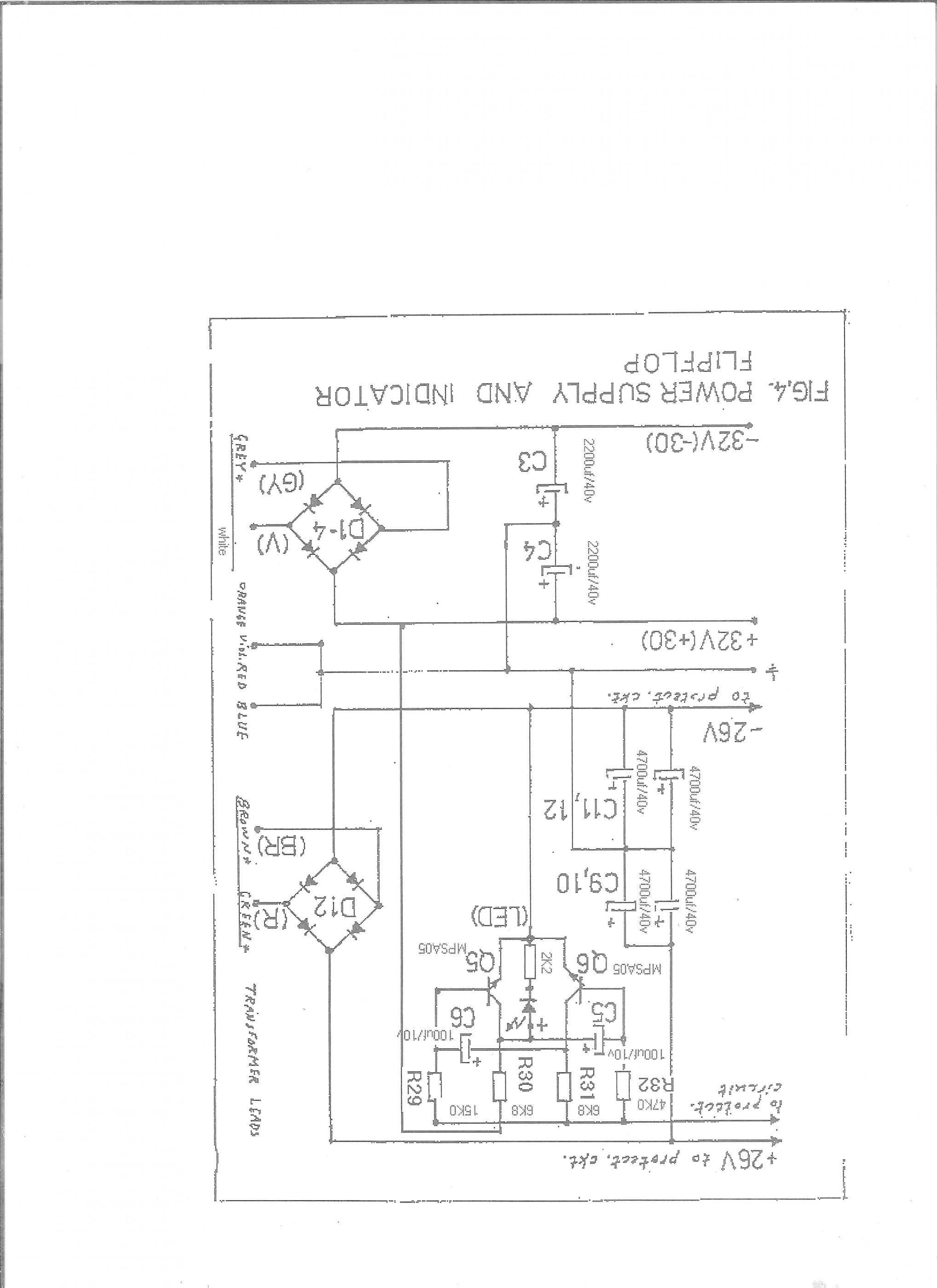

I had myself thought about the noise along the power tracks I will now revise the layout.
The layout is almost identical to my original board except the revised board is now double side and the track have been increased, also I have changed over the axial capacitors to radial ones.
The connections to the bottom left and right corners of the psu board are the power supply protection circuit that are fed from the emitters of the amplifiers output transistors the top right hand corner is a bistable that feed the relay to break the supply rails.

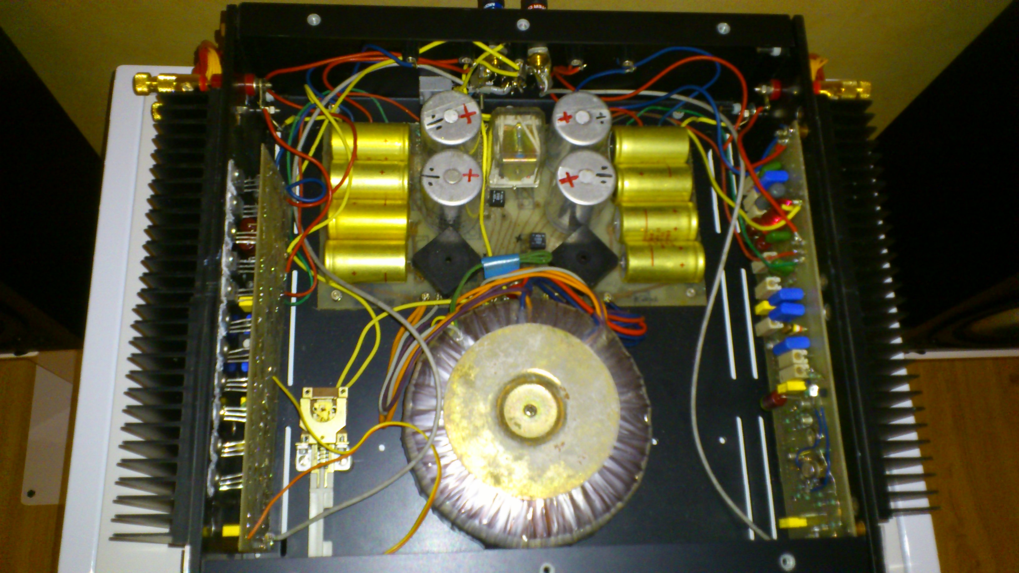

The symptoms you describe are consistent with something that has run too hot all its life and is now getting a bit past it. 😉
The loud pops and massive DC offsets are caused by some component that has an intermittent connection. It either goes open or short, and throws the whole circuit out of balance.
The usual kinds of loose connections can be "cured" by whacking the unit (I'm sure you've tried this 🙄 ) but I've seen transistors that go open circuit when they get hot, and these don't respond to hitting, which is one way of identifying them. Last one I saw was in a Mission Cyrus something or other. As far as I know it's caused by the transistor running too hot for a long period of time.
I expect most of the components in the amps will have been made somewhat unreliable by heat, as well as the PCBs like another poster suggested. From the photos you posted, the innards look a bit brown and crispy. A really good repair job would be a rebuild from scratch with new components, which isn't that far off just installing the Velleman amp boards.

Has anyone got any info on the protection circuit?
Mine has died and the power goes to both PCBs, The 48V relay simply no longer goes on? All six 100uf caps gone a bit high, repalced them and all the transistors test ok. even the relay driver one tests ok.
all resistors Ok, even with the power PCB's not connected the relay still will not operate but with no circuit that may be normal for this thing
No evidence of burning out, anywhere, any got a circuit of the power supply/protection PCB

Did anyone have any Power Supply details on this?

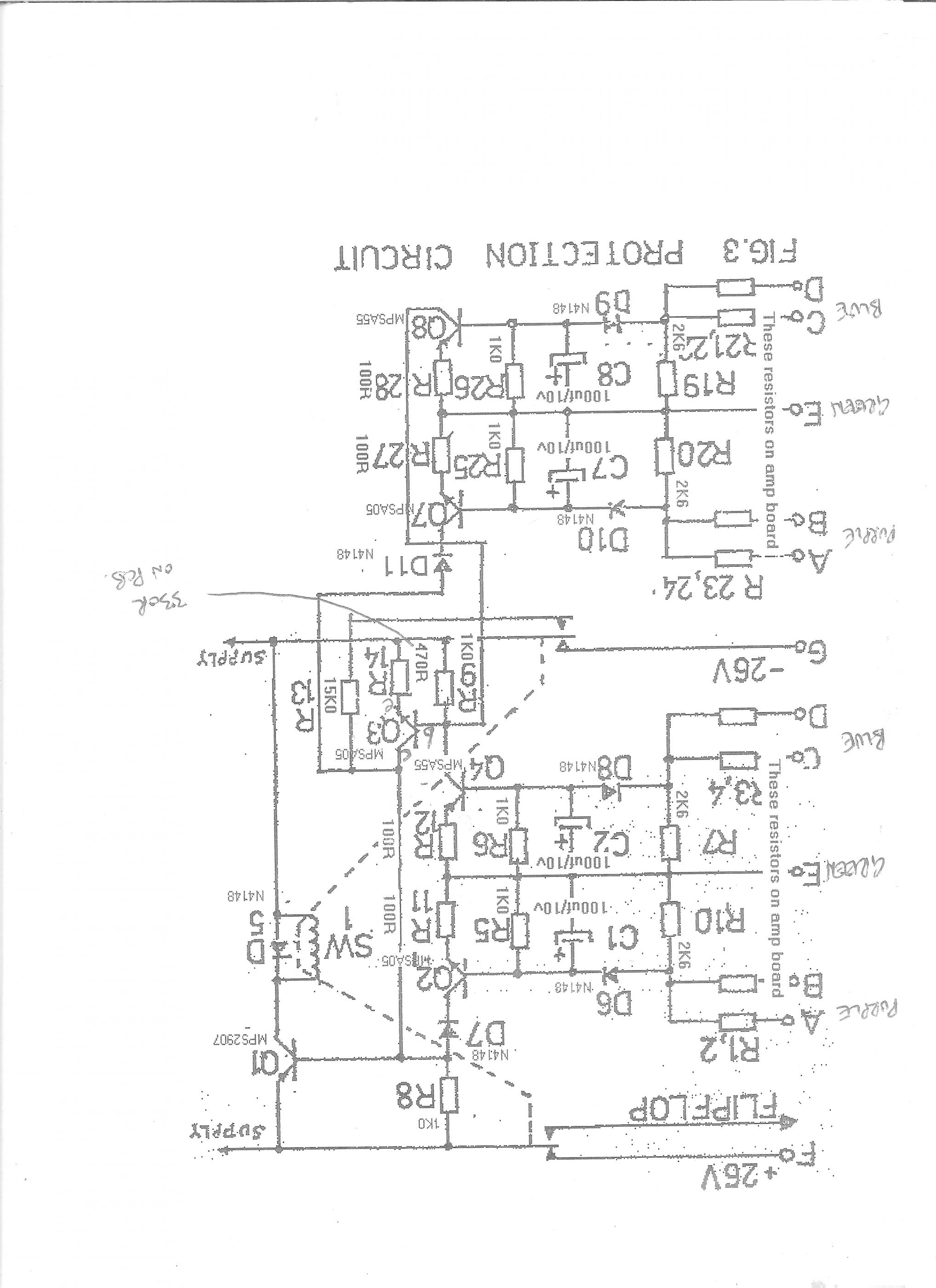

I have one to fix. It all works but the Relay never clicks. Does it use the Normall Closed contacts and 'Open' the connections if a fault is detected?
A schematic would be appreciated.

Relay does indeed open under fault.
To check operation disconnect amp boards and ground sensor marked E. Then touch sensor A(B) to +26 volt line. Or C(D) to -26volt line. Relay should then trigger.
Many thanks Tony. It makes sense when you can see the circuit.

Electro 25watt
Sorry never did get the factory recommendation.
I generally set for max 500mv across the resistor or test points. But this is pretty well max. Achilles heel of this amp is heat and the poor way the transistors are mounted close together so heat cannot be dissipated. For peace of mind perhaps you should set a little below that figure and use the back of your hand on the heatsinks as a guide.
