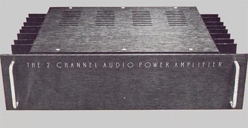

Schematic Electrocompaniet 25W designed by Lostroh and Mati Otala
is this the schematic of the showed amp front from the picture?

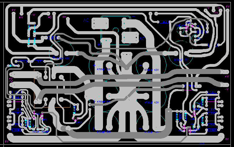

I have just finished the revised pcb's for my Electrocompaniet 25 watt class A.
Track sizes have been increased with much of the work done to revise the psu board to allow radial capacitors to be fitted.
Hello msdin,
I do not know how the tracks looked like on the original pcb but the pcb PSU you posted sure needs some corrections. Connections should never be make along a track that connects a diode bridge to a large filter capacitor. This track is extremely noisy because the high currrent pulses needed to charge the capacitors go through it. Only make a connection to this supply line, after the capacitor. This rule applies to ground tracks too! You have to be extremely careful with those tracks if you do not want to end up with hum, as it happened with some of my earlier designs.
I could not deduce all the external connections going to the pcb but since I was sure of some of them, just for fun, I redrew part of the design to show you some of the corrections, but not all, I would make.
