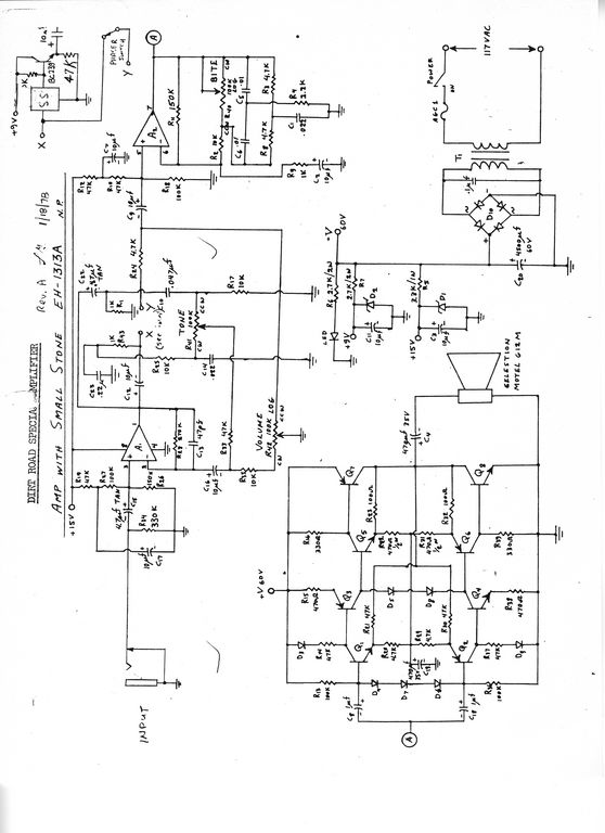

Got a reply from Alan Otto at E-H. Attached is a copy, smallish, of the Dirt Roads Special. Looks to be fairly straight-forward in design. Let me know what you think and offer any suggestions to improve it. Thx again, Thom.

Hey I'm trying to make a clone of the Mike Marshall Freedom Amp, which is similar to the Dirt Road Special, but I'm having trouble finding a transformer that would be compatible with it. Looking at the schematic above, the output stage requires +60V DC. Could someone recommend me a transformer that would do the trick. I'm laying out a board now and look forward to sharing it with you, once it's build and tested. I would really appreciate your help.
