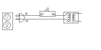

This probably isn't as complicated as some people seem to think. From your picture of the switch, you are shorting out the mains. When your switch is in one position(what you were using for "ON"), The 2 terminals of the switch were not connected to each other. So it was acting as though it was not in the circuit at all. Since you had one side of the transformer and one side of the mains going to each terminal, everything was hooked up and working. When you flipped the switch, you were essentially connecting all 4 wires. What was causing the fuse to blow was that the 2 wires from the mains(hot and neutral) were being connected together. If you remember ohm's law (V/R = I) you had 120 volts divided by 0 ohms equals infinite current. Infinity is much bigger than your 15 amp fuse... POOF!
I will draw a pic of how you should hook it up
H is HOT (usually black wire)
N is Neutral (usually white)
BE CAREFUL!!! you could fry your equipment AND yourself!!!

Ok, from an electrical and safety point of view, ALL mains switches should be double pole, from the basic point of view that sometimes you can have incorrectly wired mains leads or even wall outlets, and this could lead to a circuit being live when you think it is dead!!!

Thanks for all the help guys!! I went to the electrical shop this morning and the sales guys appologized because he realized his mistake after I had left. He gave me the proper switch and replaced all the fuzes I had blowen at no charge! They will definately be getting my future business. Everything works great now and I should have some pics for the board in a few days.

I'll see if I can explain. The first switch I got is pcitured in an earlier post and was incorrect because it only had two points for connecting the wires. The new switch looks exactly like the other one except on BOTH sides. That is to say that there are four points to connect your wires. I hope this helps....I'll post a pic when I have some free time.

No the trouble wasn't the switch being parallel to the mains it was an issue of voltage feeding back after the circuit was broken. I think maybe his drawing was badly done. A double pole switch was obtained, the project rewired to isolate the mains on both sides (hot and cold) and the feedback condition dissapeared.

I dunno... I reccon he did have it wired parallel.... I don't see how else his diagram could be interpreted, nomatter how badly drawn....... AND!!!
He was connecting it in parallel...... The voltage feeding back after the curcuit was broken (whatever that means) would not cause a 10-15amp fuse to blow....

Ah well it's all conjecture on our part at this point, if bitbyter did cross the mains with his switch it's corrected now. And thats the important part. Also it's been confirmed by a journeyman electrician that any circuit like this needs to be switched with a double pole switch so that the mains is "completely isolated" when switched off.

I believe that I had it wired correctly because the guy at the shop confirmed what Zardoz has stated above. Now that I have the correct switch everthing works fine....
