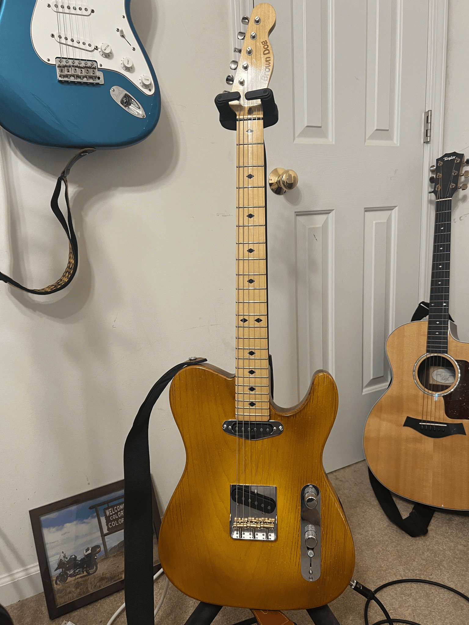

String up the guitar and at least do a rough setup - neck relief, action...... Then measure the distance from the bottom of both E strings to the bottom of each pickup rout. With this information you can calculate the range of clearances from the top of the poles to the bottom of the strings. Generally the thicker strings will be further away from the pickups than the thinner strings. Fore and aft the pickups should be parallel to the strings. On this Tele I just finished building the low E is ~⅛" and the high E is ~1/16" below the pole. Be sure to leave room to adjust either way.
