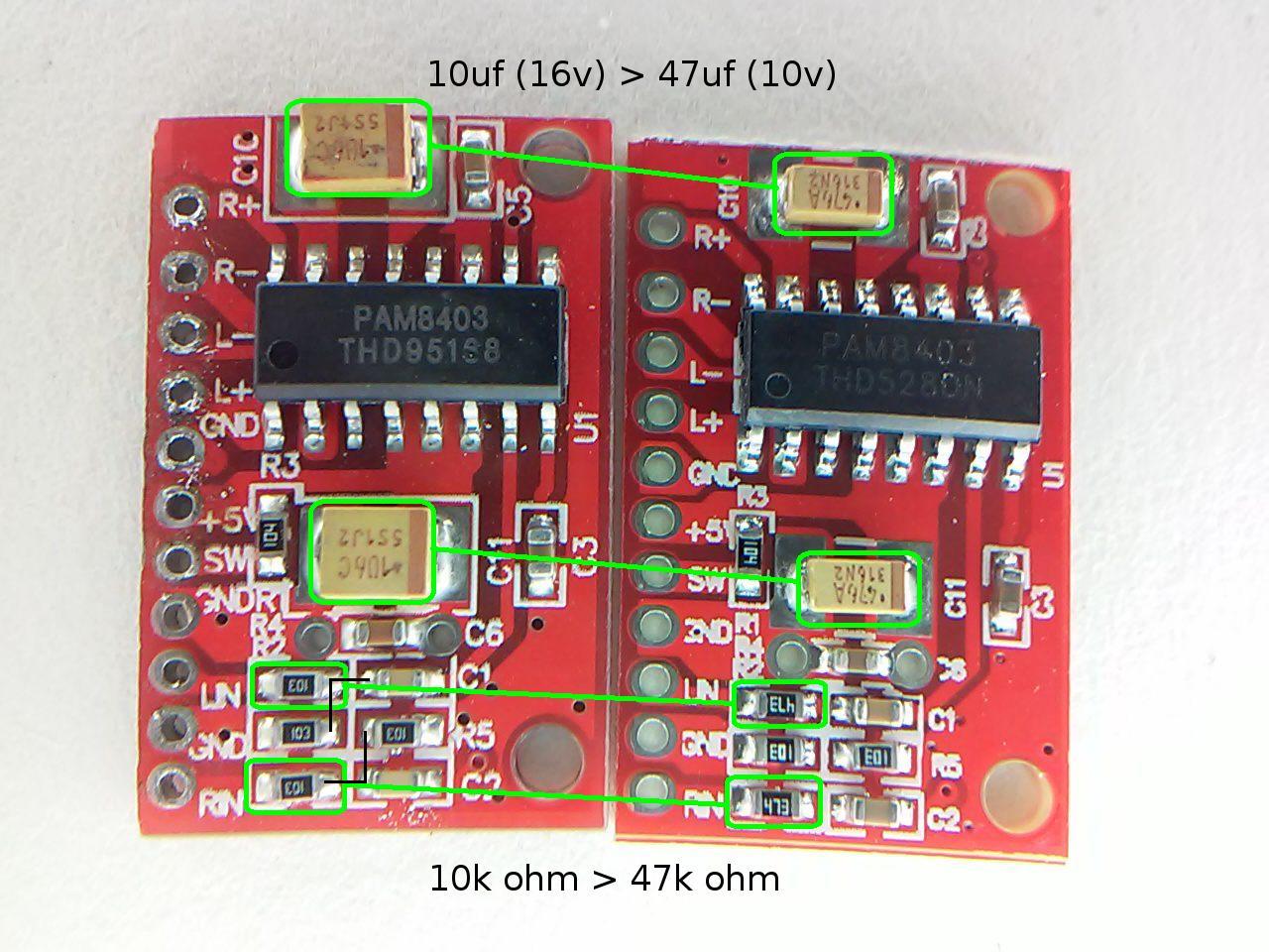

I have a little PAM8403 amplifier, that looks like this:
776155d1566156522-additional-capacitor-added-pam8403-audio-amplifier-board-pam8403-audio-amplifier-board-02-jpg
and I was wondering if it would work to build a simple headphone amplifier for an electric bass guitar (my inspiration is the Vox amPlug headphone amp). Does anybody have any experience in this direction?

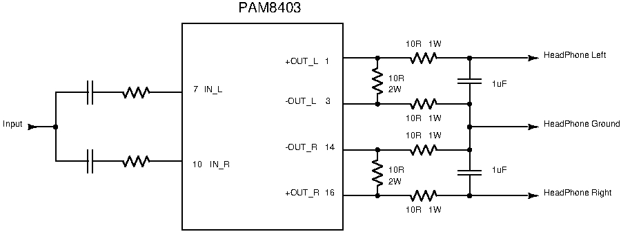

I haven't tried it but I am convinced it can be done.
BUT, PAM8403 is designed to work in a speaker load. Therefore, give it an 8-10 Ohm (2-5W) load on each output in parallel with the headphone load. Also, the PAM8403 uses no output filter as it relies on the inductance in the speaker cable and the inertia of a speaker membrane.
You only have a very light headphone membrane and a very short headphone cable. After the 8-10 Ohm resistor, connect a 8-10 Ohm resistor (1W) to each output terminal and a 1uF capacitor (preferably foil) between the two other resistor ends. That will form a carrier frequency filter.
If you are interested I can draw a sketch. I have to cook dinner first. :fim:

Thank you for your answer, FauxFrench! Yes, a sketch would be very much appreciated, thanks! (Of course after you had dinner, bon appetit!)
I also have another question, regarding the volume control. I saw that a simple way to control the volume is to put a potentiometer on the input. But how do I choose the right resistance? I have some 25k pots lying around, would they do the job?

As i hear the first time from this tiny chip i search around here and note some links:
What is this additional capacitor added to PAM8403 Audio Amplifier Board for?
PAM8406 (and PAM8403)
comment here that fit to the pic :
As far as I remember, I had to change the input resistors on my $0.50 PAM boards as well to 47k to get the gain down. 10k is "asian standard". This also brought "noise" down. I use them without permanent supply but with 2x 25F supercaps in series, so having 12.5F with an ESR of ~70mR at 5V.

Thank you for the links, chermann, they are interesting. So it looks like it's a good idea to add a 470uF capacitor to C7 (or C8), right? Sorry if I ask for confirmation, but I am a newbie of the amp-making art, so I am really not sure about anything right now :).
Hi Francesco
i do not have that chip so i have no experience with it. but yes..you should use your caps....as a look in the datasheet shows the recommendation by the manufacturer pin4 + pin13 PVDD 1x470µF + 2x 1µF for decoupling.
maximum supply voltage 6V!! - so keep around 5V and the chip is ok.
in figure 2 in the datasheet you see that ferrite beads what FF is mentioned.
chris
I came to the below circuit. Mono evidently.
The components to the left should already be on the board. The components to the right are added to the board terminals.
I suggest a simple RC output filter because you avoid resonance issues and you have more-than-enough power from a PAM8403 to drive headphones.

I did not find information about input impedance but I am pretty sure that 25K potentiometers will do.

Thank you very much for the sketch! Could I please ask you, if you have time, to explain me how you came up with those values of resistance and capacitance?
