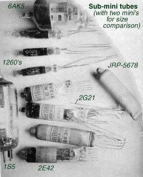

actually there are some SS amps out there that will compress. it's actually done to keep the amp from clipping. another series of SS amps has a soft clip circuit in ithe preamp that has a characteristic very similar to a tube output stage (not in pro audio.... it was NAD consumer audio). which gives a rounded clipping and keeps the amp itself from clipping. i have designed a tube preamp that gives a nice tube sound, through a SS amp (as have a lot of others), but mine uses submini tubes and will fit inside a guitar.
