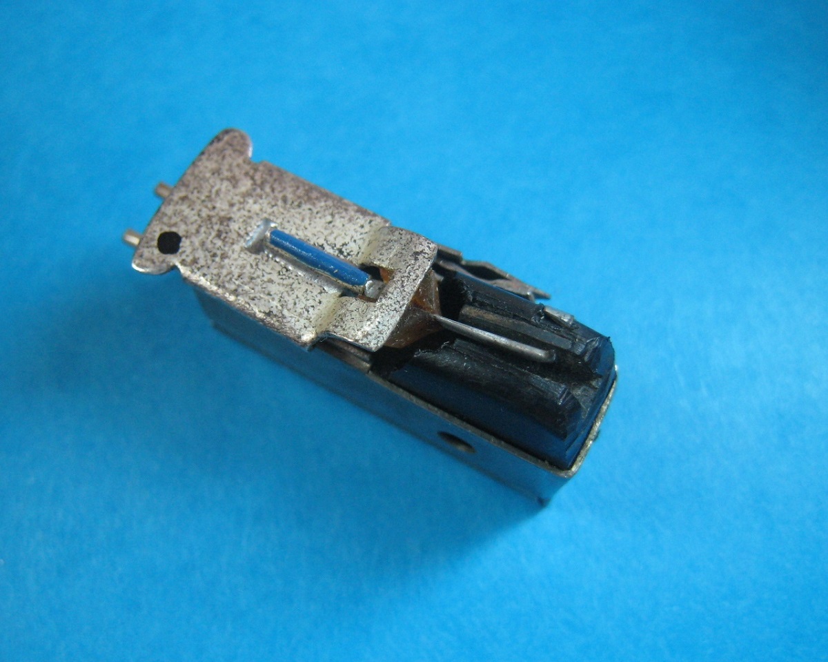

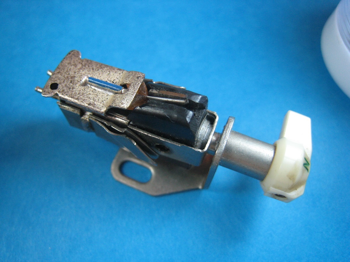

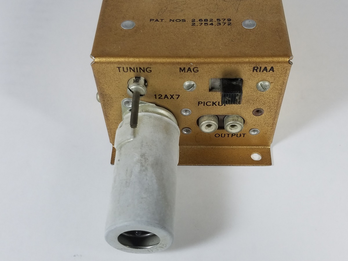

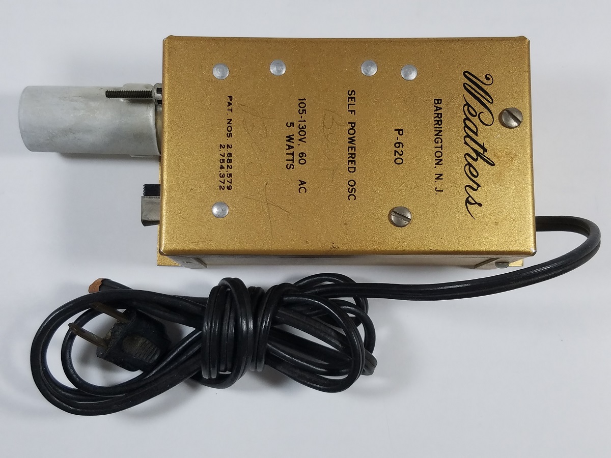

Not exactly the same idea but Weathers marketed a cartridge in the early 60's in which the stylus formed one plate of a capacitor that modulated the frequency of an oscillator. The stylus and circuit operated as an FM generator. The FM signal is then demodulated to produce audio output. Of course at that time this was only mono, not stereo. I have one of these on my bucket list to restore into operating condition. A nice feature of the design is that the moving mass of the stylus is just the stylus tip and cantilever, no magnet or iron or copper coil to add moving mass. It will be interesting to see how it sounds.
