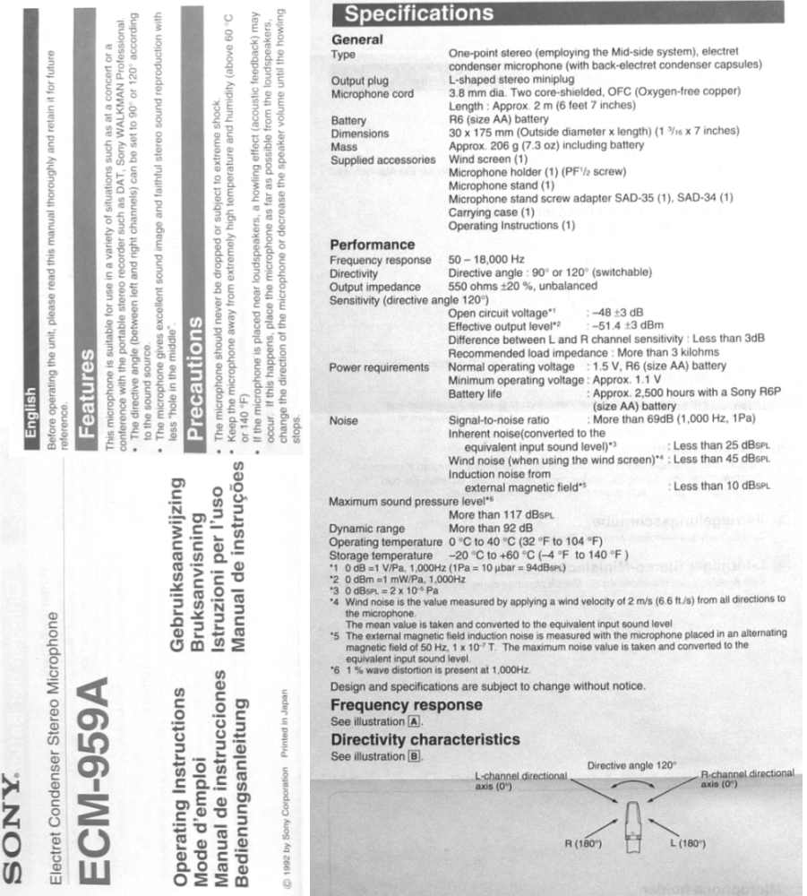

I'm Back here is the photo of the spec of the microphone I'm reading the article you gave me ...very explanatory many thanks

Electret Mic Preamp
Hello Matteo,
I just saw your post. May be, in the mean time you have already made your electret mic preamp and my response may not be very relevant now.
You mentioned the circuit at http://www.geocities.com/ferocious_1999/md/micpreamp2.html#circuit. I have made two preamps using that circuit and am very pleased with the performance. You can see pictures of my preamp at http://bizandbytes.com/preamp
I also have some spare PCBs for that circuit, in case you are still interested.
Cheers.
