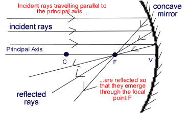

If you consider the diameter of the (parabolic) reflector, and its focal length, you can estimate the maximum off-axis angle at which sound waves, after reflection off the reflector, will enter the mic. This will tell you roughly how wide a "lobe" you want the mic to have in its forward response. (Cardioid vs hyper-cardioid, etc.)
The relevant math is basically:
tan (max angle) = radius of mirror / focal length.
The attached image is for light and a concave mirror, but it works in exactly the same way.
-Gnobuddy

No, I don't think so. As mentioned earlier, the sound from a parabolic will arrive at the microphone capsule from a fairly wide range of angles; you want a "unidirectional" capsule, but one with a fairly wide-angle response.Would a shotgun be good receiver element for a paraboilc?
You might try to visualize a car headlight (bulb + reflector) if the diagram I posted earlier isn't making sense yet. Light coming off the bulb in all sorts of directions bounces off the reflector, and gets aimed forwards. If you reverse every light beam, and replace it with sound, you get the microphone + parabolic reflector case.

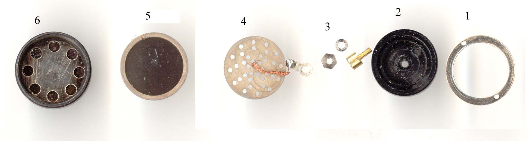

Here is a teardown of a Primo EM23 capsule. This is a larger capsule with no FET so you can do your own optimized pre-amp. This capsule is one of the prefered ones for nature recordists because you can achieve 8-10 dBA noise with it. It is not cheap at $60 in ones, and I'm not sure they sell to individuals anymore. The EM21 is the Uni version. I have built two of these and have made recordings of music and nature, you would have a hard time doing better.
6 is the front viewed from the back, there is a grill and 8 ports, 5 is the diaphragm with integral spacer around the outside edge, 4 is the backplate with the acoustic loading hole array, 3 is the hardware the gold nipple goes up through 2 (the back of the capsule) and is the contact for the pre-amp, everything stacks and 1 screws into 6 with a spanner wrench to hold everything together. The actual electret is not obvious by visual inspection.

Here is a teardown of a Primo EM23 capsule. (...) The actual electret is not obvious by visual inspection.
Thanks for that - once again, interesting and informative.

Shotguns are extremely directional - they will only receive sound from almost directly ahead of the mic.I was just wondering if the shotgun had a pattern that would would be easier to focus on, vs. a cardioid / hypercardioid.
This is absolutely, definitely, NOT what you want for a microphone you plan to aim at a large nearby parabolic reflector. Depending on the diameter and focal length of the dish, it will aim sound at the microphone from a fairly wide range of angles.
Ergo, you want a microphone which can respond roughly equally well to a wide range of angles, but all from the front of the microphone. Unidirectional, but not very unidirectional, in other words. In practical terms, cardioid is probably what you want.
Ideally, you'd want the half-angle of the forward response lobe of the microphone to be arctangent(reflector radius/reflector focal length), or something close to that. But "ideally" is not too significant in this case, practicality is what matters.
To put numbers on it: if you had a reflector dish that was, say, a foot in diameter (6-inch radius). Suppose it has a focal length of 1 foot. The reflected sound will arrive at the mic over a range of angles from zero degrees (straight ahead) up to roughly 27 degrees off-axis; a microphone with a 54 degree wide forward lobe would be a good match.
That number (27 degrees) comes from the equation I posted earlier, namely, arctangent(0.5 ft/1 ft).
A shotgun mic aimed at a parabolic reflector wouldn't pick up the sound bouncing off most of the reflector. Except for sound bouncing off the very centre of the dish, the rest would be entering the microphone at too wide an angle, and the shotgun mic would not respond to it. Most of the area of the parabolic reflector would be wasted, and would not help improve the sensitivity of the shotgun mic.
I'm still not sure I understood your question, as we appear to be going round and round in circles. If I still haven't understood you, sorry! 🙂
