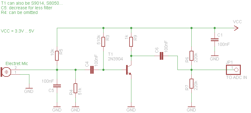

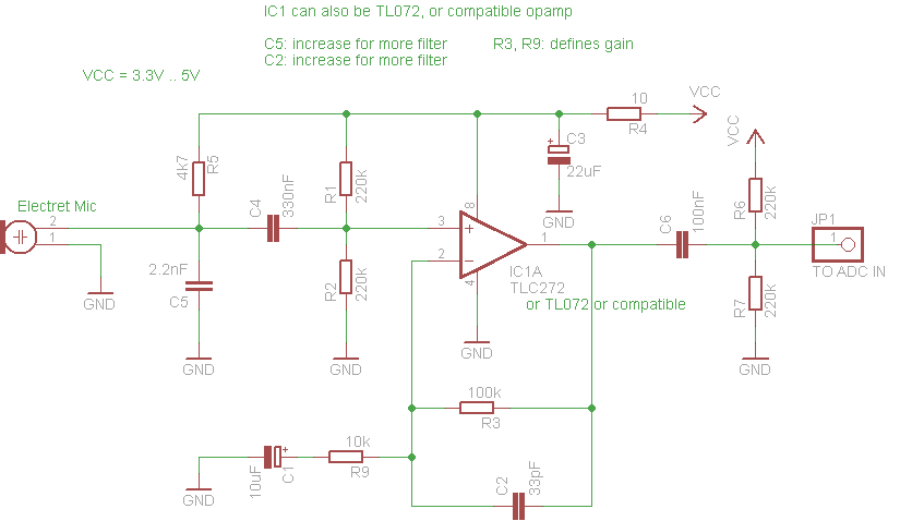

Hello, I'm building a simple Electret Condenser Microphone preamp.
This will be connected to a microcontroller.
VCC will be 3.3v or 5v.
I've found some circuit, i'm now using and testing an opamp version, and a transistor version.
Here i would like to ask you questions about the transistor version.
See schematics attached.
1-----------
Can you check if what i write below is correct.
* C6, R6, R7 are there to decoulple signal and bias between VCC and GND (needed for the ADC of the microcontroller to work properly, note: the ADC read positive voltage)
* R5: load the electret mic
* C5: low pass filter
* C4: decouple signal
* R3: bias the signal to the NPN base ??? <<<
* R9: load the collector NPN
* R4: high pass filter ??? <<<
2----------
Where the gain come from? R9
3----------

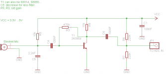

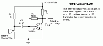

I've also found other design, where the R3 is connected between Base and Collector, like the second attachment. What's the difference?
Thank you and sorry for the newbie questions

Your interpretation looks plausible to me in each aspect.
In the past I measured the impedance of such mics being approx 20kOhm.
This impedance is parallelled with 10k load resistor totalling 6.7Kohm.
In that case voltage gain is less than 510k/6.7k - something in the range of 60~70x.
The simple circuit you posted has quite poorly defined gain figures, in other words the gain will vary tremendously depending on the type of transistor selected. It could be as low as 30 or 40 and as high as 150 to 200.
Taking the bias from the collector helps somewhat by introducing negative feedback. This helps stabilise the DC conditions and also the gain, but not really by anywhere near enough for the design to be repeatable.
Tks, now i know the difference for the biasing resistor.

Hi
Colin Mitchells design, is very proven and works extremely well. Here you of course do not need the tank circuit and RF antenna, but up to the 100n coupling in the schematic is certainly the best and simplest electret mic circuit I have had the pleasure of using, http://www.talkingelectronics.com/projects/Voyager/Voyager-P1.html
Note the voltage values provided, and ease of using BC 547 or PN2222 transistor.
Cheers / Chris

Agree and add:
1) use 5V at least 😉 ; 3.3V is way too low.
Even 5V is stretching it, but at least some Op Amps can use it.
TL072 will not work there (or be so poor as to be practically useless).
TLC272 is excellent.
Just as a side note, for such utility circuits (not for "audiophile" stuff, of course) , I always used humble cheap LM358 😱 , which is designed to work from +5V "logic" supply.
2) Op Amps are much more precise than any single transistor circuits, specially if used well within their limitations (such as , say, 10X gain).
3) I'm an Analog guy, no clue on Digital 😱 , but I guess the 220K/220K you show in all schematics is a reference voltage for the DAC.
If so, in the Op Amp version you don't need C6/R6/R7 ... pin 1 of Op Amp is already at 1/2 Vcc and is low impedance to boot 😀
4) that said, probably you'll need to add some small gain adjustment trimmer (say 10K/22K in series with R3) because not all electret capsules will be the same.
Don't know the exact precision you need from meter to meter.
Or you might adjust it in the Software 😕

3) i the first two 220K (R1 and R2), bias the signal, then i need a decoupler and again two biasing resistors (C6, R6, R7), because in my test, if i do not mount that, i get the signal a little out of bias.
4) 10x gain is ok for me, i've tested with a few mics around, then i can adjust the Spl dB conversion in software.

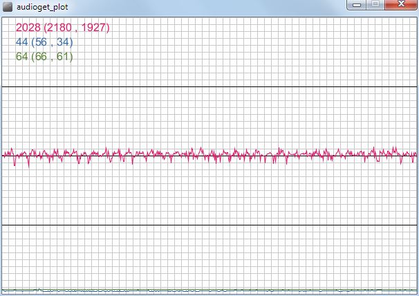

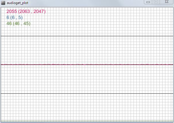

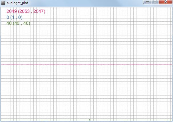

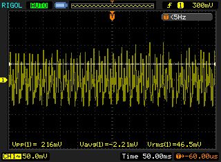

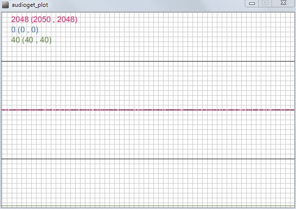

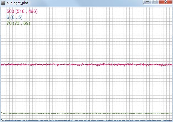

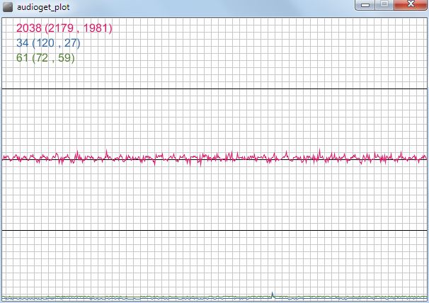

Made some test.
Audio board, the same you find in the first post. but with TLC272, R6 is attached to the same microcontroller supply, to bias the signal in the middle of the ADC voltage. i.e 5v/2 or 3.3v/2.
All image in silence condition.
The attached images are taken from the ADC input of the micro.
Test made:
5v audio board, 5v microcontroller (on Atmega8 ADC is 10bit)
5v audio board, 3.3v microcontroller (on STM32 ADC is 12bit)
3.3v audio board, 3.3v microcontroller (on STM32 ADC is 12bit)
values logged, on the top left:
violet: actual raw ADC (min, max) - for 10bit the middle value should be 512, for 12 bit middle should be 4096/2
blue: RMS value
green: Spl db value

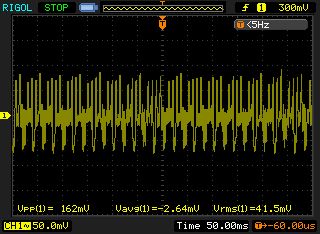

Also attached two oscilloscope screenshot of the board, one powered at 3.3v, the other powered at 5v. AC coupled.
Same test on the NPN board versions, with feedback biasing resistor. Schematic attacched.
As you can see, ADC side the opamp is more noise than the npn version.

4.5v battery (3*1.5v) = no noise, see attachments.
attached also the 5v usb powered, or external switching supply (almost the same than usb) log.
That's why i ask for your help 🙂
But, is there a way, maybe simple, to get that same result on my powered boards?
Or have i to use the 3.3v powering?
thanks!

Measurements can be a bit of a problem interpreting the results. So its quiet on battery. I would suggest as a test keeping it battery powered but adding just the ground connection from battery powered preamp to USB. See if the noise alters. If it does you have a measurement interaction of some sort. If it doesn't then still keeping it battery powered connect the preamp output to the required input and again see if the noise alters. If it does then perhaps there is hash/noise feeding back from the input of the PC.
Have you scoped the input to the PC on its own with no preamp connected.
Connected to the scope, and powered with battery, the opamp give me really slow noise.
Tested powering the opamp with the battery, and a ground cable to USB. And even trying with a switching supply. More or less the same results of the figure 2 above, the one with noise.
That is not a PC input, is an ADC input of a microcontroller, that do ADC conversion, and send data to UART.
I think i have to test the 12bit ADC, setting is reference voltage to 5v, and powering the board with 5v. Or, for this hardware, i will power the opamp with 3.3v (same voltage of the microcontroller), or use the NPN version. This will prevent that noise.
