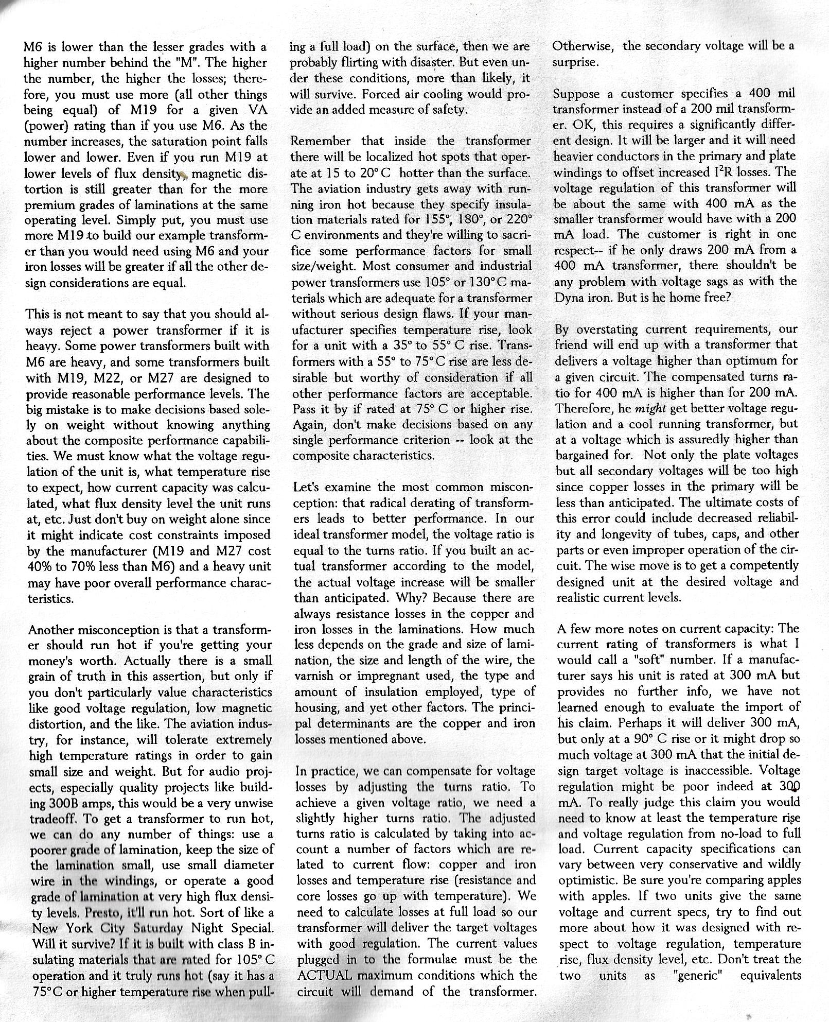

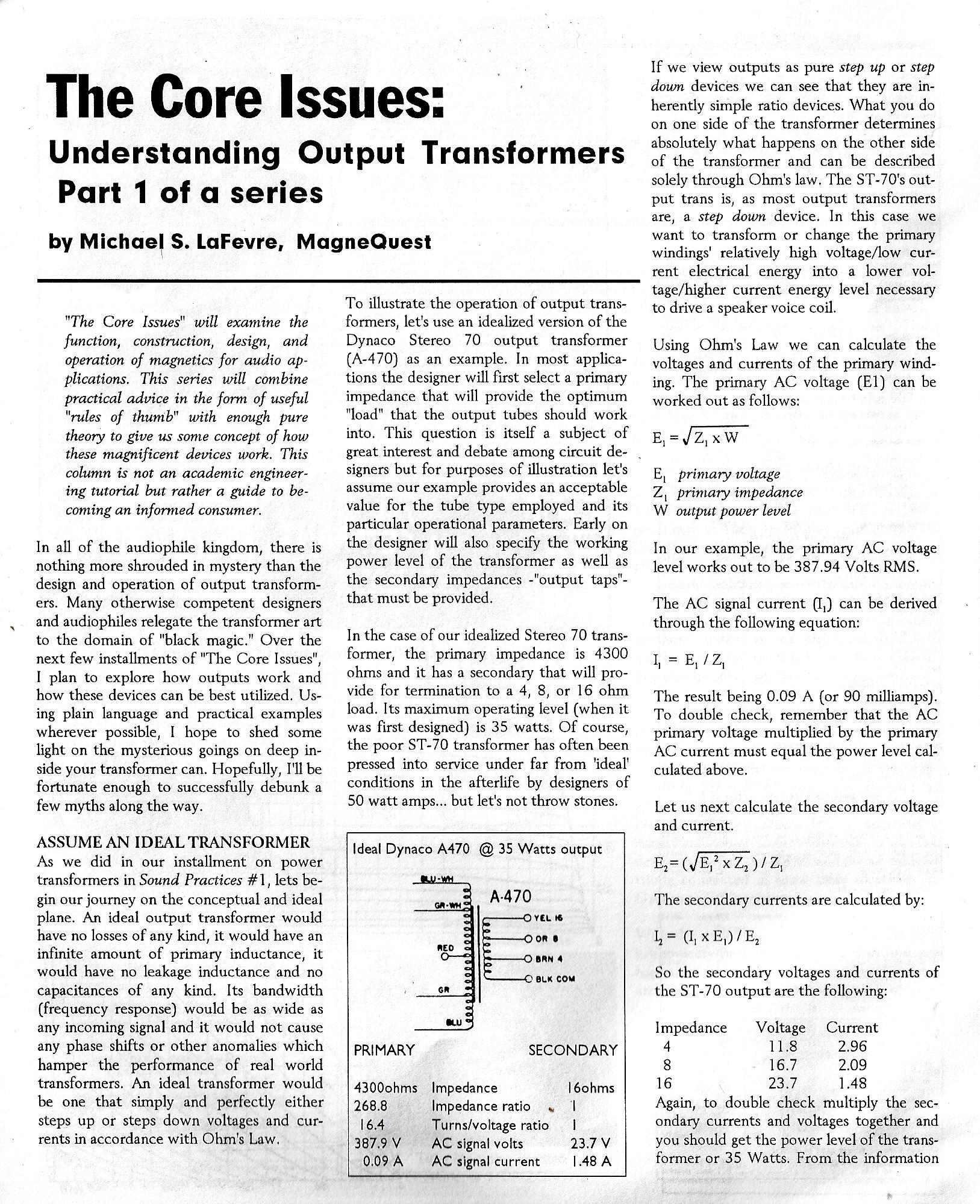

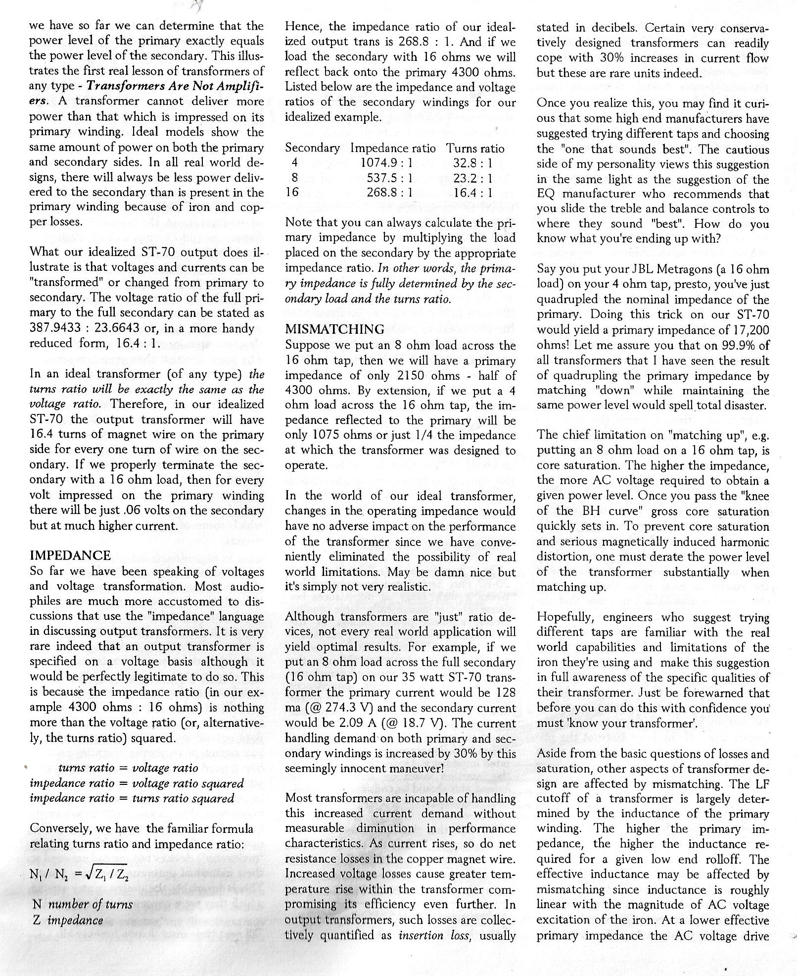

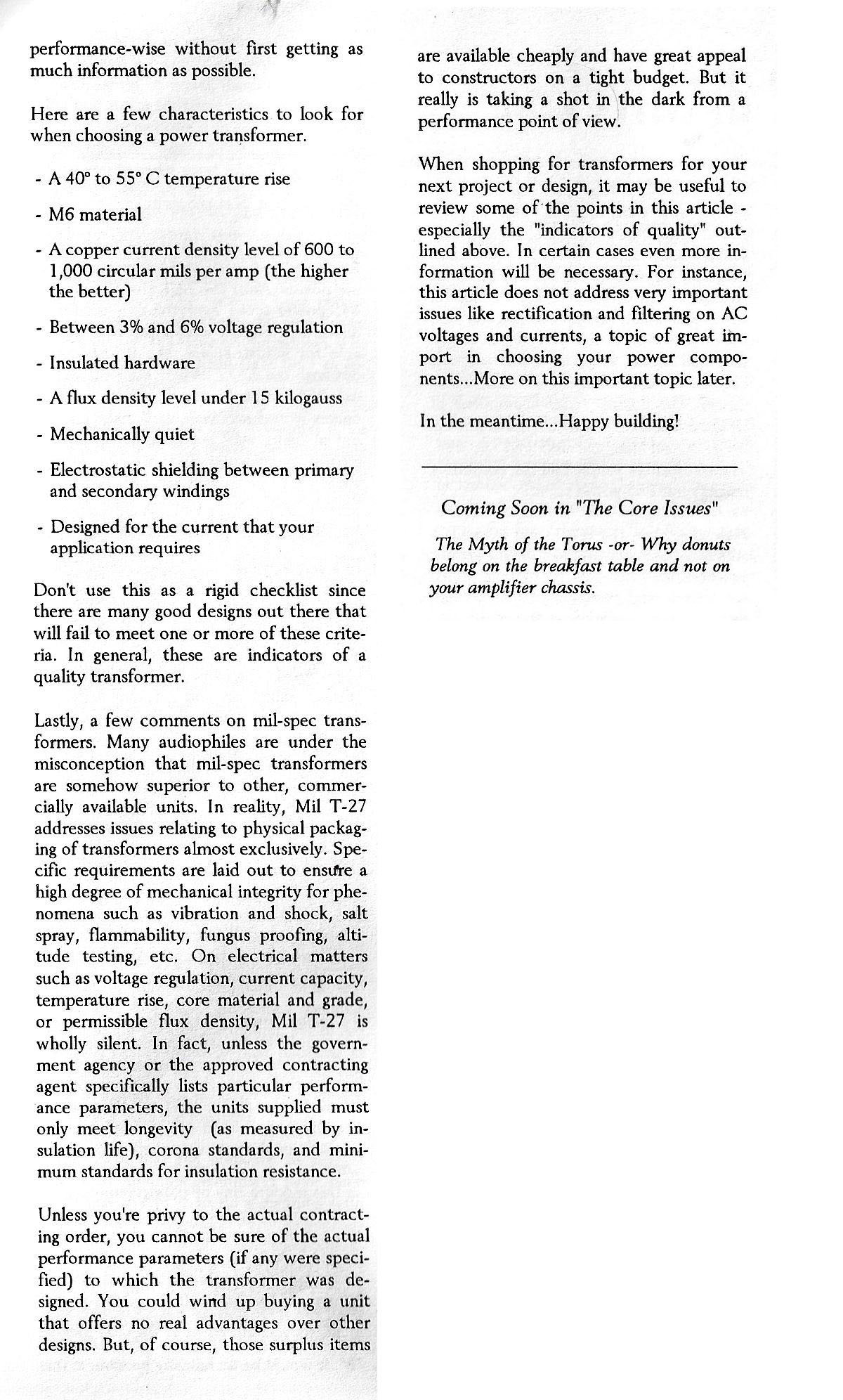

For the faithful & the curious.
Transformer article by Mike L.
