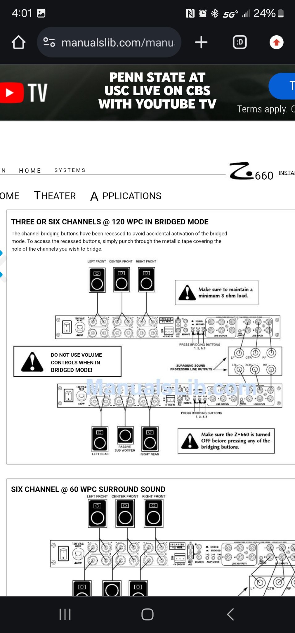

This is the general set up that I'm trying to achieve, but with 4 speakers total and from one input source(Bluetooth audio device) Which requires you to activate the bus mode button to distribute channels 1 and 2 across all outputs. Frankly i'm confused at this point🤣 Maybe I could just add an 8 ohm subwoofer To the third channel, and that would be an easy fix with the other 4 speakers run in series, right?

Well, I feel like an idiot now for anybody who read all this. I cannot figure out how to delete the post. I really did not understand the bridging mode. And now that I do, it's pretty clear how to hook up four speakers.. Activate bridge mode hook up left and right to inputs one and three And run my speakers as pairs in series to those 2 correlating channels, leaving the third inactive, Not hitting the bus mode button. Sorry if you read this but I figured this crap out at four in the morning lol
