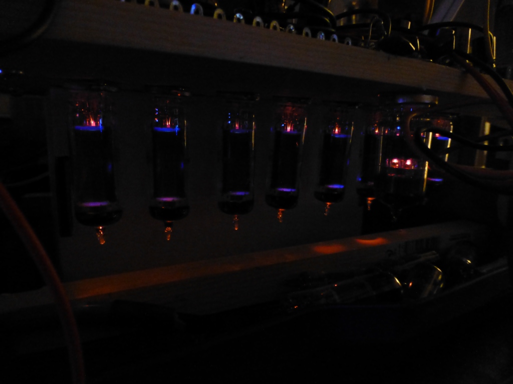

Well, I finally gave up trying to get my 20Watts out of this circuit, so I replaced the EL95 tubes with 6005W (same socket and wiring) which a 6AQ5W or EL90 tubes.
With a little re-biasing I got nearly 22 Watts RMS out of it, and a nice blue glow to suit.
The amp draws a steady 240mA from the B+ peaking at 270mA for high volume. Currently I have two silicon diodes in the rectifier and a sing 400uF smoothing capacitor before the regulators, there is no hum or buzz whatsoever. Being a valve purist I thought I might replace the silicon diodes with a pair of impressive EY500 damper diodes (440mA each max). 400uF is probably too much filter capacitor even for these big diodes. I don't want to have to put a choke in, and I have plenty of reserve HT voltage on other windings available. Can anyone suggest a solution, eg: silicon diodes across the EY500s with a resistor to "precharge" the capacitor maybe??

The output transformer has the right ratio, I have measured it, an EL95 in UL push pull with give around 5 Watts RMS, so four pairs in Parallel push pull should give up to 20Watts RMS, the theoretical maximum is in indeed as you have suggested would be closer to 48watts which is why I spec'ed a 40W OPT.
However, The reason I am only getting around 14 watts is because I am running out of current, the amplifier cleanly clips at 30volts peak-peak on the secondary, which is about 12 watts RMS.
A re-bias and substitute for some EL90 tubes (double the anode dissipation of the EL95) gives me over 20Watts RMS in the same circuit.
I think probably I am running the tubes too far into Class A to get any more than this, the EL90s are biased around 30mA a piece which is the maximum dc current my opt transformer will take....this is around 20volts on the cathode compared too 10volts on the EL95.
I would like some more power, but the EL90s (6AQ5W or 6005W) sound really nice at this bias point and 25 watts is enough for now.
I guess if I lower the DC bias current to go closer to cut off I will get more swing and more AB than class A and a bit more power.... any advice is welcome here..

Agreed, however swapping EL90s gives me 25Watts RMS straight out the box, which is 14.2vrms before clipping, this is doing my head in as that is not possible from the voltage numbers we just discussed... at 500v pk-pk
However it glows blue and looks nice...
