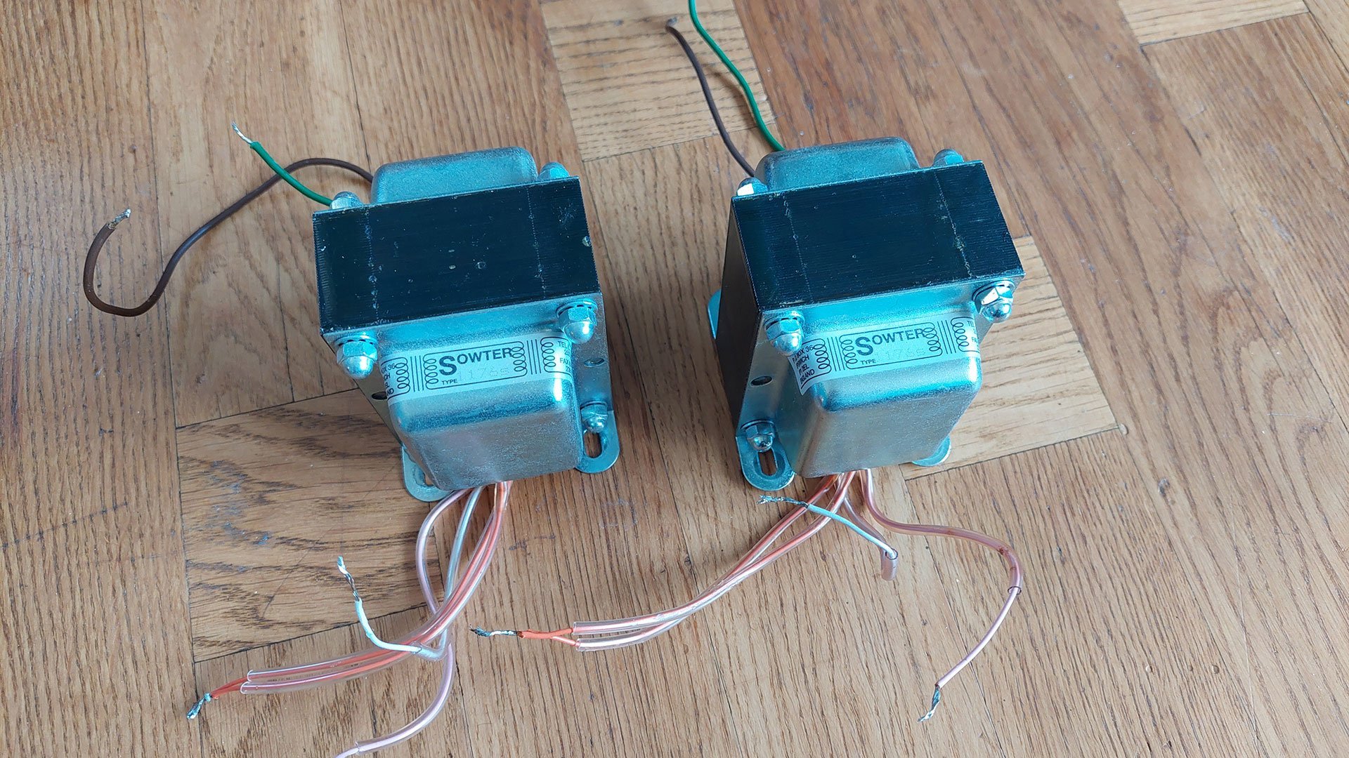

In Europe we have standardized C cores and double C cores, with the latter ones having the same outer dimensions and iron cross section as an EI core of the same size. Hence, if there are end bells for some certain EI cores, they also will fit to double C cores of the same nominal size.A C-Core transformer, but enclosed with traditional E-I End Bells?
Right?

Hi Walter, I have these Sowter OPTs looking for a home, from a recent auction. They are rated at 10k Rla-a, and I have been looking for a dedicated pentode circuit to get the best from them. The type 1176s is a custom version of U063 which has a wide range (20Hz - 30Hz).
