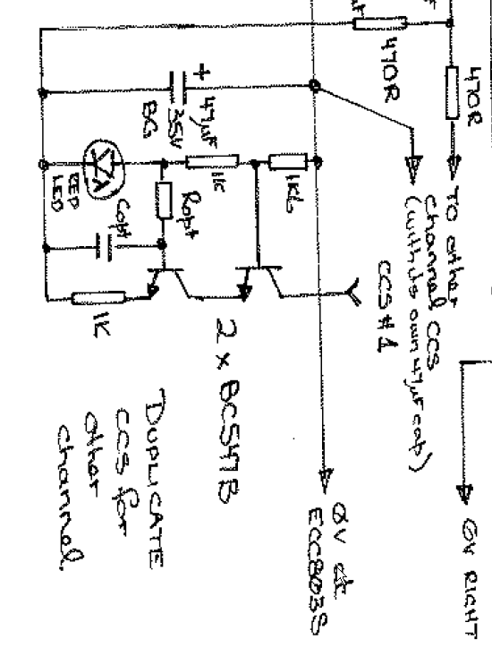

also, am I right in guessing that the plate load resistors don't need to be offset when using a CCS as opposed to a tail resistor?

Perhaps neither Stuart or I have explained completely (Stu, if I have you completely wrong, scold at will). The problem here is a regulator (voltage or current) that will reliably operate at a drop of 2v or less. Under conditions of dynamic cathode swing, maybe a lot less. What if your tail is going in and out of regulation with signal?
With the right CCS chip, maybe you could even take a bridge and supply off the heater winding (the heaters, with their several amps draw would probably never even notice), and get your chip over the problem; but the bias supply looks like the best bet to me, maybe because I'm planning to do the exact same thing.
To me, trying to regulate current over a volt or two drop looks pretty shaky.
Aloha,
Poinz
SY said:
You've got my point exactly. The cathode will have 1/2 the input signal across it, which can pop it in and out of regulation. When that happens, those chips tend to scream a bit, not to mention the rather nasty distortion on negative-going peaks.
I ended up to that, even when the off heaters - envelope was ok for the tail swing, bcs the heavy heater cap ripple was creeping through filtering and I could see +/- 100Hz sidebands on 1k signal distortion FFT.
