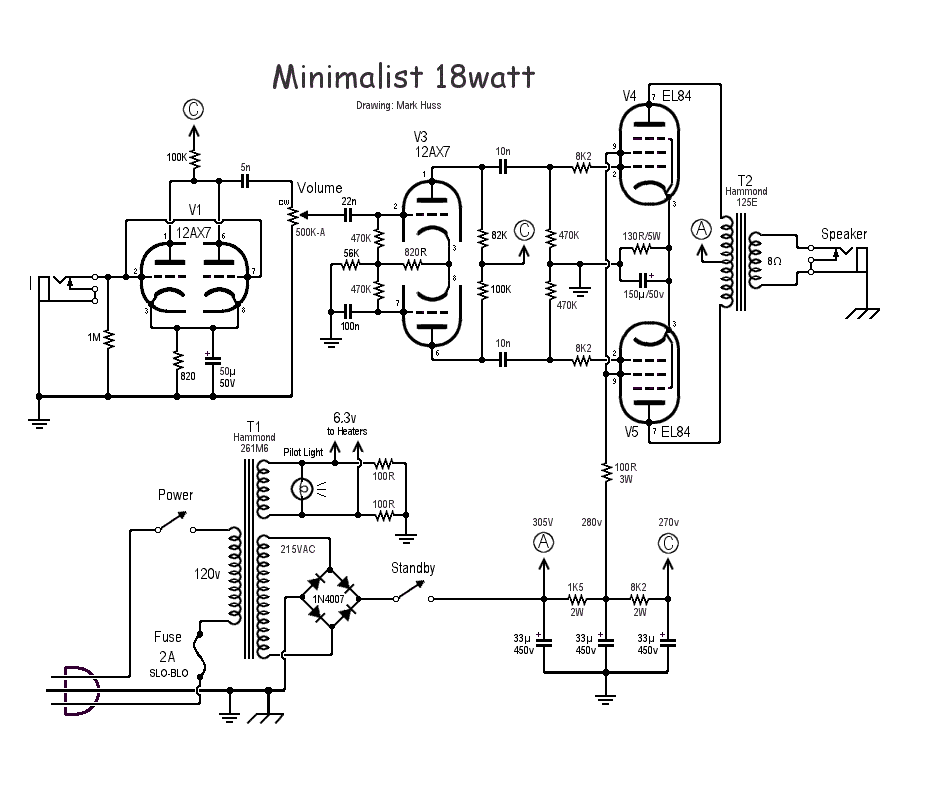

I am in the process of building an 18 watt EL84PP amp using the minimalist schematic for low parts count, cost and simplicity. (see schematic attached)
I would like to integrate a simple passive tone stack but I am stuck on where to put it into the circuit...right after the input jack? After the first 12AX7? After the driver? I have seen tone stacks placed in all these locations but what are the advantages and drawbacks of each location or is it about the same?
Fire away. Inquiring minds want to know!

I would use the second half of V1 as the pre-amp and put the tone controls between that and the first half. That will keep the gain fairly constant and ensure you use the less noisy side of the valve as the pre-amp. The circuit is obviously just theory as preferred values for components have not been stipulated. Looks OK though. Don't forget the feedback loop to keep the unwanted noise down. There is none at present.

JSE is correct. A tone stack has an insertion loss and additional gain is needed to compensate for the loss.

@ JSE: I'm not sure I follow you when you say to put it between the first and second half of V1. V1 is connected completely parallel so how would I split it up? As far as the circuit being a concept as there are no stated values. The values are on the schem. or do you mean the tone circuit is a theory because cap values in a tone circuit are totally up to personal taste and picking the right roll-off for you.
You will need to separate the double triode into two separate amplifiers. Use no more than 100k anode load with a 2.2k cathode resistor that has a 47uF decoupling it.
The component values I was referring to meant that a 5nF cap is not a preferred value, I would select 4n7, etc.
If you want to use 820R as a cathode resistor the anode resistor will need to be 47k as the valves anode voltage will be too low otherwise. 2.2k is average with a 100k load.

If the present design works, and he then wants to ADD a tine stack, the resulting loss of signal level will need to be compensated by the extra gain stage. In other words, his goal is NOT to have attenuation.
You have the two triodes in parallel, but as a minimalist parts saver, that is throwing away a perfectly useful triode. And that triode would be ideal for the gain recovery stage after the tone stack. A zillion Fender amps can serve as your model.

Connecting your guitar directly to both grids in parallel might not be the ideal load for your guitar to drive, nor are you likely to need the current from both in parallel to drive a splitter that also uses both sides of a 12AX7 (and consider miller capacitance etc. make sure it won't cut your treble). Like Enzo says, it's kind of wasting half a 12AX7 unless you're trying to average the background noise or something. It will be interesting to find out how 'dirty' it will or won't get, being so minimalist. What is your tonal goal, on the clean/distorted scale? Where did you get that part of the circuit idea from?

If you're going for a clean tone, it doesn't make much difference where you put the tone controls, except how it affects the tone of background noise (hum and hiss etc.). If it's all clean you can have tone controls really early like a guitar...caps and inductors for high-cut and low-cut...at the very input to your amp. You can have tone controls at the opopsite end, at speaker-level if you don't mind the component cost; if you turn down the treble in a cross-over-like circuit it will also cut the treble on any noise generated anywhere in the amp, including the power amp output stage. Or you can put them between any stages, or in a feedback loop. IMHO it really doesn't matter that much if everything is 'clean'...not even to the noise, because most of it is generated really early in the chain anyway, so on a clean amp a pre-gain knob or master volume has about the same effect.

does not look like it has any gain stage for guitar pickup
maybe it have been intended as power amp, for use with guitar/effects preamp
(if at all designed for guitar)
so basicly you could already be low on gain, even without passive tonestack
looks like you would be better suited looking at something more 'finished' and ready to build as is ?

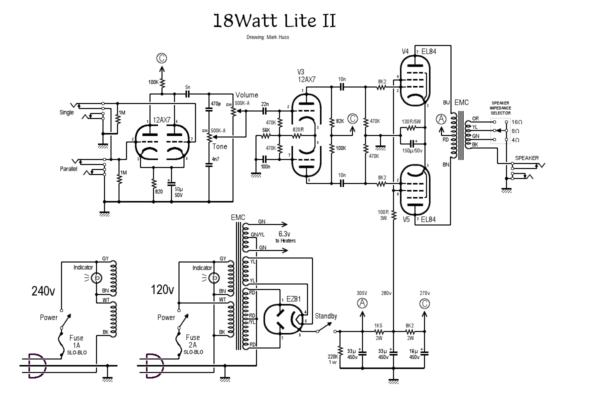

If you have a look at 18 Watt Lite IIb, there are a bunch of variations to the circuit. You can put 2 input jacks and switch between single stage or parallel stage for V1. You will see tone stack position on the circuit. If you want to go real minimalist then a single pot tone control like an early fender Champ would work. I am in agreement that using V1 only in parallel is limiting gain wise but it has a different sound, people used to parallel early marshalls that way. 2 separate stages would be better using a simple switch to go from parallel to 2 stage IMO. Have a look at Mod 102 amp kit schematic, that one is 2 preamp stages, treb/bass control and a fixed mid. More fendery sound. Note that V3 is 12 AX7 type and not AT7 which picks up more gain at the Phase inverter.
The schem should work as is, but just offering up a couple of simple mod options you can do with what you have already. I have a feeling this type of design is going for more power amp overdrive than preamp overdrive. Which is of course real nice!

It is just as important to explain the way you see it, and what the reasoning is behind the suggestions. Words matter a lot, so that schem was merely one possible way to go. The single tone control there is not very lossy on the signal, but a full TMB tone stack has the potential to drop a lot, so a second gain stage is going to work better.

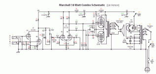

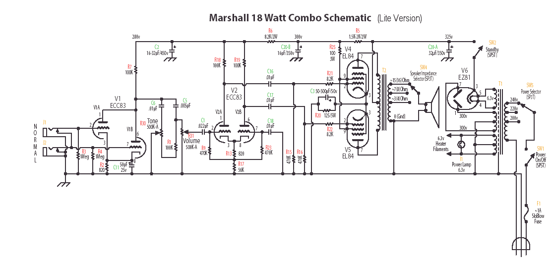

This is another version, top channel Superlite with the TMB tone stack and split V1 into 2 separate stages. The insertion loss of the TMB stack is substantial so 2 gain stages required to recover that loss. You could try the top channel preamp alone and as cyclecamper suggested try a bright switch across the ''gain'' pot as a bit of treble pre-emphesis. I just want to note that the TMB stack will give you a mid scoop, and depending on how you like your sound, an increase in resistance on the mid pot will give you less inherent scoop. Try using the tone stack calculator from Duncan amp pages, if you want to play with the stack values.
To keep the minamilist approach AND the parallel triode input stage simply replace the volume control with volume/tone control from the Fender Princton.
