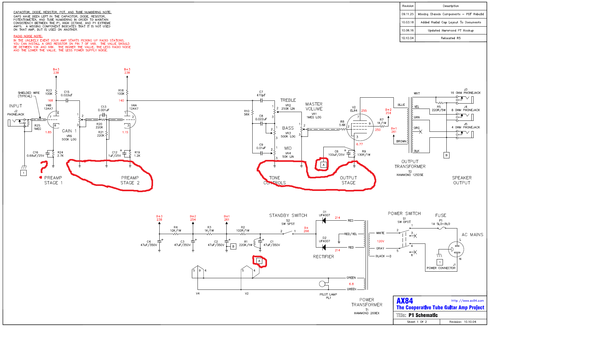

EL84 SE mixing mystery box
My OPT supposedly arrived (still have to lay my hands on it), so I took a look on the suggested AX84 schematics. They look great, full of information, targeted to be used by newbies, exactly what I needed. However the forum looks like a ghost town sadly.
I set my mind on reusing the original chassis, it has space already for 2x ECC83 and an EL84 (or soviet equivalents).
Will work my way up block by block, the goal is to eventually reach a HI-OCTANE with some mods. (rythm/lead switch to eliminate the extra gain stage, maybe switch between the original selenium and new Si rectification)
Where should I start bringing it alive? Front end or the power out section?
After building and testing the power supply I can throw all together and simply exclude the unwanted tubes while bringing up the different sections, right?
EDIT: What type of capacitors should I use near the tubes? Im guessing foilfilm where possible, especially in the audio signal route. The schema does not mention the particular types.
You could do it either way. My personal preference is to build the power supply first, then the power amp section, and then work backwards towards the input, one stage at a time.
There are a couple of reasons why I do it this way. One is that the current draw of the power amp section makes the power supply voltages fall, bringing them closer to their eventual final voltages.
Another is more subjective - if I build the power amp first, I can immediately start playing guitar through it! (Using an external preamp, or some guitar effects pedals as a "preamp".)
Being able to play through the amp keeps me motivated to complete the project, and I can hear the effect of each new stage as I build and test it.

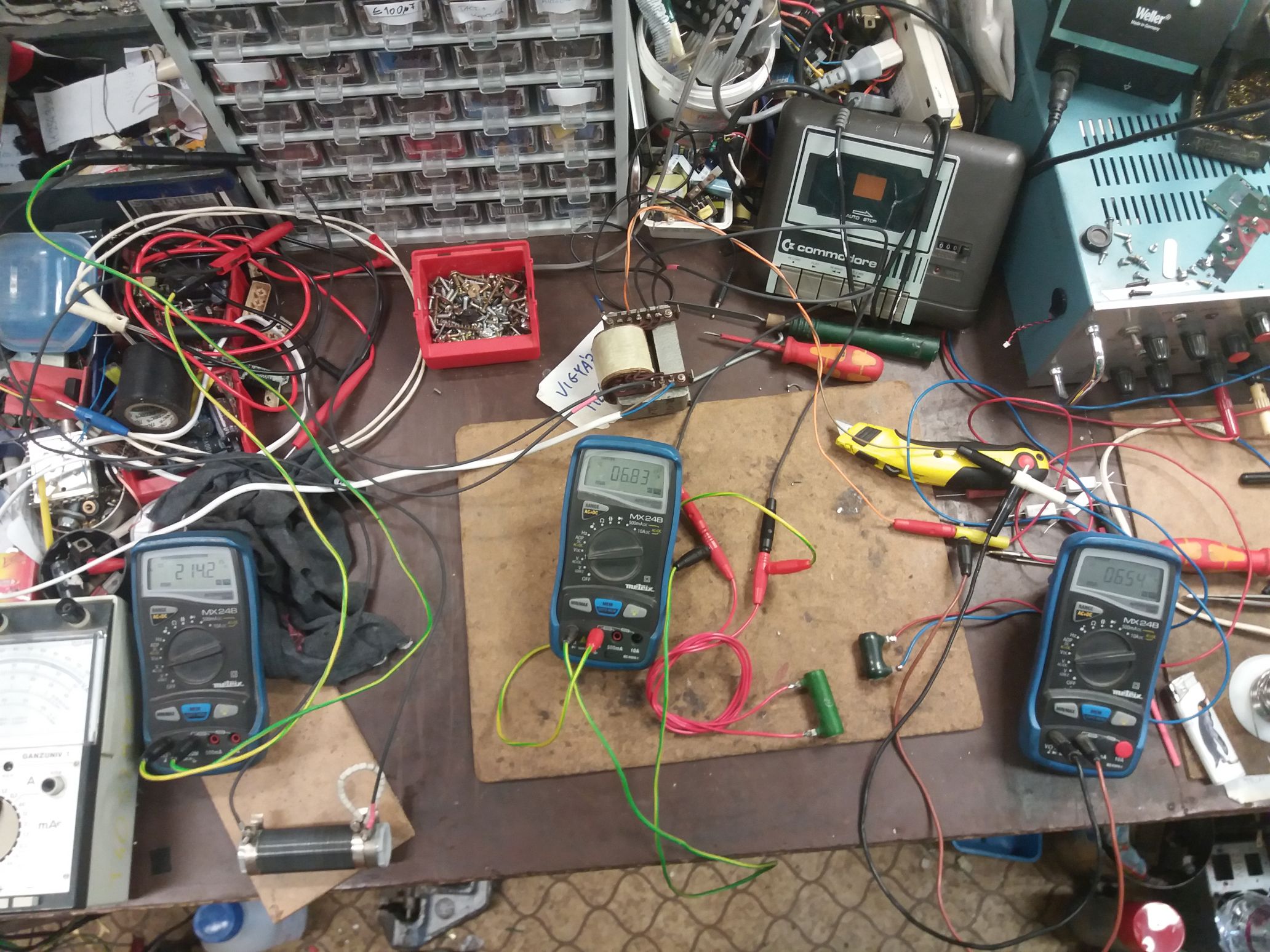

I managed to scavenge fairly proper dummy loads and tested all the secondaries. One by one at first, then gave it a go for about an hour with all loads. The transformer was getting only warm-ish, so thats good news for me.
I have also tested the power section of the amp. I only had 1n4007s at hand, but I do not think that the UF versions would make so much difference.
My unloaded HT is 320V, at full load that drops to 250V, that seems like, this transformer is perfect for the tubes. (full load is tested with 55mA)
The filament secodaries are not seeming so sweet sadly. I have one which gives me 6,6V @300mA and another 6,6V @660mA. I have not found any concrete info on filament voltage vs. lifetime, yet; so I do not know if this should bother me significantly.

...one which gives me 6,6V @300mA and another 6,6V @660mA.
It's easy to fix the excessive voltage, just put a small resistor in series with the heater to drop the extra 0.3 volts. For example, 1 ohm in series with a 300 mA heater, to drop 0.3 volts and leave 6.3 volts. Power dissipation is only 0.09 watts in this example, so you can use an ordinary 1/4 watt or 1/2 watt resistor.
In practice, measure with your DMM to see what voltage you actually have (it may be more than 6.6V), before you work out what resistance to add to drop it. When you do add the resistor, the heaters will draw a little less current due to the reduced voltage, so now you may find that you need a slightly bigger resistor than you originally thought you did. Usually two steps gets you close enough.
Incidentally, adding series resistance like this (slightly) improves tube life. A cold heater has low resistance, and draws a big spike of inrush current until it warms up. Adding a series resistance (or better, powering each heater from a current source, or a slow turn-on 6.3V volt source) reduces the inrush current, and this should reduce stress on the heater and extend tube life.

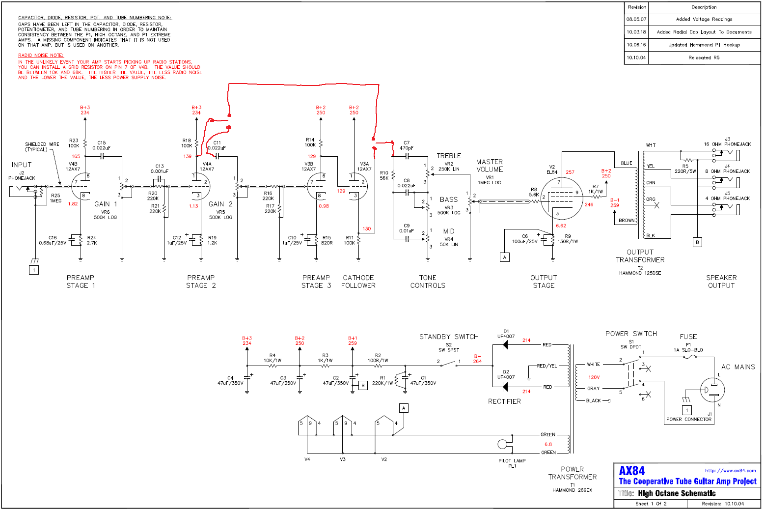

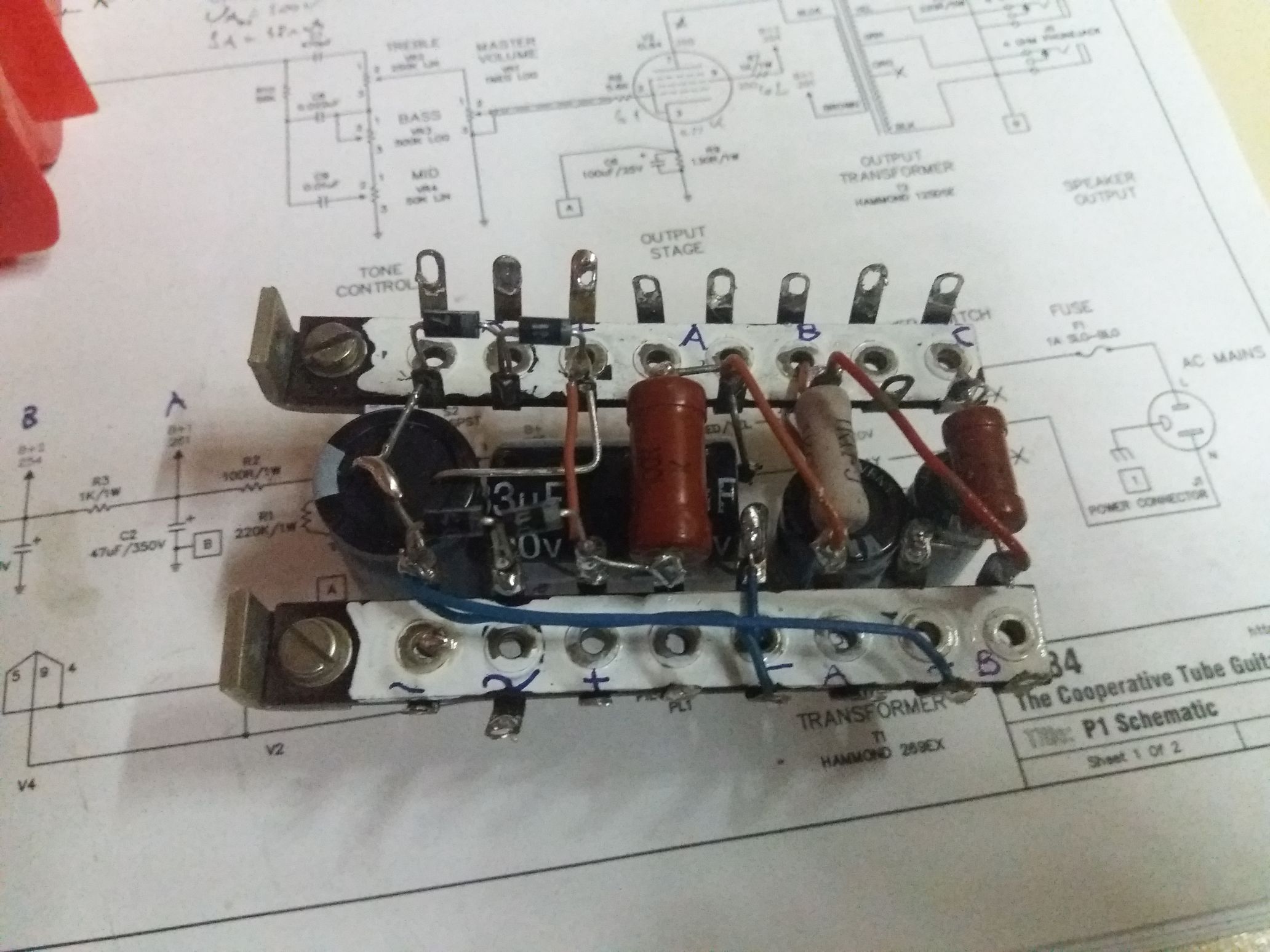

The beast is coming alive, I have thrown together the P1 schematic without the tone section for starters. I have to say that the hum seems to be not a big deal without elevating the heaters for the preamp section (even with my makeshift heater wiring for the tests).
But my power transformer is not a shielded type and its too close to my tubes, I get tons of hum when I put it in its place. Can I simply put an iron sheet onto the chassis between the trafo and the tubes to add some shielding or what material should be used?

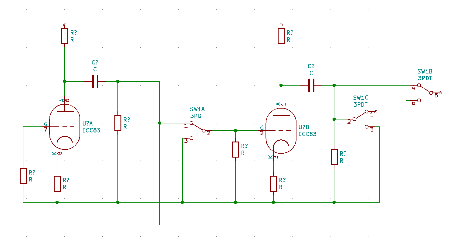

On my next move I want to add the tone section and the second gain stage (making it a HI OCTANE). Is it possible to add a DPDT switch to bypass the second tube if needed? Do I need any more components to prevent damaging the second tube, oscillations, etc? (Switch off HT maybe?)
Also if I want to switch between different rectifiers, do I just simply add a DT switch on the HT line before the filtering or should I wait to discharge the caps and then switch on again?
On some schematics I have seen diodes in the HT lines going to the OPT and the second grid of the pentode, are these some kind of extra safety?

...hum...an iron sheet onto the chassis...
If at all possible, first experiment with transformer orientation (rotating it to find a minimum-hum position), and with transformer location (further away from the input.)
The next thing to try is an electrically conductive sheet or box around the transformer - not magnetic material, but a good conductor like aluminium. The idea is that the AC magnetic field will induce eddy currents, which by Lenz' law, will create their own magnetic field opposing the original one. If all goes well, the AC magnetic field outside the box will be reduced enough to lower your hum to acceptable levels.
It's also worth trying to shield the input tube itself - there are commercially available metal shields that slip onto matching tube-socket bases to shield the tube, but you can experiment with something simple like aluminium kitchen foil (grounded with a clip-lead) to see if it makes a useful difference, before you spend money on a shielded tube socket.
If those options are impossible, and if the hum is caused by stray magnetic field (and not stray electric field), the "sheet of iron" idea is worth a try. The goal would be to create a low-reluctance magnetic circuit that shunts away leakage magnetic flux from the transformer, and keeps it away from the sensitive parts of your circuit.
There is a special substance called mu-metal ( Mu-metal - Wikipedia ) which is ferromagnetic, and has a very high permeability, and is sometimes used to shield from low-frequency or DC magnetic fields. Unfortunately it is expensive and hard to work with, so it's not something we see often in consumer-grade equipment. (After your make your mu-metal box or shield, it has to be heated in a magnetic field in a hydrogen atmosphere, and cooled slowly to anneal it!)
...Is it possible to add a DPDT switch to bypass the second tube...
Yes! But there are a few things to consider.
For example, in your drawing, the DC voltage on the anode of the input triode is not the same as the DC voltage at the cathode of the cathode-follower. So when you flip the switch, there will be a large step-change in DC voltage (a Heaviside function, which you might remember from when you were studying Laplace transforms at university.) This will make a huge thumping or popping sound every time you switch that extra stage in or out of circuit - definitely not acceptable!
So the first thing to make sure is that there is zero volts DC on all the points you plan to switch - all three terminals of each double-throw switch. You may have to add additional coupling capacitors and resistors to ground as needed to achieve this. If all the terminals are always at zero volts DC, there won't be a loud pop or thump when you switch the extra stage in or out.
For this reason, you also definitely do not want to switch the B+ voltage to any stage on and off - that will cause the loudest possible pops and thumps and bangs of all. A definite no-no!
So far so good. But there is a second problem to consider, and it's something that is peculiar to guitar amp switching. There is no proper engineering term for it, but it is sometimes called "offness". Offness, is, basically, the ratio of signal getting through your closed switch, to signal leaking through your open switch.
Offness would ideally be infinity, but because of stray capacitance in the switch and the wiring, and because of the high input impedance of vacuum tube stages, and because of the high voltage gain in guitar amplifiers, it is quite likely that audible amounts of high frequencies will "leak" through when the switch is off, especially in a high-gain guitar amplifier. This can be very annoying!
One way to improve offness is to put a switch in parallel with a signal, rather than in series with it. For example, if you wire a switch to short a signal point to ground, you can get very good "offness" there.
You can combine the two ideas, using another switch contact that shorts a signal point to ground in the "off" position, but connects it through to the output in the "on" position. The catch is that you now need three or four poles (3PDT or 4PDT) to fully switch an extra gain stage in and out. This usually means you have to use reed relays or something like that in order to get enough poles. Obviously, you switch power to all relay coils simultaneously so they operate in synchronicity.
The attached image shows the idea. Input and output of the second gain stage are shorted to ground when that stage is not in the signal path. This means there is less unwanted signal to accidentally leak through to the output. But the price you pay is needing a 3PDT switch rather than a DPDT one.

...diodes in the HT lines going to the OPT and the second grid of the pentode...
Can you kindly include a part of a schematic with these diodes, so we know what we're discussing?

There are no other options than introducing some kind of shielding between the power transformer and the tubes. The chassis and box is soo tight that only one orientation and placement is possible safely. I will have to scratch my head placing the fuses and indicators.
The tubes are already shielded with their windowed alu caps, thats a feature which came with it.
When I put the trafo down on the table near the chassis (about 10-15cm further from the tubes, somewhat shielded by the side of the chassis), the hum went from irritable and unacceptable level (on room volume) to nearly nothing. Everything cranked, guitar plugged in, I could not believe my ears...
I will try some different materials for the shield, I can try and wrap copper foil onto the insulated windings themselves if nothing seems to work.
Also when I tried moving the trafo I hooked up a larger test speaker, hence the large reduction in hum, there was a distinct 50Hz hum present.
Maybe its time to whip out my rusted scope skills in the shielding process and see whats up, with my eyes.
As for the stage switching, thanks for the in depth description, I felt by gut that I could not get away with those unity step functions. If I add a feature like that I think that should be remote controlled, so relays and whatnot have to be involned. Absolutely no spare space in this box, so I have scrubbed the idea in this build.
For the diodes in the HT lines, please see this picture:EL84 SE

...When I put the trafo down on the table near the chassis (about 10-15cm further from the tubes...the hum went...to nearly nothing.
Distance is definitely your friend here. Monopoles (like mass and electric charge) follow the inverse square law for field vs distance, but power from a magnetic dipole falls away much faster with distance - either inverse square or inverse cube, so that radiated power falls away as inverse fourth power, or inverse sixth power! ( Near and far field - Wikipedia ).
So, with a transformer, even a small increase in distance can really reduce hum fields.
Is it an option to mount the transformer off-chassis? Maybe build a separate power supply box, find some suitable connectors, build a plug-in wire harness to connect the PSU to the chassis? If everything is going into a combo guitar amp, you could mount the transformer on the inside of the wooden cab.
I can try and wrap copper foil onto the insulated windings themselves...
I think if you get the copper foil too close to the winding, it will act as a shorted transformer turn, which would be very bad. It would behave like shorting the secondary of your power transformer. 😱
...stage switching...
It's essential that everything is at zero volts DC, but that doesn't take many additional components (maybe a couple of resistors and caps). The attached image is the simplest switching scheme I can think of - maybe worth a try to see if it works acceptably?
Thanks for the schematic!
I cannot make any sense at all of the apparently randomly placed extra diodes. Either I'm overlooking something, or it is another case of Internet nonsense? 😕
Basically does it matter which tubes cathode do I elevate to?
The cathode of a 12AX7 is usually within less than 2 volts above ground, so it's pretty useless for elevating the heater of another tube; there's not enough DC voltage there to do anything.
The output tube cathode happens to be a convenient DC voltage that can be used for heater elevation - it's typically ten to twenty volts positive, depending on the output tube you're using. But you can just as well use a voltage divider from B+ to ground, made with two resistors; there is nothing special about using a cathode to provide the elevation voltage.
I use small switch-mode DC power supplies to power heaters with DC, so I have never used heater elevation - there's no need, as there's no AC current through the heater wires to cause hum!
