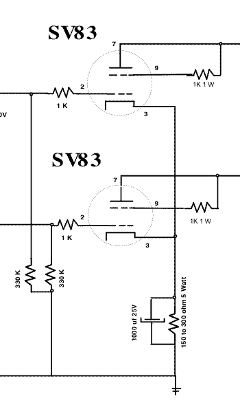

FURTHER...
Dave,
Of course we are talking about bypassed Rk? The problem I addressed in the Zen (or Mulligan, as some call it?) case is ABOUT UNBYPASSED Rk. The supposed mixing of signals, etc. commented above in the thread was about the fact the Zen amp uses one Rk common to the output tubes of both channels, and this single cathode resistor is not bypassed.
Mixing of signals, combined cathode degeneration for channels... name it whatever you like -- it certainly adds some flavour to the sound. And that is something you already said you're against.
Now again about bypassed common (or strapped together) Rk.
I do not have the time to do it! And, I do not have the place to do it! Making anything in the cramped living conditions I am forced to bear for reasons relatively appearent thru this thread requires great motivation and intent -- which I do not lack when it comes to making a new amp, or preamp... especially when I have something new or different on my mind and want to translate the theory to practice. BUT, when it comes to trying something I feel unnecessary, or not leading to any reasonable result -- it would be just a loss of time and energy.
Well, curiously, that is my opinion, too. Since it seems to me that stereo is two separate channels, each carrying an amount of information, I tend to think of any contact between these two channels before being "emmitted" from the loudspeakers to be damaging to the integrity of that signal.
Notwithstanding, we mostly mix them in a lot of places -- from grounding arrangements to common power supplies for both channels (if amps and preamps are not completely monoaural) etc. Some of these "potential mixing" (and mixing it certainly is - although mostly on relatively low levels, i.e. -80dB or more) can be "forgotten about" since at the levels where they occur they should not be audible or quantifiable, and it is either simpler or cheaper or more practical to do it that way... but, if as you assume, a bypassed common resistor would sound differently than two adequate separate bypassed resistors -- than to some logic reasoning it means there is some interaction between the channels.
To me, the less interation there is between the channels, the closer we are to the "truth" of the signal.
Regards to all,
Aleksandar

Re: FURTHER...
Mulligan is the name given to a ZEN-like-clone...
unbypassed Rk? Not in the map i've got.
dave
Alex Kitic said:Of course we are talking about bypassed Rk? The problem I addressed in the Zen (or Mulligan, as some call it?) case is ABOUT UNBYPASSED Rk. The supposed mixing of signals, etc. commented above in the thread was about the fact the Zen amp uses one Rk common to the output tubes of both channels, and this single cathode resistor is not bypassed.
dave
But why 😕
The Zen has an unbypassed cathode resistor common to the output stage of both channels according to the schematic posted on the Decware website. See it here.
bypassed or not?!
Well, I am not at all surprised by this latest revelation... if there were not bypass cap, it would not make much sense -- on one hand, aforementioned channel mixing etc. -- while on the other due to cathode degeneration distortions would be lower but gain limited and the power output into the (same and usual) load would be much lower, as well.
It is true that the Decware website hosts a schematic version (revision C, if I am correct) showing a non-bypassed Rk common to both channels. And, furthermore -- there is a photo of the interior somewhere on the site showing a nice looking resistor with metal coolers -- but no cap near this resistor.
Now, what we might really need is someone who owns the "original" amp ("Would you buy your dad a fake Rolex?" says the site -- if you ask me, better a fake one that shows the correct time, than one that is not fake but does not work, either...). Maybe this person could tell us whether there is a cap (I almost cannot believe that there isn't -- but then the published schematic is in practice dishonest) in the original amp!!!
Aside the discussion on Rk, common or not (maybe necessary, but one I tought would never happen...) is there anyone who has tried both amps?
Regards to all,
Aleksandar

bypassed or not?
Well, the latest contributions seem to indicate that the by now famous Rk of the output tubes is bypassed. That is quite fine by me -- if you get back to my original comment, I found that a huge, almost impossible flaw, and if the Rk is bypassed, to me it is quite OK.
Since by now everyone seems to ask where did I get the schematics from, here is a link: (I do not know whether the link will work or whether I am entitled to place links, but let's try):
http://www.decware.com/se84cschematic.pdf
I have also attached the file with my post, so anyone can compare it...
Those of you who maybe like the Zen Amp idea better than seeing it critisized by some "audio designer" -- still cannot rejoyce (those addressed have already recognized themselves -- others, please do not find yourselves offended): if the common Rk is bypassed (phew, thank God), that does not mean the driver tube has an adequate operating point, etc. And, unless I somehow missed it in some alternative source, there is no choke in the power supply... etc.
Regards to all,
Aleksandar

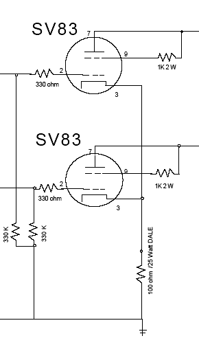

audiousername said:Mulligan...But why 😕
It just happened one day --> Zen Clone > Bogus Zen > Bogie > Mulligan .... 🙂
Because they are clones they often get souped up pretty quick. My buddies has gone from as close as he could get to the schematic(except for a hybrid bridge)... then PS improvements (including choke), most recently, splitting the EL84s Rk and upping of the driver tube bias (both of which he reports made big improvements)... now on his bench is a pair of parafeed monoblocks (with 5 pieces of iron each)
dave
GeirW said:Just as a "sidenote" to Dave`s post.
(where is you schematic from?)
attached is the latest revision of the 84zen.
(from the manual)
but all revisions seems to be the same, with exeptions
from component values/brand.
My snapshot is from the Zen map i downloaded from the Decware site... i have seen a number of variations of this document but not seen an unbypassed Rk -- i have seen the mod discussed. All 3 of the real Zens that have come thru our local diy hifi group have had bypasses.
dave

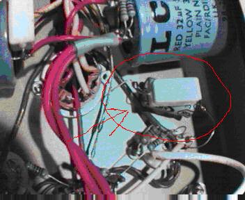

And of course,on the picture Mr. Milan posted on post 67 which is Decware's execution of the Zen amp, I found unpermissible to put up on the bypass cap a 5Watt Rk resistor,which is in close contact!! It is not even good to put it in the close vicinity! Especially if you use expensive caps.The high temperature will ruin every el-cap in the couple of years.
Yugovitz
Yugovitz
Yugo said:...on the picture Mr. Milan posted on post 67 which is Decware's execution of the Zen amp, I found unpermissible to put up on the bypass cap a 5Watt Rk resistor,which is in close contact!!
The picture was taken from the Decware site and used here only to show the bypassed Rk in question. As regards the point you are making, I couldn't agree more but that's a whole other can of worms.
Milan

Resistors and caps...
Hi, Yugo!
Thank you very much for pointing out the issue with the cap bypassing the Rk on the photo of the Zen Amp posted by Mr. Milan. I saw it right away, but did not want to post just on that issue...
Now for a very interesting question -- the g2 connection.
The g2 is intentionally left as it is, just connected to the B+ supply thru the 2.2k resistor. Why?
1. Theory
Actually, you do not need g2 to be additionally bypassed in order to achieve "pentode mode" since what is necessary is a different AC path (and here it differs by not passing thru the output transformer, while for AC grounding, it is indeed grounded thru the nearest cap of the power supply).
2. Simulation
At first, simulation was executed with the schematics as shown. Further, I tried to improve by connecting the g2 thru a cap to ground, even inserting an additional power supply just for the g2 of the output tube -- but the results did not change a bit.
Now someone could intervene that simulation results are bla..bla.. but interestingly enough, bypassing the g2 to ground did change the simulation results (as expected, improvement) in a later design RH34 (for EL34/6CA7 tubes) which is not published on my web site for stupid reasons -- the web site was meant as non-finished at the time, and by now I think it is time to make some thorough changes to it.
As you can see from my answer, there were no financial reasons involved -- as there never are in my designs, since it is not about kits for sale or anything. A little digression -- why a common Rk on the Zen? Well, one resistor costs less than two, not the mention the price of two bypass capacitors instead of one... 🙂 (I do not actually know whether to laugh, or to cry at this one).
If you are interested in the RH34 schematic, just e-mail me, and I'll send it to you. As I said, the site was never finished -- and by now it is time to make a new one...
A final little issue - as I said, the g2 is connected to the B+ supply thru a resistor. Aside being a "grid stopper" of the sort, actually it tries to keep g2 at the same potential (or similar) as a. I had some toughts about regulating the g2 with 0A2 in a string, or something like that (I would not go as far as making a FET regulator... come on, by now you should know me better than that). But I dismissed the idea since without any further refinement of g2, the amp sounded just fine... sometimes I try not to overcomplicate things.
If the power supply was poorly regulated (by that I mean: not enough current, not enough capacity, high ripple, etc.) in practice it would have great effect to do something with g2. Since that is not the case (and the published version of the power supply is actually the most basic PS done for this amp in its various "incarnations") -- the issue was never addressed, altough it might warrant consideration.
In case any of the thread participants does make one and try it (come on, Planet10 -- your friend might now decide that he could replace the driver tube altogether and add a couple or resistors here and there, making his clone an RH amp!) -- his experimentation with g2 might be a very interesting addition and the very first mod to the RH84 circuitry since it was made!
Regards to all,
Aleksandar
