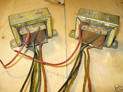

Grundig Output Transformers
Dave,
I understand that these transformers have dual secondaries - would you happen to know the lead color coding? I have a pair coming to me courtesy of a 1959 console that I would like to use for an RH84.
Thx,

See my previous post - I plan on using these Grundig transformers to build the RH84.
The RH300B is next - would appreciate a schematic so I can start buying parts. To avoid expensive tubes, could it be used with 2A3s as well?
Thank you for ypur designs and all your hard work.

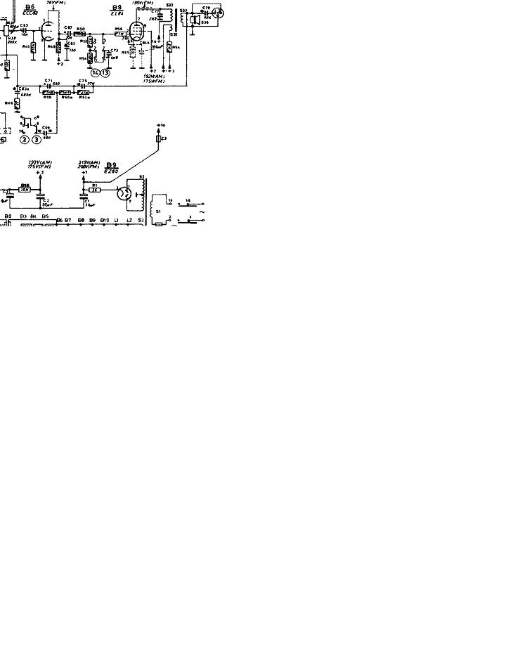

next generation ?
In another thread mr. Kitic sounded somewhat frustrated
about the lack of recognition he got for the RH84 design that also could be used in a PP setup (but people did not try that).
I built a SE 6N1P/el84 version (will try 6N2p later) with 0A2 regulator tube (150V) on the screens of the el84. I will clearly state here that it sounds outstanding (on a small 50 year old OPT) and it is obvious that it would be tough to find a better alternative soundwize for the same money. That said I think I will experiment further to stretch the concept. I have a old Philips tube radio (b5x14a, from the sixties or seventies) that uses the El84 and 800 ohm speakers. They use a device that is either a choke or a OPT to transform to 800 ohm. I wonder if that device can be used as a interstage coupler to a powertube like 300B or similar. Nice to try in the future.
By the way, is EI still making el84 tubes ?

It's a transformer. Check DHT Rob's site, he did some experiments with them, rather to his liking. No way I can find it again though.. 🙄
Jaap said:I have a old Philips tube radio (b5x14a, from the sixties or seventies) that uses the El84 and 800 ohm speakers. They use a device that is either a choke or a OPT to transform to 800 ohm. I wonder if that device can be used as a interstage coupler to a powertube like 300B or similar. Nice to try in the future.[/B]
