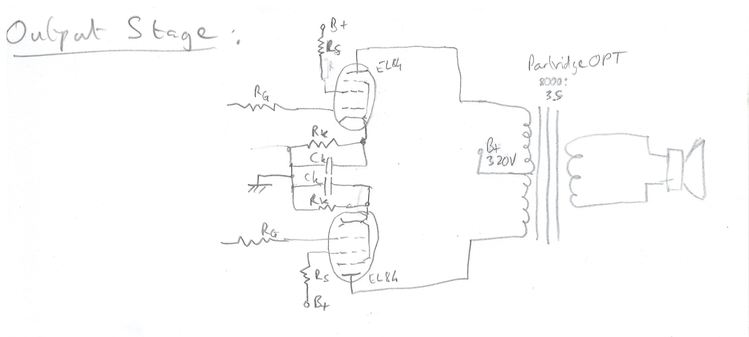

EL84 PP design
True KP, but with less gain from the stage with NFB applied, the common cathode gain stage say, then stages after this need more gain no?
I only drew the OP stage, you use droppers for each stage or whatever, see VW - The Valve Wizard - last page bottom diagram.

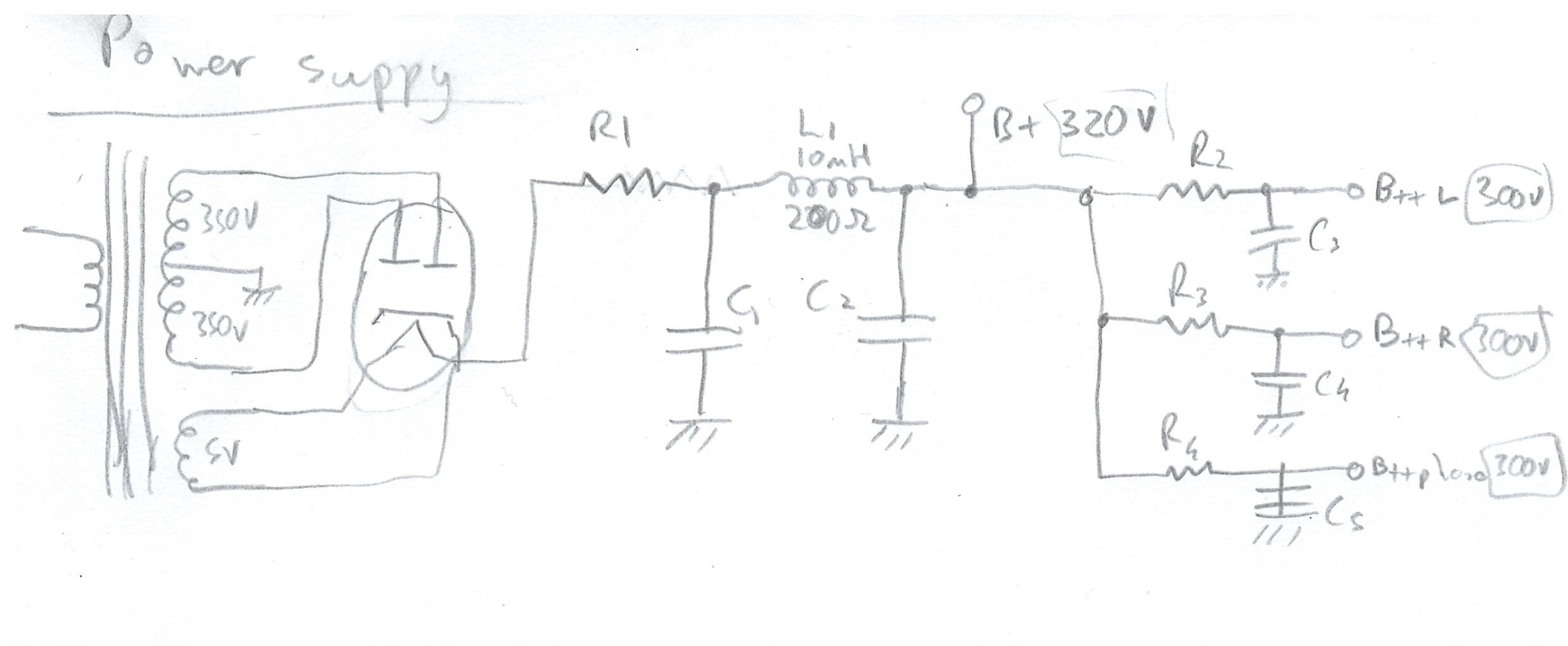

Resistors in a power tube G2-circuit should not be used to limit the voltage/dissipation there, only what is sufficient to quell oscillation. The one exception seems the EL34, where a relatively high 1K is used; this drops the maximum output somewhat, but shows better distortion behaviour.
This is because initially one sets out to keep Vg2 constant (variations affect maximum output power ability). Then one goes and make it 'unconstant' again by adding relatively high series resistors .....

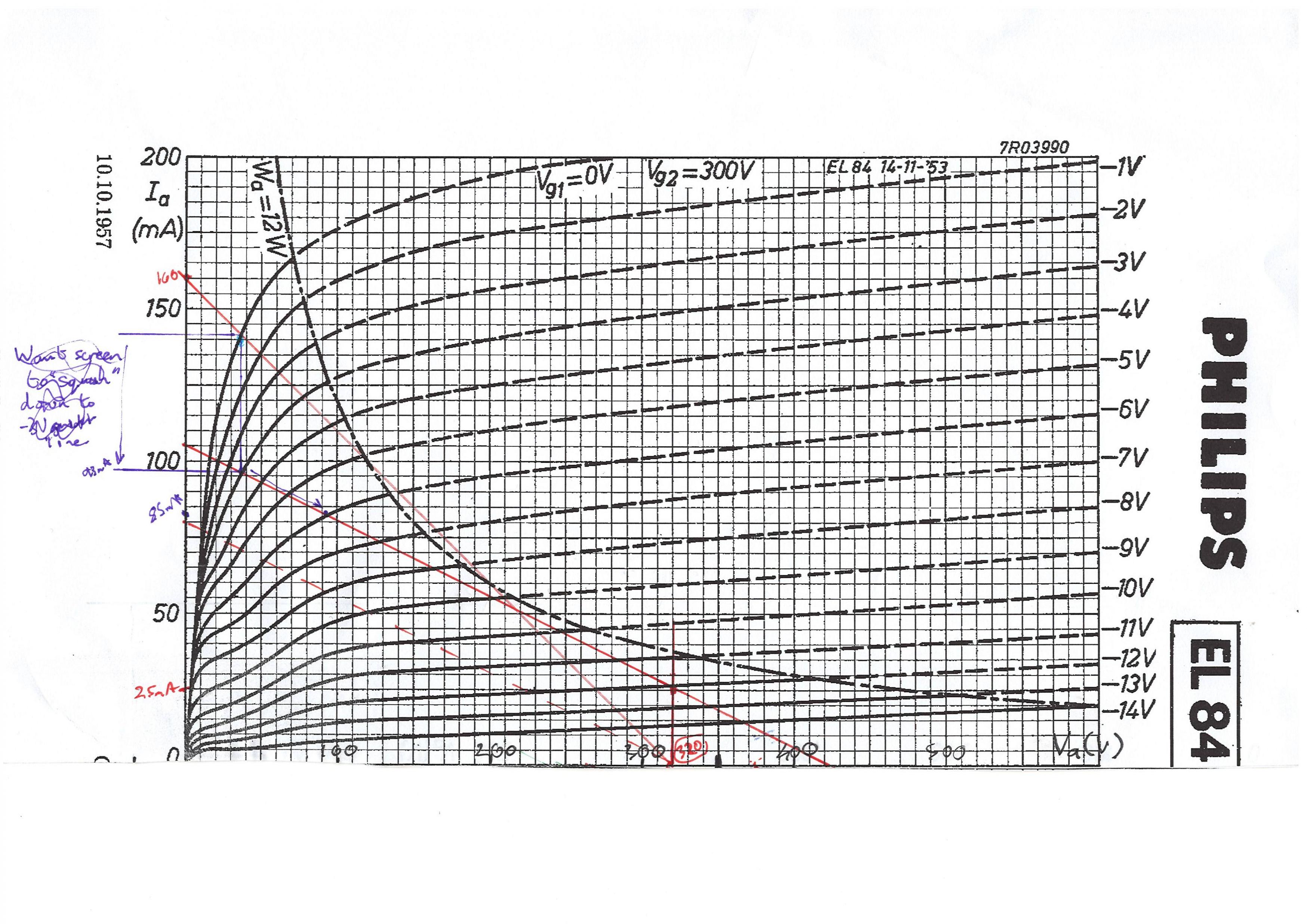

El Sid, go look at the complete Mullard Valve data for EL84 (some 12+ pages). There you will find many characteristic graphs for a great many applications. Do note how the distortion varies.
One further effect (graphs for this allso given in complete EL84 data sheets): This is the so-called 'musical output' conditions (Warning: NOT to be confused with the PMPO nonsense!!) In these comparatively high capacitor values are used. The logic is that under typical musical conditions (low mark-space ratio, i.e. comparatively long low-signal periods between peak demands), large enough filter caps give a close semblance to fixed bias conditions most of the time.
Again going to relevant data sheets, it is shown that some 20% higher maximum output is available and at reduced distortion. (Apology for not showing dada sheets here; my copies are worn and creased from decades of use. Not from any periodical; my workplace subscribed to separate data sheet folders from manufacturers.)
I have often done this. Noticable difference very small, still. {By high values I mean power dc. caps of some 470µF - 2200 µF. I also regularly used cathode bypass caps of several thousand µF.

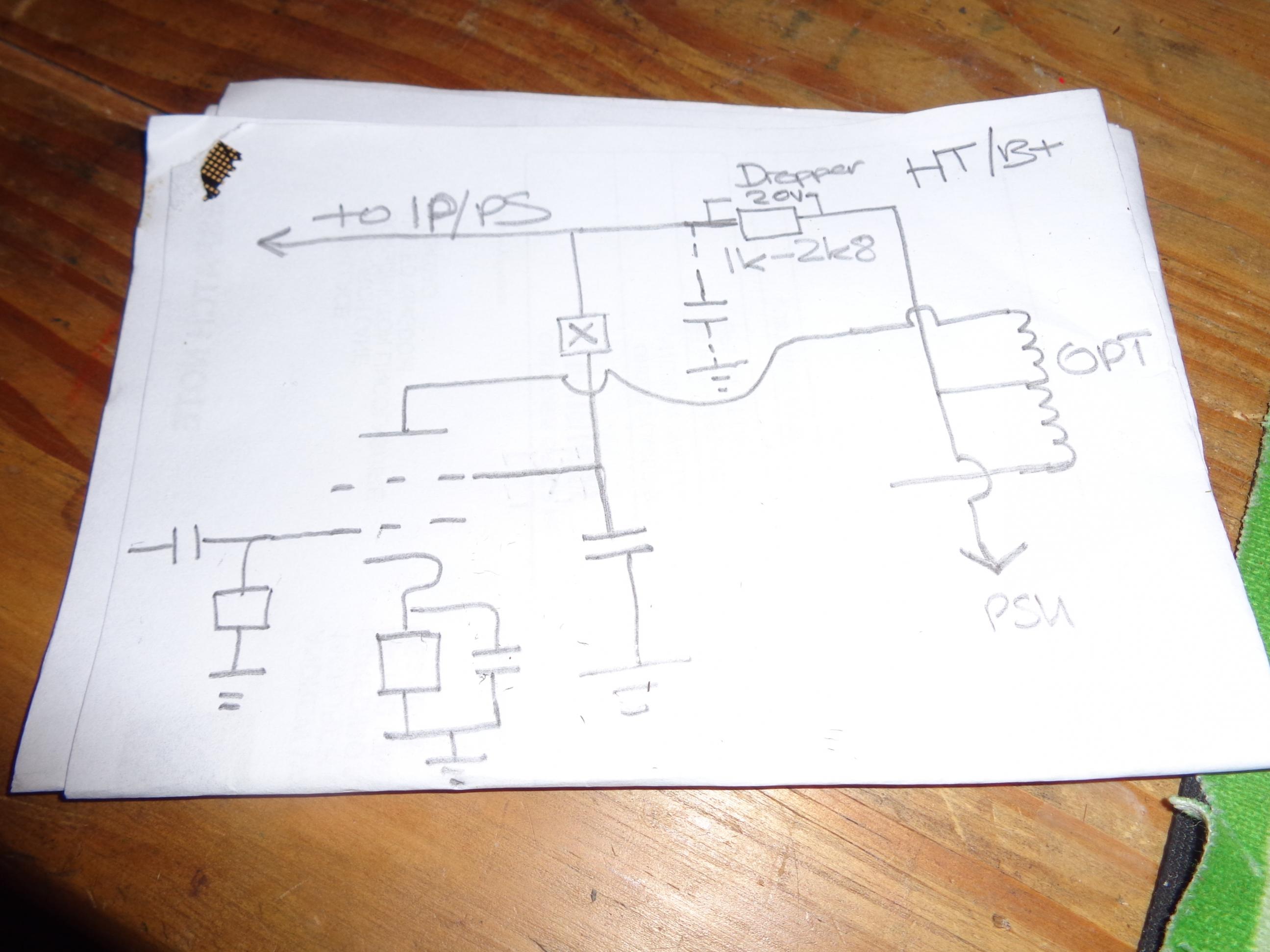

JM you are indeed right, so what I am trying to do first is decide a) where to supply the g2 from, b) what the supply circuit will look like R, RC, RCR, etc, and finally the values.
Dankie Oom. Unfortunately I don't have the very detailed data sheets you do. I have the below graph for distortion in a PP application with Va and Vg2 around the voltages I have in mind. One question I have about high cap values, because I have thought about it, is when you are powering up and have high caps all over the place, may you not potentially have a very high current on startup as all these caps charge?

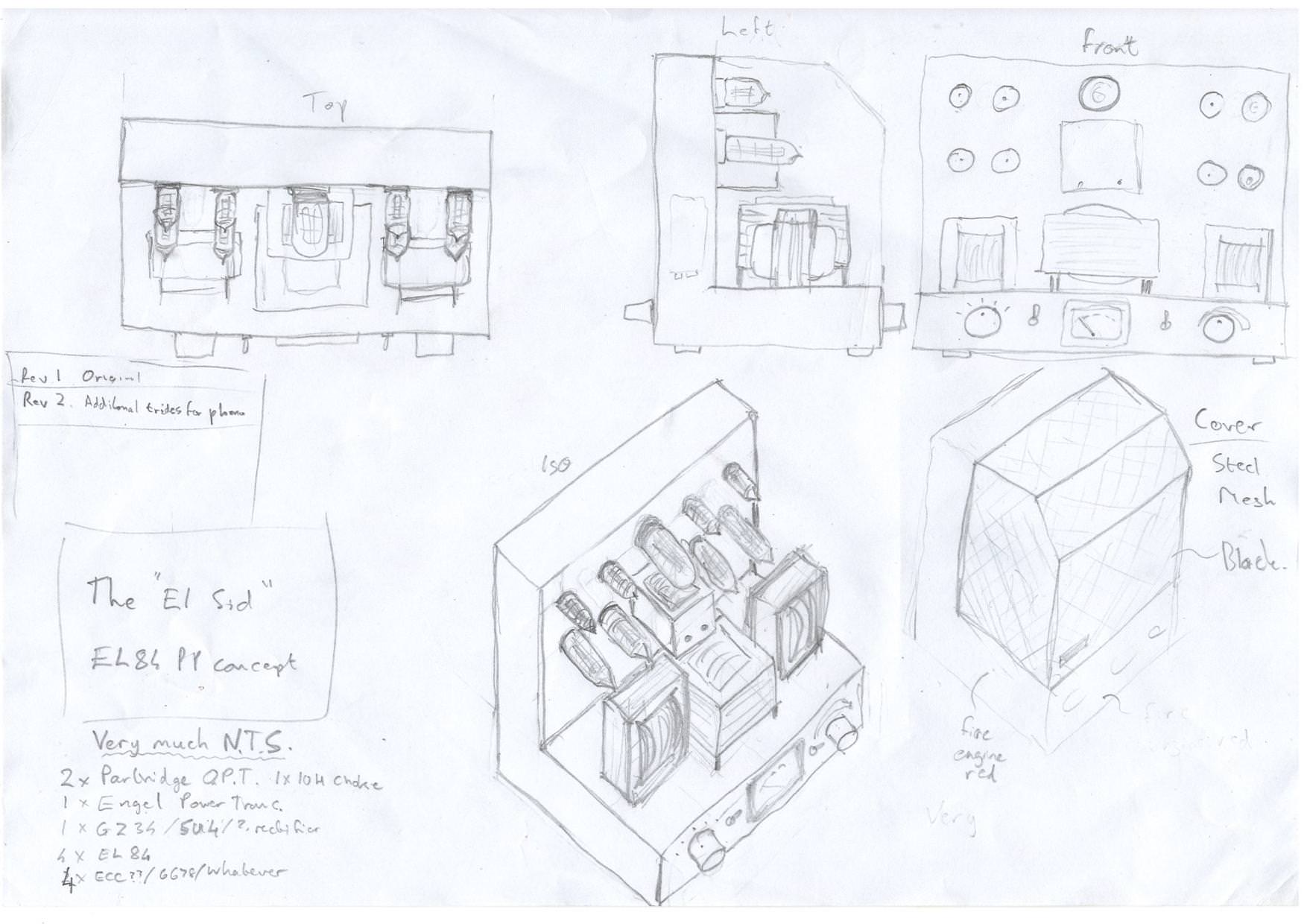

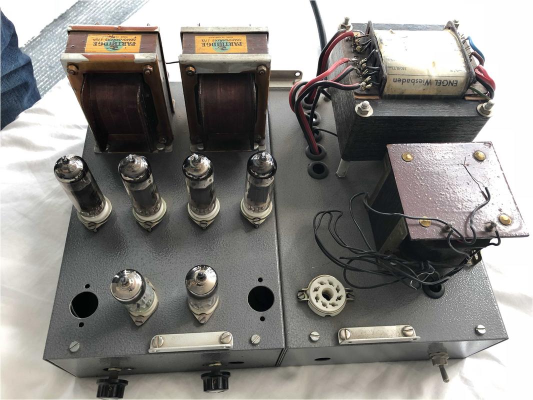

This project stalled a bit while i've been busy with the electrical design and work, life etc. I needed a bit of a break from thinking, so decided to make the prototype enclosure using bits and pieces of the exsting amp.
I dismantled this....
....and after much measuring, calculating, sawing, drilling, screwing and cursing, ended up with this:
Even as a rough prototype, I am pleased with how it looks. Already I have ideas for some improvements. As in the concept drawing, the base will be the same width as the top.
The power transformer will be inverted so the wires aren't exposed at the top and go through the base directly. As it stands the core is aligned with the OPTs so will rotate it. I originally wanted to show the maker's name but that's not sensible.
Unfortunately the insides are not yet populated
Well it's a year later 😡, and I've finally got some time to work on this again. All the external components have now been wired into the interior. I used some spare corrugated cable sleeve I had lying around (left over from installing a reverse camera on my car) to cover the wiring and look "industrial", as well as keep poking fingers away from the transformer terminals.
Next up is putting the power supply caps and resistors onto a piece of veroboard I'll attach to the screws holding the choke and wire that up.
I did make a cage for it it a few months back from some old wire mesh I had lying around outside:
