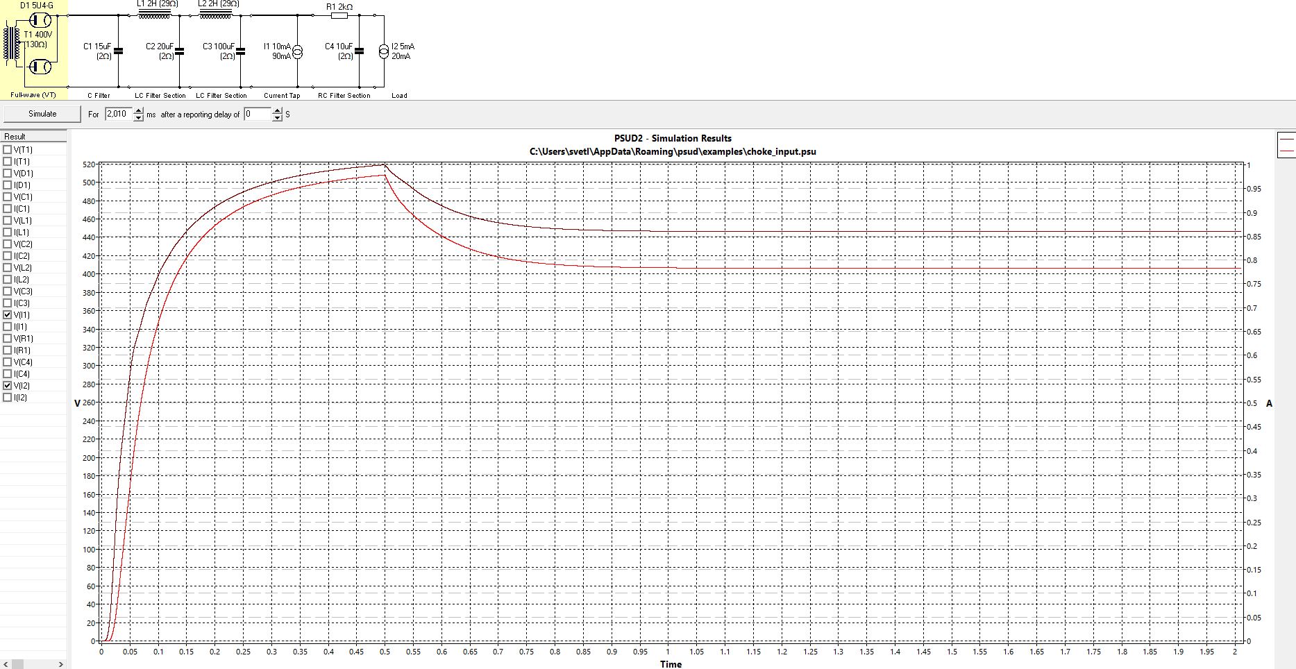

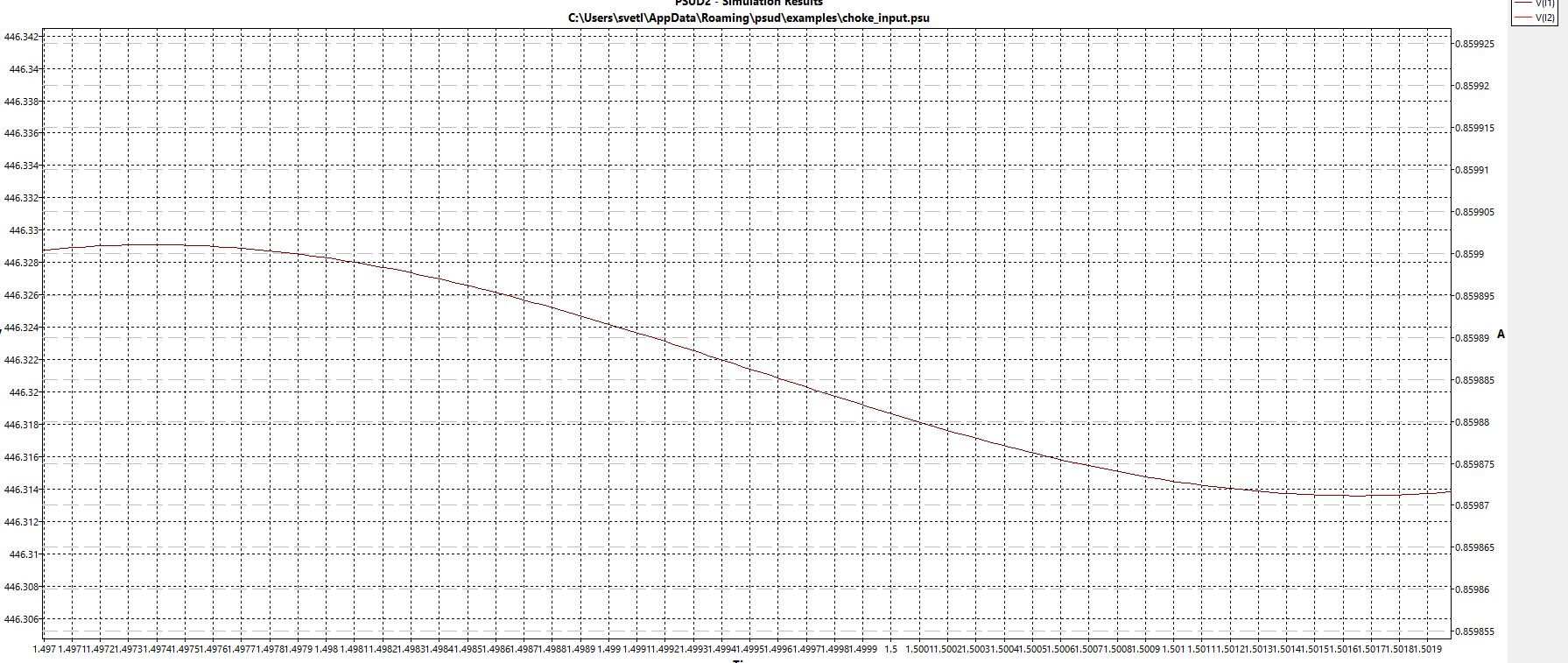

So i know i have posted a few threads on here and jump around a bit on what my next project will be. But here is the final one. It will be a KT120 SE UL with switchable triode / UL and switchable feedback 0,3,6db . The KT120 will be run at 400v, 105mA, and 3.75K load. Cathode bias. The EL84 driver tube will be run at 400v, 8K load, 200vp, 150v screen, 25mA. The driver will have diode / LED bias and also a unbypassed resistor for global neg feedback. The feedback is taken from the secondary of the OPT.

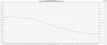

All iron is Edcor. Dual mono blocks. 400-0-400 / 200mA power transformer. 2x 2H/29ohm chokes per channel. See attached images. One is just the power supply (mono bloc), the other is ripple for the output stage. The PS caps will be ASC oil caps. 5U4 rectifier tubes. Any good places to get the ASC caps? Allied?
Power output will be approx 10W triode, 20W UL (only according to online sims).
Could you look at the Power Supply sim and let me know if there is any glaring issues? Thank you!

KT120 load? i simulated 3.75K vs 5K and wondering whether i should go with the 5K load. A little less power output but distortion drops. Thoughts?
No glaring issues, nice project, a little off mainstream with EL84 as a driver, go for it! Do run the KT120 in a similar fashion since quite a while, 460V@110mA on 3k5, driven by a C3M pentode. Still one of my favorite amps indeed!
