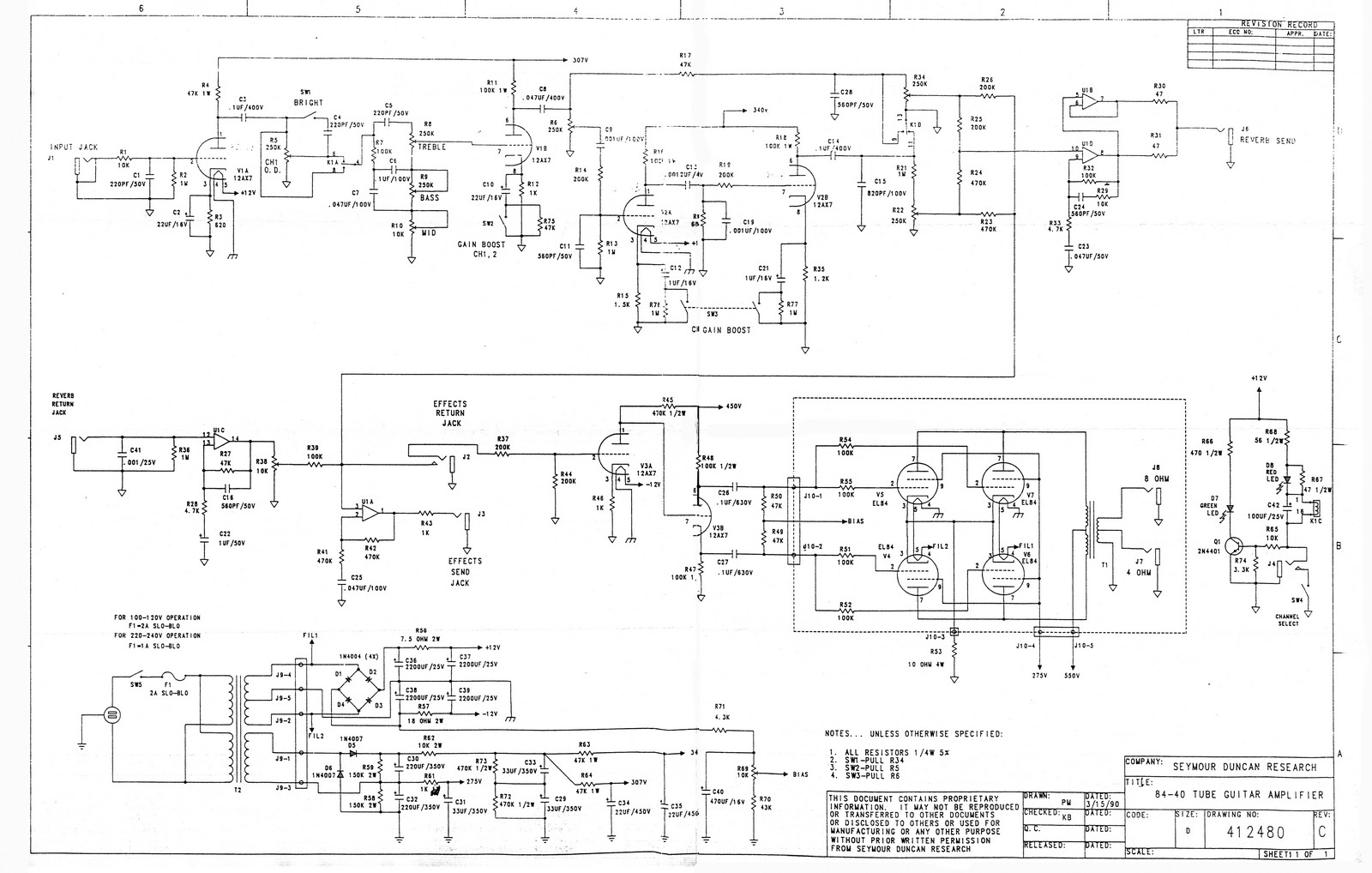

In this guitar amp.("Seymour Duncan" model 84-40) with 4xEL84 is Ua=550V and Ug2=275V!
At last service I build in 4xEL84 "JJ"-brand, and work good last ~2 year!
