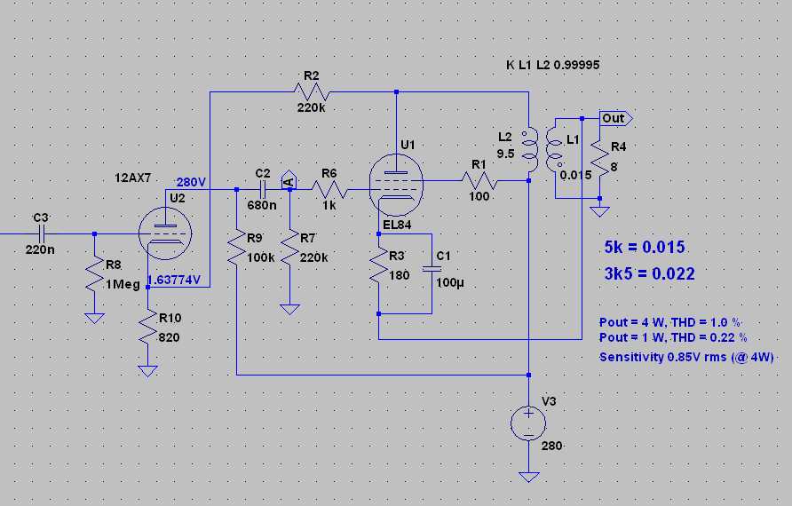

...Why use a high gain triode when high gain is not needed ?
EL84 SE as UL or triode connected requires some 6.5 Vrms drive for full output power,
which in case of triode is some 1.5 W and in case of UL some 4 W.

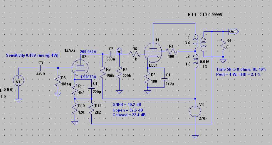

If one accepts an amplifier without GNFB ( and high THD) and some 1 Vrms sensitivity is OK, then the gain of 1st stage should be about 16 dB minimum. So one ECC82 would be sufficient is this case.
If some moderate amount (~10 dB) of GNFB is used and the required sensitivity is less than 0.5 Vrms, then the gain of the 1st stage needs to be minimum 32 dB. Now ECC83 is a right choice.
Below is one example of well considered version with UL-output stage.
Some distortion cancelling takes place at the voltage amplifier (12AX7), the GNFB is 10 dB, Pout = 4 W, THD is some 2% and sensitivity is just below .5 Vrms.

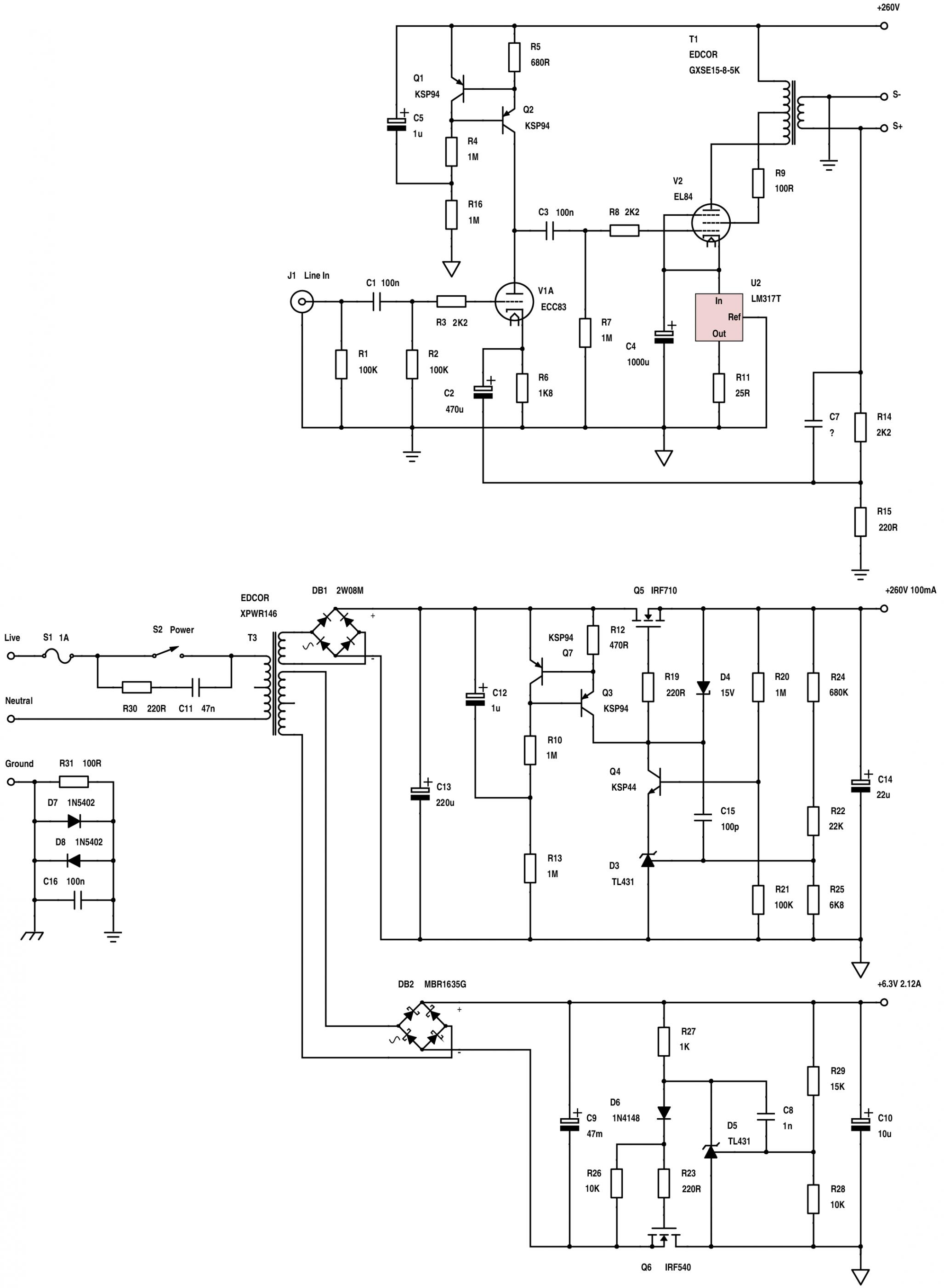

Try this circuit, I'm currently building it at the moment. I reckon it'll give the best performance of any EL84 SE design out there 😛.
It uses the an ultra-linear EDCOR output transformer. You can buy them at their site for a very reasonable price and they ship worldwide. They also look pretty cool 😉.
