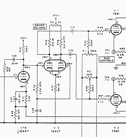

Better balanced condition as understand differential amp works more self adjusting due to those 'pseudo constant current tail resistor'. Noise supression is not a concern for my application. For this reason my initial question was - differential amp or regular gain stages with independent adjustment function ? and which are the differences in between ? First I noted from the answers the perfect balance it is not so much a concern. Second it was provided a simple way how to implement a differential solution. So now I understand a little bit I can try by myself and let you know my subjective conclusion. Thanks. Catalin
PS. my amp run pretty well with those 220 ohm in the cathodesame. It is just a opprtunity to learn something new and to see if I can improve some.

Hello. found some similar into mcintosh ma 230 power stage. AC balance pot over the driver stage plate load. but big common resistor in cathode for differential mode.
I can elevate the cathodes till 100v from the ground.that is max acceptable cathode to heater voltage for el84. biased related to cathodyne 80-85v and direct coupling. That.s enough ecart and input voltage will not overpass swinging capability of el84 even I will supply at 460v. Then 1k pot between driver plates to adjust the AC balance. That means 10 percent. I.m not sure what kind of pot to use there to be safe.
What do you think.it worth? Thanks
That is not a driver stage. It is a DC coupled Long-Tailed pair phase inverter.
See attachment.

Your circuit has essentially different topology, i.e. cathodyne phase splitter followed by a common cathode dual amplifier/driver.

Can I add a little bit NFB (say 6-10db) in the end of driver stage, please? The amp did not work so well in bass with all loudspeakers I have even with UL connection so I can consider to raise the damping factor a bit. Please let me know if I can inject some NFB in point 4 in driver stage ? Thanks.
It is not clear to me if I can apply nfb into common cathode resistor of differential driver stage or should I apply diferential nfb into separate cathode resistors?that means no diferential driver amp anymore...My first option is to place nfb into differential cathode common resistor but I.m mot sure if this stage can manage nfb...can you help me please?
