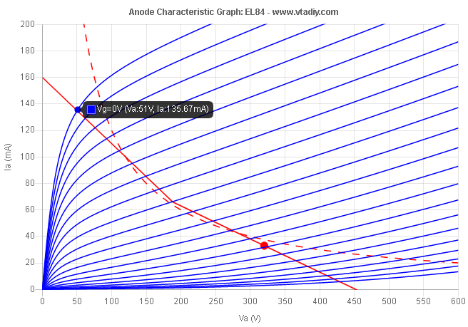

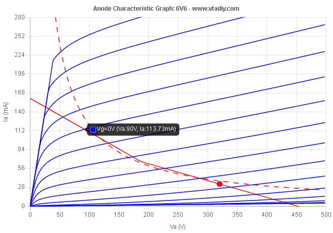

In attachment there are the two loadlines, both tubes with 320 V, 23%UL, 33 mA at idle and 8 kOhm Raa.
6V6s alone would contribute with:
4.3 W in class A
13 W in class AB1
around 20 W in class AB2 (at g1=+10V)
Va = 90 V when g1=0
Ia = 114 mA when g1=0
g1 at idle = -23 V
EL84s alone would contribute with:
4.3 W in class A
18 W in class AB1
Va = 51 V when g1=0
Ia = 136 mA when g1=0
g1 at idle = -13 V
So if I swing the 6V6 with 23 Vp, I need a voltage divider of 13/23 = 0.565 times to fully drive the EL84s, like a 47 kOhm + 10 kOhm to ground. This will increase the EL84's g1 voltage reference too, stabilizing the bias.
I would say that the combination of the two different pairs in parallel will cross the g1=0 curve at around 70 V and 250 mA.
Now, imagine that we want to make the 6V6 work with 10 kOhm Raa and the EL84 with 8 kOhm.
Is it correct to say that, with previous data, I can have a primary of 4 kOhm Raa where I connect the EL84s, and then 2 kOhm more for the 6V6s anodes?

To your last question: I guess so.

How come there's a kink in the loadlines?
It's the transition from tubes conducting 100% of the time (plotted as Raa/2) and tubes off for part of the cycle (plotted as Raa/4).
