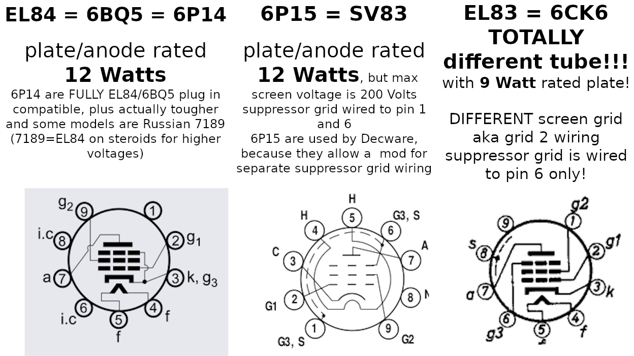

Just an extended FYI here, because I had a lot of head shaking reactions about these:
EL84/6BQ5/6P14 (type 1) vs 6P15/SV83 (type 2) vs EL83 (type 3)
AND NO, the 6P1 is not an EL84 type at all, with completely different pinout, and it has been mentioned that it is more like a 9-pin mini version of 6V6, similar to 6AQ5/EL90.
A lot of sellers especially mix up EL83 and SV83/6P15 all the time, which are completely different beasties!
"equivalent" means you can build something similar with a piece, but it is NOT the same and you CANNOT "roll" an equivalent type into the old tube socket! You will likely cause expensive damage, and with the high voltages involved, you can zap yourself a Phyllis Diller hairdo in a split second.
There are three tube types, that often get confused, with potentially catastrophic results!
The three types are as follows:
* 1) EL84 also known as (aka) 6BQ5 aka 6P14 (many manufacturers)
* 2) 6P15 aka Svetlana83 (SV83)
* 3) EL83 aka 6CK6 (Philips, Mazda, Tesla, La Radiotechnique)
NOTE that the SV83 is NOT an EL83, these are totally different beasts!
1 and 2 are compatible, IF you modify your tube socket with a switch, jumper, a tube adapter, or the Hazen mod (0.1uF/400V cap between pin 3 on one cap lead and 1 or 6 on the other), but type 3 is NOT at all compatible with 1 and 2. EL83 requires rewiring, different bias, and power supply setup!
Here is why:
* 1 and 2, so EL84 and 6P15 anodes/plates are rated at 12 Watts.
* There are 3 grids in pentodes, one of which is the suppressor grid.
* In the EL84 types, the suppressor is tied to the cathode, so not even on a separate pin to the outside world of the tube.
* In the 6P15/SV83 types, the suppressor is not connected to anything inside of the tube, but tied to pin 1 and pin 6.
* In both the EL84 and 6P15/SV83, the screen grid (aka grid 2) is connected to pin 9 (keep that in mind)
* The actual EL83 (aka 6CK6) is NOT an EL84, and do NOT confuse it with an SV83, because its plate (or anode) is rated at 9-Watts, AND the suppressor is tied to pin 6 only, AND the screen grid is tied to pin 1, with pin 9 empty!
So, what happens, if you plug an SV83/6P15 into an EL84/5BQ5 amp? The missing suppressor connection may cause distortion, and maybe nothing catastrophic will happen. Hopefully your ears will tell you something is wrong, you turn it off, wait until the tube cools off, and you plug in your adaptor socket.
I simply made the Hazen mod, aka CCE Decware mod (Christmas comes early), with a 0.1uF cap between pin 3 (cathode) and pin 6(screen grid on 6P15/SV83) on my EL84 sockets. I can still use EL84, and the amp is now fully compatible for both EL84 and 6P15
What happens, if you plug an EL83 into an EL84 or SV83 amp?
You potentially get SMOKE, because that 9 Watt plate is overheating and everything is just off, but at the very least your tube, which you may have bought as an antique special for high dollars is most likely red-plated to meltdown and broken.

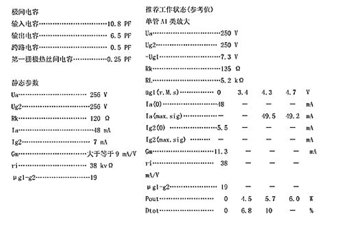

Shuguang 6P14P is similar to 6P14P from sovtek.

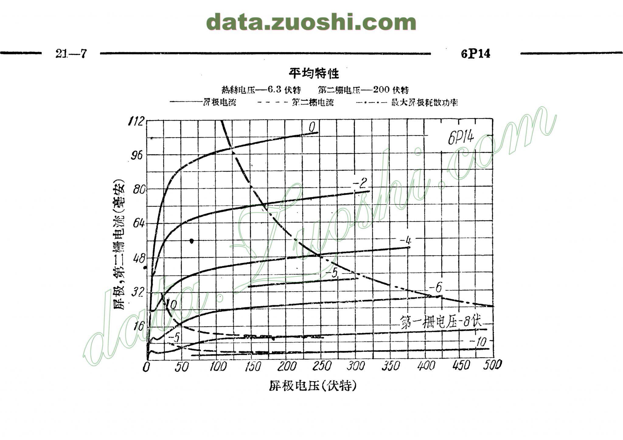

I'm looking for the exact spec sheet for the Chinese 6P14, not the Russian 6P14P, and not "similarity" because that is not the same as comparing actual specifications.
www.aliexp05005094963259.html?press.com/item/10dp_npi=2%40dis%21USD%21US%20%2423.39%21US%20%2421.05%21%21%21%21%21%400b89a67e16751466329662762e911c%2112000031637304471%21im

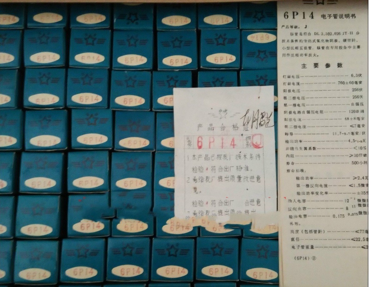

Also, I send a message to seller. Maybe will provide data sheet for 6P14.

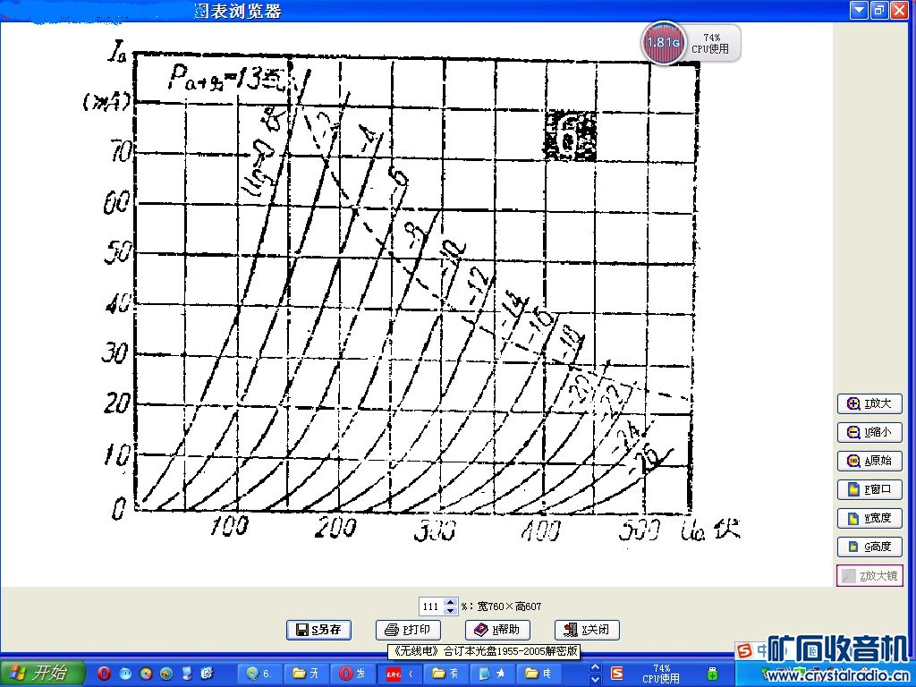

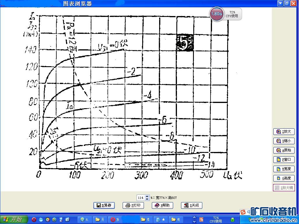

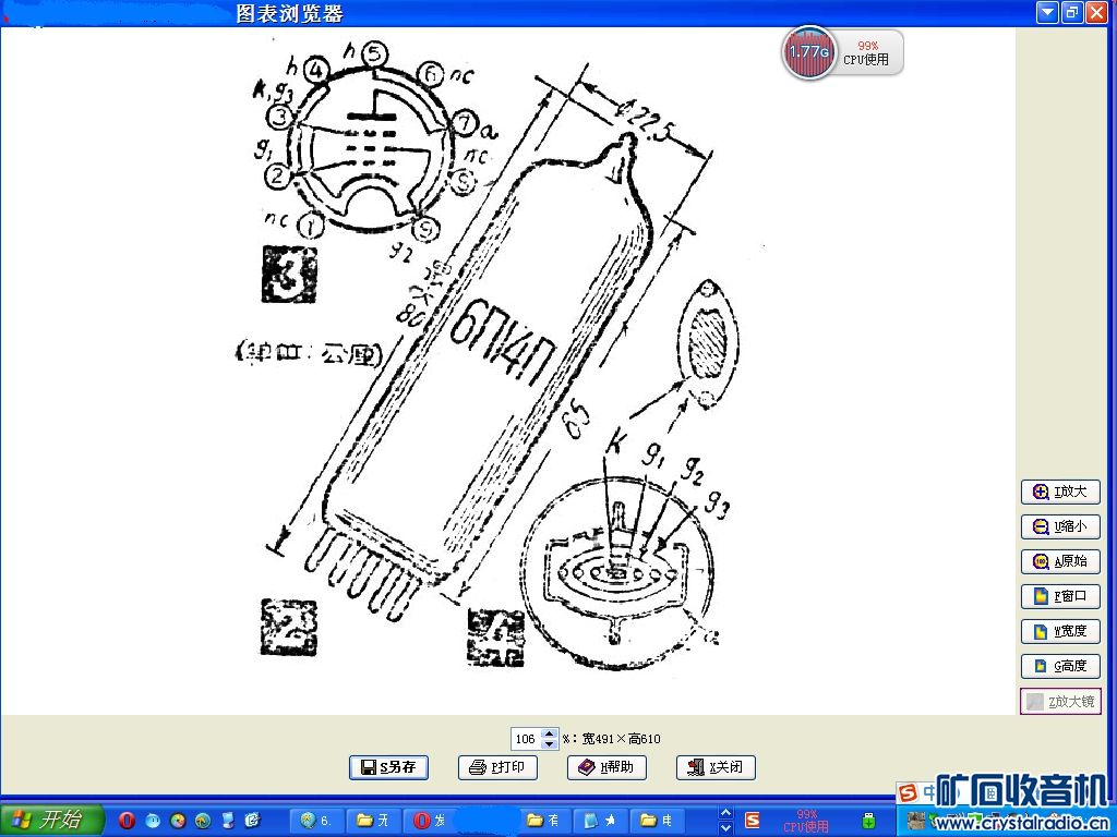

http://www.crystalradio.cn/thread-747904-1-1.html
http://www.crystalradio.cn/forum.php?mod=viewthread&tid=2054413&highlight=6P14%B5%E7%D7%D3%B9%DC
No pictures display with the translation?
That's for 6P14P, which is EL84/6BQ5 equivalent. Isn't the question, "How different is 6P14 from 6P15 from SV83 from EL83?"

That's for 6P14P, which is EL84/6BQ5 equivalent. Isn't the question ...

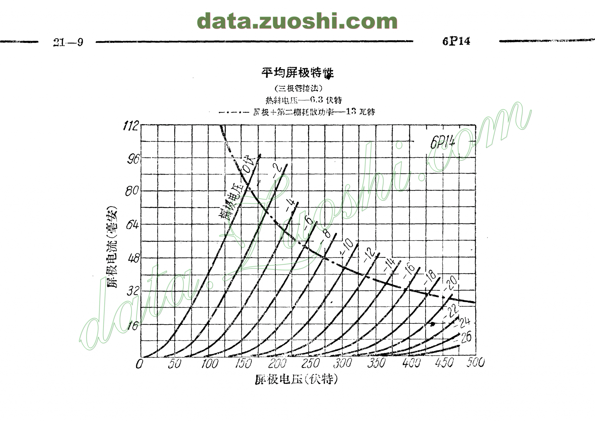

No, I'm looking for an actual spec sheet for the Chinese-made 6P14 and not the Russian-made 6P14P. I want to compare them directly.
The tube name is simply 6P14, as displayed below, the tube characteristics is clear enough to make model with:
https://www.sgss8.com/tpdq/20597853/
