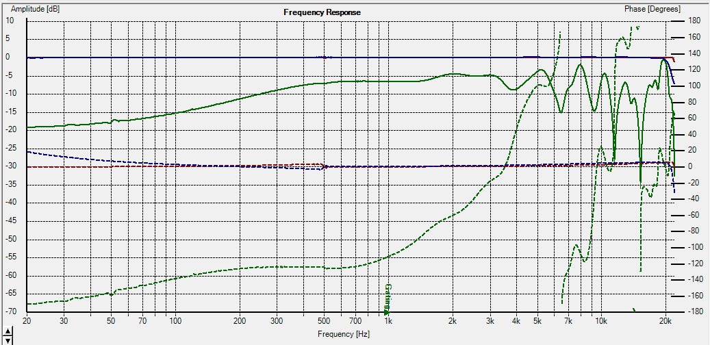

For what it's worth, this is the very first measurement I was ale to take of one of my EL70s in nearfield, a week ago. It looks like the gating was set at 1k for this, so under that is irrelevant, right?
At least I got something started. 😛
By nearfield you mean less than 1cm? If so, change the measurement to raw or 24db/Oct smoothing. Holm automatically sets the gate and it's usually way to high.
For farfield (>10cm) you'll have to set the gate. This takes some learning. I recently helped rpb over on techtalk put together a concise HolmImpulse tutorial. I'm on my phone, but you could try and Google it. He did a bang up job. The PCD stuff was me, he did the rest.
Overall though I can see a hint of similarity. Hard to say yet. And nearfield doesn't properly capture the upper frequencies since they difract off the frame/surround/cab/etc.
Good luck 🙂

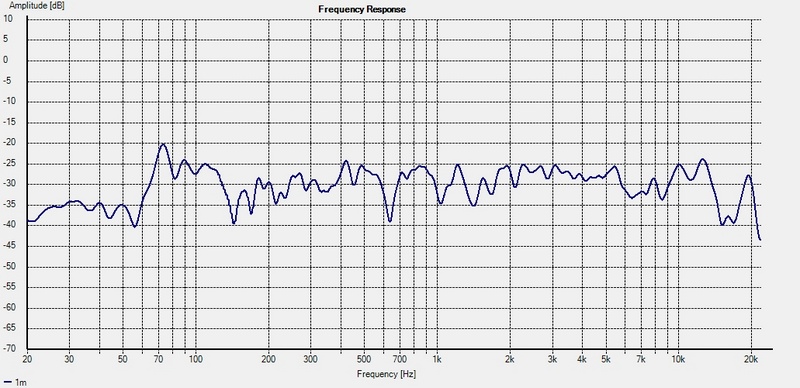

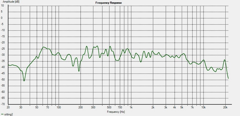

Here are a couple updated measurements.
Both are with 1/12 octave smoothing.
Blue is at 1 m on-axis, Green is at the seated position, ~2.5m and ~12 degrees off axis.

Thanks for adding Von. They look great. I'd suggest gating the impulse response on the 1m measurement. Take a close look at post #5 from that Holm tutorial thread. That'll help take out the reflections from the measurement, but limit the readability to around 300hz and above. Despite this I think I see the same 16khz suck out which is now 4 measurements to confirm it.
The seating position response is really cool to see. You can see how the top firing woofer really fills in the baffle step region. It also shows how the top droops. A very common full ranger "issue". Gives you a great idea of what the power response would look like.
That suck out just below 200hz might be floor bounce. Looks like your room is actually fairly modal free 🙂

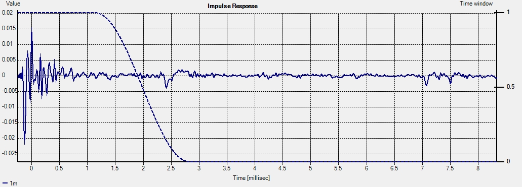

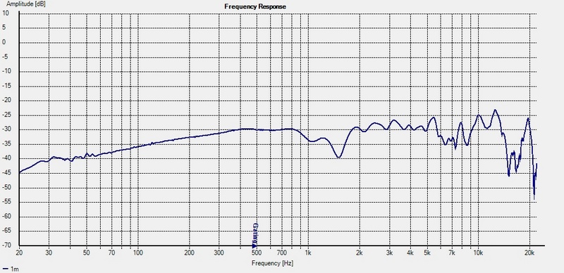

Thanks for your reply! The difficulty I had in trying to gate the response was that my impulse results were more ragged than expected.
Here is the attempt at a gated response.
Also as you've noted, there is a definite mode (or two) that I've been aware of when sitting on the couch. If I lean back, there seems to be more mid to upper bass (possibly even too much), but it's considerably lessened when I lean forward. The measurement was more in the forward position because of my hacked together mic boom. 😀

I see what you mean. You might have needed to turn up the volume. No biggie, the data is useful. The dip at 1500hz is probably still some contamination or reflection, but might be a cancellation from the top woofer. And that gate frequency is pretty high, making it not very useful below about 800hz. It would have helped to raise the speaker up, but that's a pain with a speaker like that.
The treble mountain range has similarities to my data.
It would be interesting if you measured at 10 and 20 degrees above axis to see what happens at 1500hz. If that swings in the vertical axis, then I'd suggest it's the upper woofer.
Not just for FRs. At the listening position in a normal room the curves will show a bit of droop at the highest frequencies.... if it is flat, then the speaker is likely too hot sounding.
To get a better idea of the response at the listener grid, and averaged measurement of each loudspeaker in a rectangular grid centred on the ears is suggested. John Atkinson details the grid he used in one of his posts... i'd suggest this a good standard to follow.
That's true. Rooms absorb those frequencies more easily. You don't feel FR'ers are more prone to it? Von's measurement looks like more of a droop than most room measurements. He was also off axis 12 degrees, so that might be why it looks like more than normal.
Something sweet going on here that is a "plus" for fullrangers, is the lack of a valley/mountain combo from 1000hz to 3000hz that a typical TM would give.

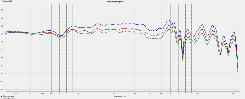

I brought these home into my livingroom a while ago and I've found the baffle losses noticable enough to prompt me to investigate baffle step compensation. I probably won't use any, but thought I'd share.
Blue is raw without filter.
Red is 0.72mH and 5ohms.
Green is 0.72mH and 6.8ohms.
The sweeps did sound much more flat. Probably would sound best with the 5ohms. Reminder that this is a 7" wide baffle. A wider baffle would probably want a .9mH or even a 1mH inductor.
If I get around to it, I'll listen to it like this.
