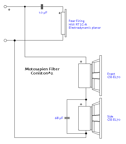

I would not fault the EL70 but perhaps the enclosure. My Coniston^2's sound wonderful with the bass being close to just right. They do improve in the highs after a few hundred hours. I also tapered the highs out of one driver with a 68 uF cap. After listening to them for some months, I switched back to my GR Research N2x's and I prefer the Conistons.

what you filtered out of one driver was the lows, not the highs.
That is not so. With drivers wired in series, you filter the highs out of one of the drivers (ie LP filter) by shunting it with a capacitor)
If you look at the diagram, at high frequencies the reactance of the cap across the EL70 goes to zero, so all the HF go thru the cap and not the EL70s. At low frequencies the reactance of the cap becomes very high so all the lows go thru the EL70.
dave
Note: in the end i believe the tweeter was removed.
I didn't realize he had shunted the cap; I assumed a series cap.

I found that the ribbon transducer made for a fierce sound so I do not recommend it with in this configuration (as shown in the schematic above). Sorry for the incomplete explanation of the wiring. I'm pushing mine with NAD SS BTW.
