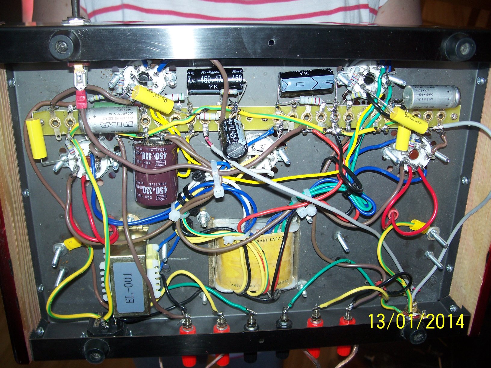

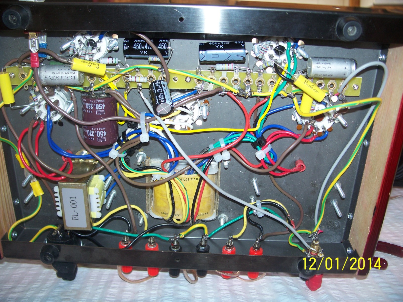

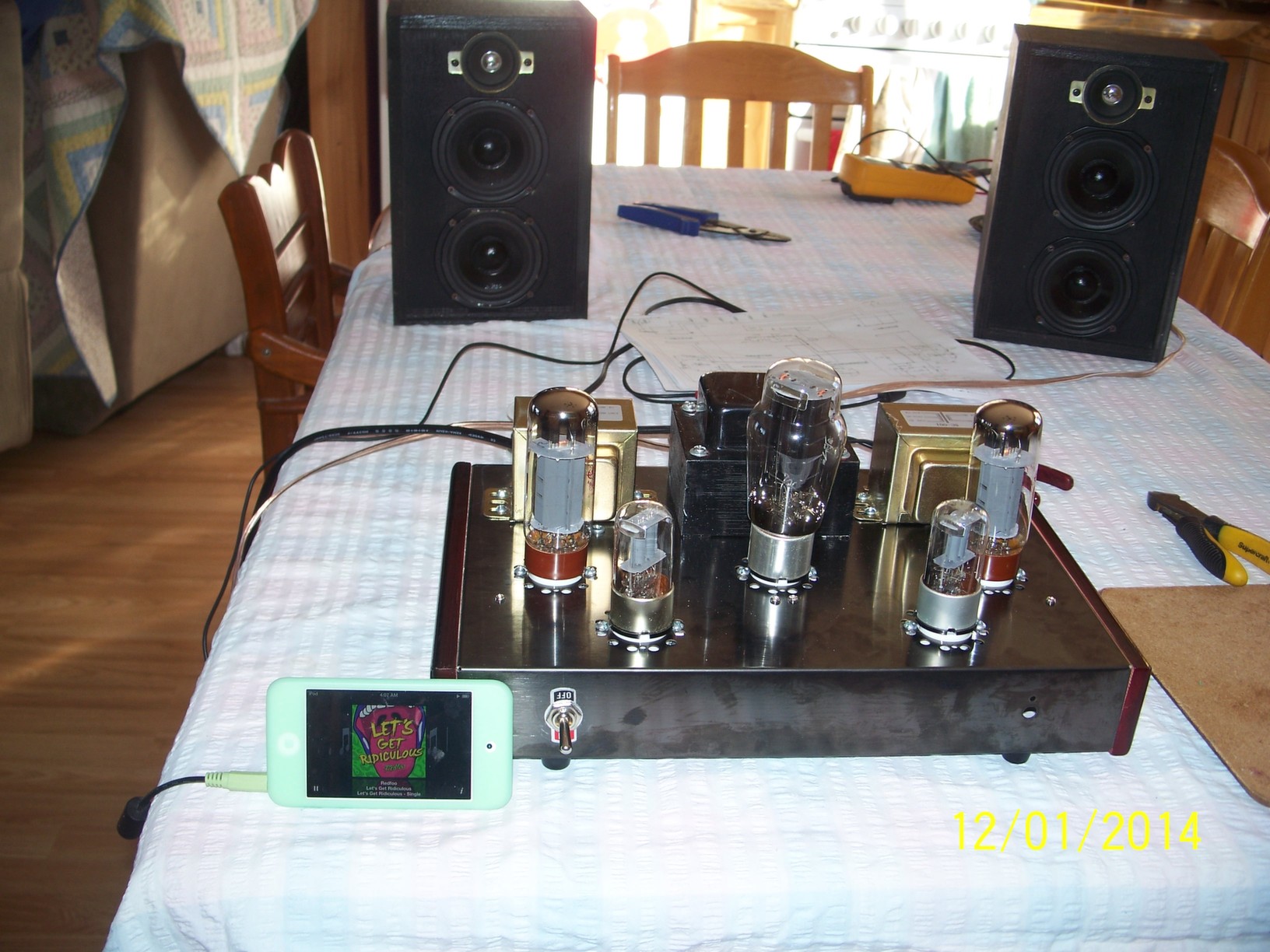

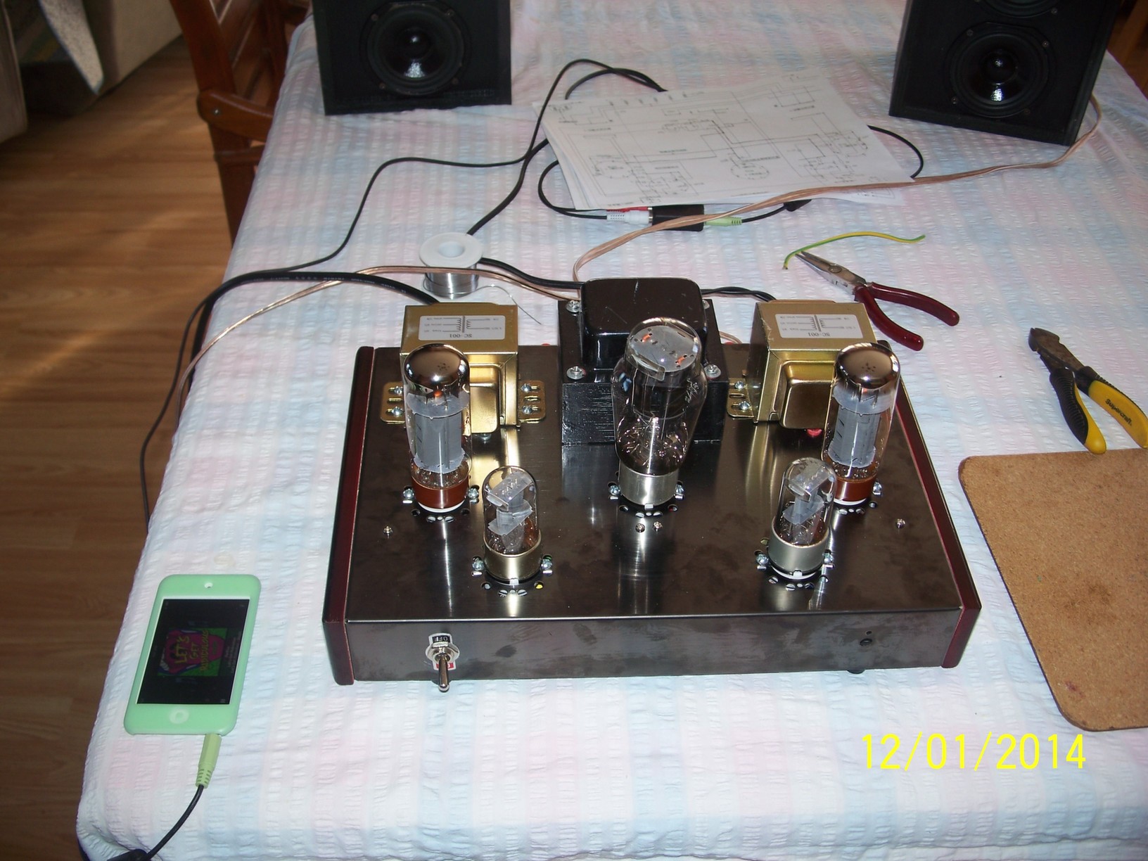

Got mine to work 100%
Hi Well I too brought this valve amp only late last year just got around to putting it together, wow not a bad little sound too. posted some pics of my DIY and very happy with it. hope you finally got yours to work and I had no parts left over lol which helps I guess
Well if anybody is still reading this blog forget this cheap chinese junk amps, I had trouble with this amp after I finished building it work ok but volume was very low, email the seller he sent me new schematics as the first one was misleading, lol rebuilt the amp to the second schematics switched on 10secs late bang smoke poured out blow all the caps and I say the valves and trannies are stuff as well. go spend your hard earn money on a better kit then this cheap chinese junk. just do a search and you will find so many different schematics to the same kit, which none to date have I seemn working 100%.

I purchased this Amplifier out of curiosity in July 2014 for a total of £203 plus 24% customs duty and Vat. ( 4.5% + 20%). I have run it for at least 8 hours a day since. In all honesty I was truthfully amazed at its sound, dynamics, and sound stage. I have used it with the following loudspeakers. Rega XEL transmission lines, TDL RTL3 Transmission Lines, and KEF C80s. The best speaker wire being a 1.5 Metre section of 3mm (7mm CSA) diameter enamelled copper wire in Nylon sleeves. With silver soldered 4mm plugs. The Amplifier fed either by a Technics slp 990 or Marantz 5004 CD player.
I noticed that both of these CD machines can output up to 3.5 volts whereas the Amplifiers input is stated at 500mv. I did notice on the Bass Synthesiser track 1 of American Beauty some overload distortion when the volume was past 1 O clock. So I utilised a QED CD attenuator. Problem solved.
This Amplifier sounds as good if not better than my Audio innovations 300 Mark 2 4 x ECL 86 and my Quad 34/405.
