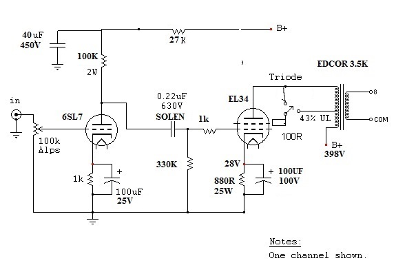

Hi guys, what do you think of the circuit? Does the power tube cathode resistor 880k is too high. The bias amp is at 32ma if based on 28v. Thanks for reply.
Ok. Noted with thanks. What about triode and UL connections. Any issue??You need 390 Ohms to 470 Ohms for proper operating point (Ik~60-70mA).
That means I have 2x100 ohms resistor? Any illustration? Thank you.100 Ohms resistor solder directly to screen (G2; pin 4 at socket).
ok I guess I know what you mean. So connect 100ohm to screen. Both UL and triode mode will have 100 ohms connected to screen when you switch to either one.No two resistors, only one, but directly solder to screen!

ok built the amp from schematics and do not like the sound I did replace the 6SL7 with 6SN7 may have made the sound better if I used 6SL7 but not alot of gain very flat. I think I would go for a better schematics then this but only my opinion
...do not like the sound I did replace the 6SL7 with 6SN7 may have made the sound better...
The non-linearities (=distortion) are created at the output stage, not at the voltage amplifying stage 6SL7.
Therefore it is obvious that changing 6SL7 to 6SN7 is not a solution.
That circuit can be improved a lot by applying negative feedback from the speaker output to the cathode of 6SL7.
At the same time frequency response, damping factor and signal to hum ratio is improved.

I will try the feedback to see if that changes the sound, I have brand new 6SN7 coming so I will try new ones to see if the old 6SN7 I have are no good too old. I have 6N9P that it is said a straight replacement for 6SL7 and I tried as well and got a higher gain but a bit of distortion at high volume.
Below is an example where some 6 dB of GNFB is added to triode connected output stage.
So you only need to add resistors R14 and R11 to your existing circuit.
This will halve the THD.

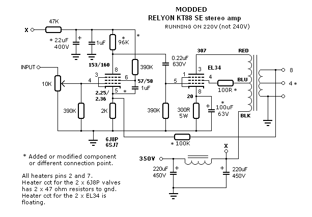

I will try the things you say to do today and then I will build this one as I have 6SJ7 Metal valves as well and see which one is better I'm liking the schematic of the 6SJ7 as I like the sound I will change the 100R on the output tube on pin 4 to 1k and wire it to pin 3 and the input volume will be 100k A pot
Ok built the amp from schematics above had to mod a few parts so I could use 6N3C as well as I can use EL34 power tubes seems to have a good sound, I got rid of feedback didn't make any difference I tried the 6SL7 EL34 from schematics on page 1 but just didn't like the output was low and damp. I hope others have better luck them me on the 6SL7!! 🙂

hello ,
the potentiometer is very slow ! 10 K , not use 47 K or 100 K ?
and not grid stop to G1 in EL 34 ?
