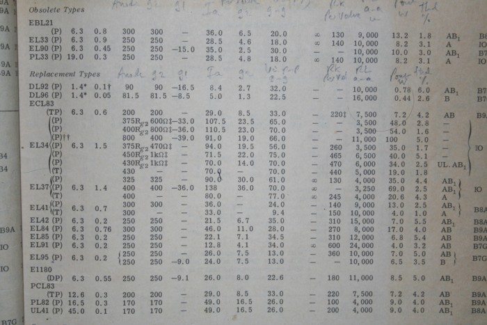

Load impedances for EL34 become very confusing with changes in topology, biasing methods, operating point and class of operation - just look at this table of possible EL34 applications from Duncan Amps!. For some reason, the Duncan Amps table shows Vg2 being higher than Va in many instances, which I think is a misprint.
Mullard didn't give any recommendation on the optimum load for EL34 UL PP with fixed bias, and neither did any other manufacturer to my knowledge. The only data sheets I've seen for UL are about cathode bias (usually 6.6k P-P). I've seen the odd mention of lower impedances with fixed bias from other sources, like 4.5k P-P, but nothing that was very authoritative or clear. Claus Byrith, in his adaptation of the Mullard 5-20 from cathode bias to fixed bias, ignored the issue. He did use a lower load impedance but only because he had to choose a transformer from Lundahl.
I very rapidly checked my previous entry! ... Not quite but I may have given the wrong impression. I did in fact not get the idea of a preferred operation from the Mullard EL34 data sheets themselves but from a publication or two. I think the original 520 design article (by a Mullard designer) gave that idea for low (lowest?) distortion, but don't have it at hand now. But yes, there is not a single optimum point - as there is not for other tubes.
[As an aside, sometimes expression of distortion as a % instead of a signal level can also be misleading (not specifically EL34). Percentage is of the maximum output, not signal voltage. Comparing triode and pentode operation, UL might show a higher % but actually be lower than for triode, while also still having some more headroom, while triode runs out of steam. Just an observation.]
Johan Potgieter said:...Percentage is of the maximum output, not signal voltage. Comparing triode and pentode operation, UL might show a higher % but actually be lower than for triode, while also still having some more headroom, while triode runs out of steam. Just an observation..
this is exactly what I was thinking. In the end it really matters how much power your speaker needs. If you (and your speakers) can make do with about 6-8W then triode is an obvious choice, if however you (and your speakers) "need" 15W or so then A-B UL would make most sense. If you need more than 20W it would make more sense to consider another tube (6550, KT88, etc..) instead of pushing the EL34 to their limits.

Something else I've often wondered: why are the given bias voltages so low.
The datasheets for Class A SE are around -12 or -14, which I understand well enough, but for A/B PP (UL) they often give something between about -35V to -40V.
All the EL34 datasheets I've come across [incl. Mullard] have pentode curves which go as low as -25V, sometimes -30V. For A/B where you want a liiiitttle bit of overlap, something like -25V or -28V seems more reasonable?
Is this a result of the U/L connection pulling the curves "up" the graph or something? :s
Or are they referring to A/B in triode mode (in which case the datasheets go down to around -35, and from looking at the Mullard, -40V could fit on too)
Ta
Ta
If you look at the recommended plate voltage and current in each case, you'll see why that is.The datasheets for Class A SE are around -12 or -14, which I understand well enough, but for A/B PP (UL) they often give something between about -35V to -40V.
SE has to be Class A, which needs an operating point with low plate voltage with high quiescent plate current. That means low bias voltage.
Class AB can use a much higher plate voltage, because its quiescent current is low. That requires a higher bias voltage.
