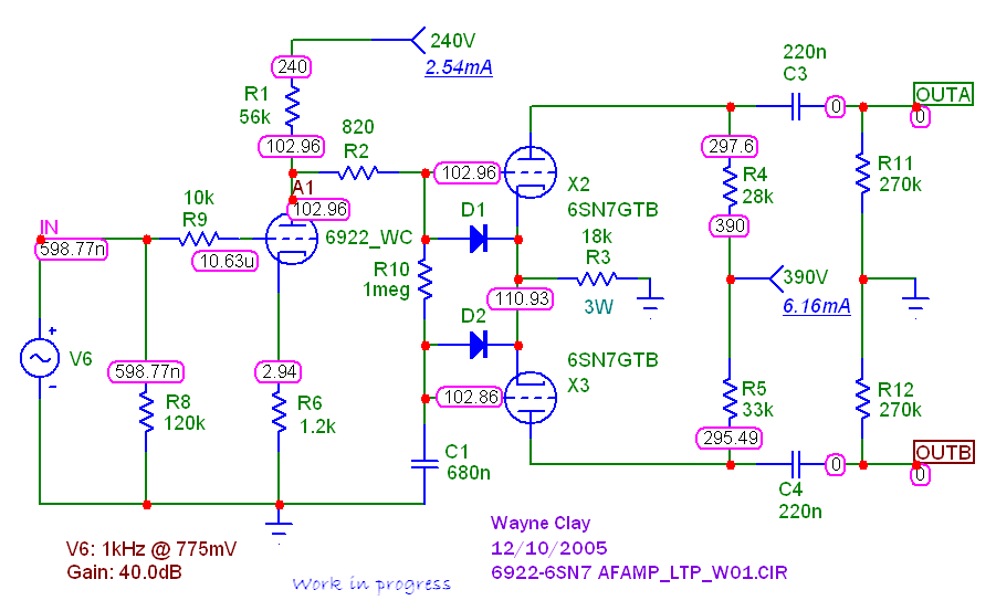

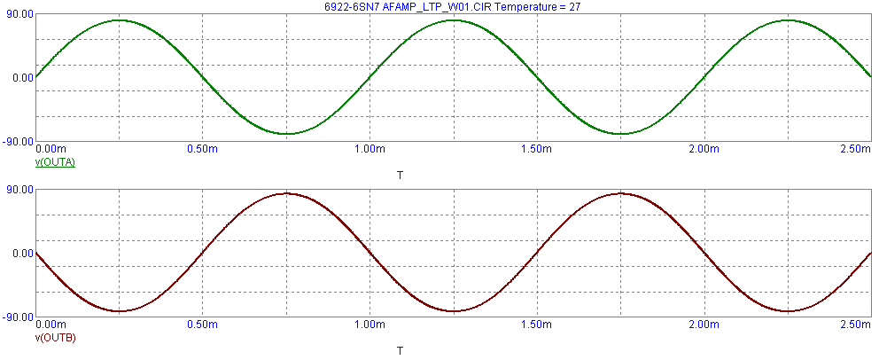

As promised I'm posting a 6DJ8/6922 input and a 6SN7 LTP. Very similar to the Eico circuit(s). Jax has a 6J5/6SN7 driver-amp posted somewhere here on this forum. Very similar to the one I'm posting here.
I've simmed this and there is plenty of drive here for an PP EL34 or 6L6GC etc.

cogsncogs said:
I like the (Eico) AF Amp/LTP splitter configuration. Since you have an octal there (6SN7) why not use another octal like a 6SL7? shhh ;) , it's closer to a 5751 than a 12AX7. That's what I would do but hey it's your amp!

the reason i am thinking of using the ECC88C as the driver is that the gain of the ECC88C allows me to use it as a high pass or low pass filter. this simplfies the circuit. and a simpler circuit that requires fewer parts should sound better.
so in the present design the ECC88C filter/driver will be follwoed by the 6SN7 and then the EL34. I know that the ECC88C is a 9 pin whilst the others are 8pin. I dont know if there is a 8 pin tube that can be used a filter driver in this sort of circuit.
A possible arrangement for the input is to use a double triode in cascode as the ECC88 at the place of the EF86. The advantage is at you would get less noise and still have the same high output impedance and high bandwitch as with the pentode.

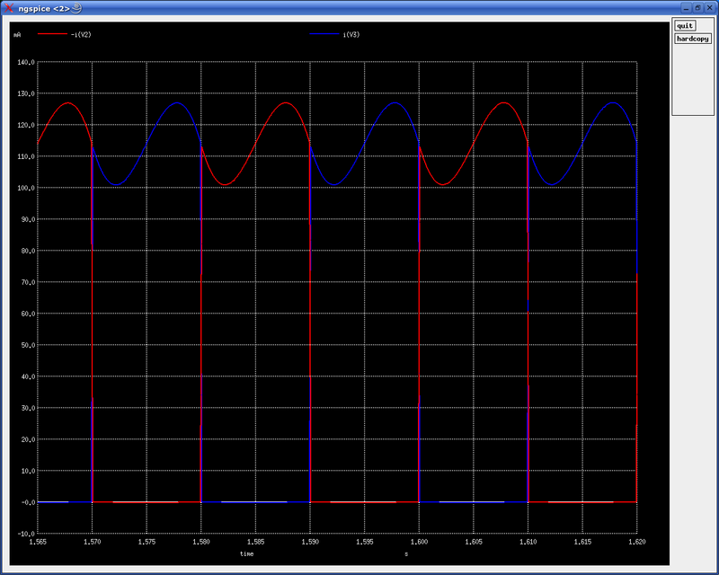

Is it thrue for the diode too. Here is a simulation where we can see the combination of the current of each diode in the valve (GZ34) for a double alternance power supply. The result on the condensator is almost a sinus. Very easy to cancel out. The other noises of the valve as the thermal noise are much easier to cancel out as the noise of a solid state diode.

How about this idea....
take Steve Bench's filter using 6DJ8 (ECC88C) then driving the 6SN7 in the HIF 87 ckt and the 6SN7 feeds the EL34.
this would really involve only 2 ECC88C one for left and one for right channel.
each ECC88C would drive 2 6SN7 and each 6SN7 would drive 2 EL34 PP. There would be no need for the ECC83.
What do you guys think of the EICO HIF 87 ckt and this idea?

Johan Potgieter said:
A Schmitt phase inverter is just the first user's name for the long-tailed pair. Top triode fed, cathodes connected together and earthed through a large resistor, bottom triode G1 earthed through a capacitor. (Sorry that I am unable to append a diagram now). This is what the 6SN7/other twin-triode is doing in your Leak circuit.
i think the HIF 87 also has the same schmitt trigger right?
Schmitt invertor- a Schmitt trigger is a very different thing. The 6SN7 is indeed in the Schmitt invertor configuration (much more commonly called a long tail pair or a differential amplifier).
The main issue with your idea is gain- or lack thereof. You're replacing a gain block with a gain of roughly 50-60 with one of unity gain. I'd keep the input circuit as is and just add the filter as a separate stage.
