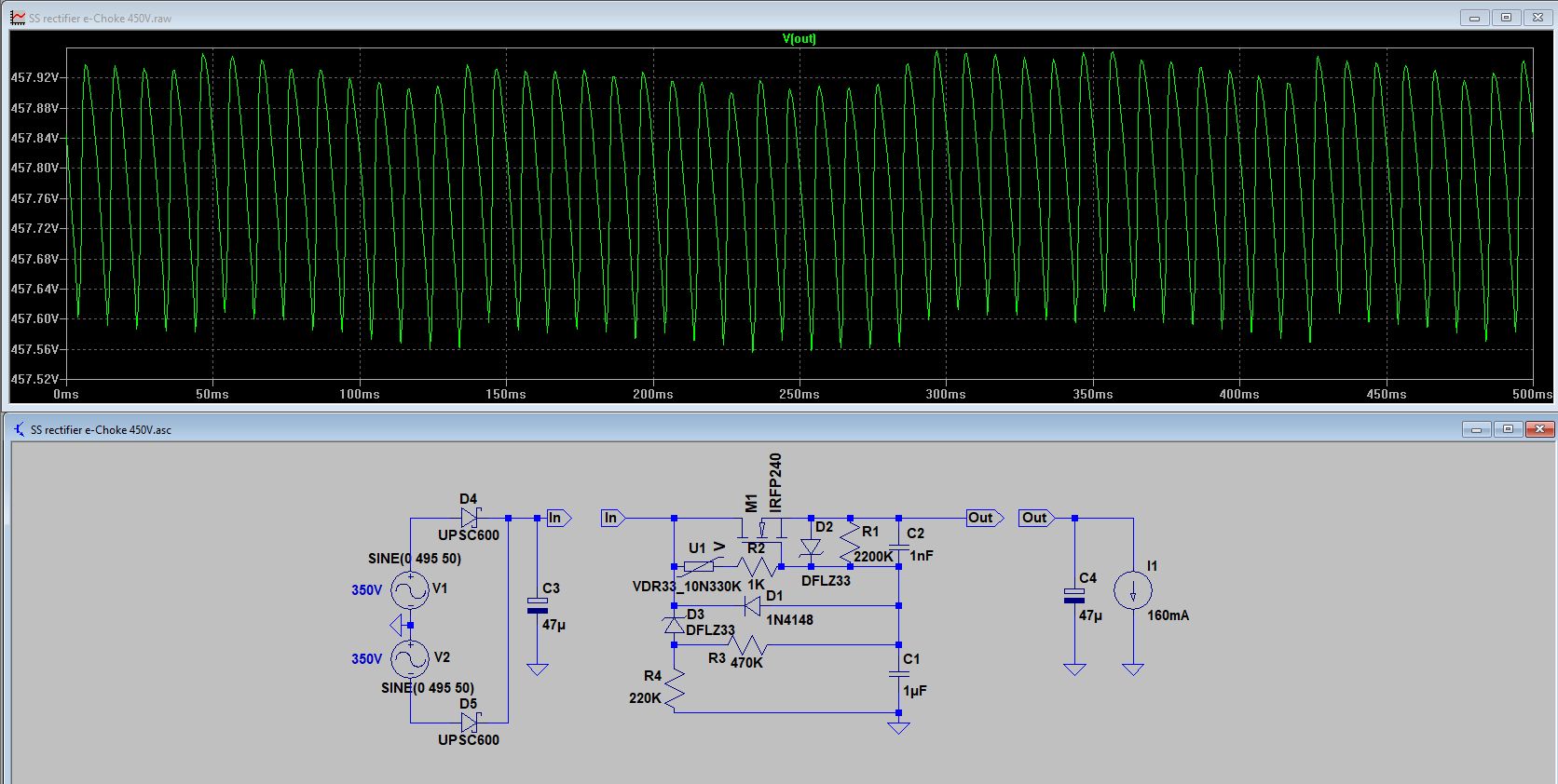

Do you know e-choke concept?
Tentlab e-choke
Another implementation:
Reactions: longspeak

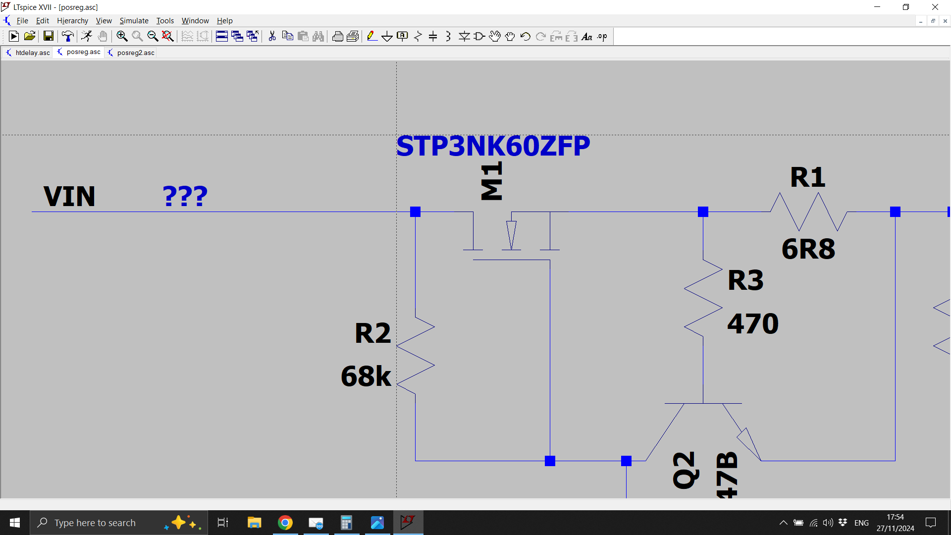

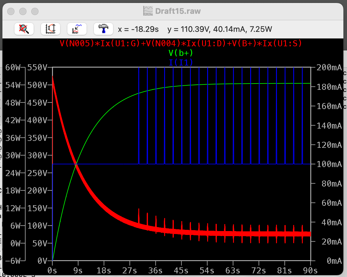

I wanted to understand the suggestions from nauta better, so here is a full circuit. I pulsed the current draw to simulate transients, when the resistor across the cap is remove the voltage varies a lot more during the pulses. I upped the zener voltage and used the body zener in place of the second one. The mosfet dissipates a few watts after startup. I'm open to suggestions on improving it - the previous circuit has been working for several years in an amp but that doesn't mean it's right.

The circuit in your sim has too small of an input filter cap. This is the first point in the circuit where we can eliminate a huge amount of hum yet many manufacturers and designers drop the ball - then hobbyists copy the error and wonder why the amp hums. In a tube power amp, this really must be 220uF or more. As others pointed out, modern caps are tiny AND the legacy cap values are based on the use of a tube rectifier with limited cathode emission ratings.
The purpose of the active hum filter is right in its name. It is not a voltage regulator. In a push pull tube amp there is no need to regulate B+, just to keep it clean especially for triode or ultralinear operation. With a clean supply node, all three operating modes for a tetrode - pentode will have the same low noise floor.
The 20M across the gate filter should be removed. Again, it interferes with the hum rejection.
A current clamp for the mosfet is an intuitive thing to add except that it ruins the output impedance vs frequency. Same goes for not having an output filter cap. You want this node to be at AC ground and for transient currents to go through that cap - which is placed locally to the output stage - not through the mosfet.
Remember that several things work together to keep the output signal clean. The push-pull amp with its output stage HUM-BALANCED (not DC balanced) will reject supply noise over its entire output range. The PA NFB loop works to cancel hum, as well. Proper wiring and grounding reduce hum. A DC standoff for the heaters reduces hum. The active hum filter will help all of this with minimal dissipation.
The PSU has its inherent regulation, mostly based on the size of the PT, but then specifically on the plate winding on the PT. Unless this is massively over-rated, regulation of this winding could be 10-20%. This does not matter for a hifi provided that the full-load voltage is adequate to produce the output power goal. At full sag, the next thing is clipping, which you never want to experience with hifi speakers.
