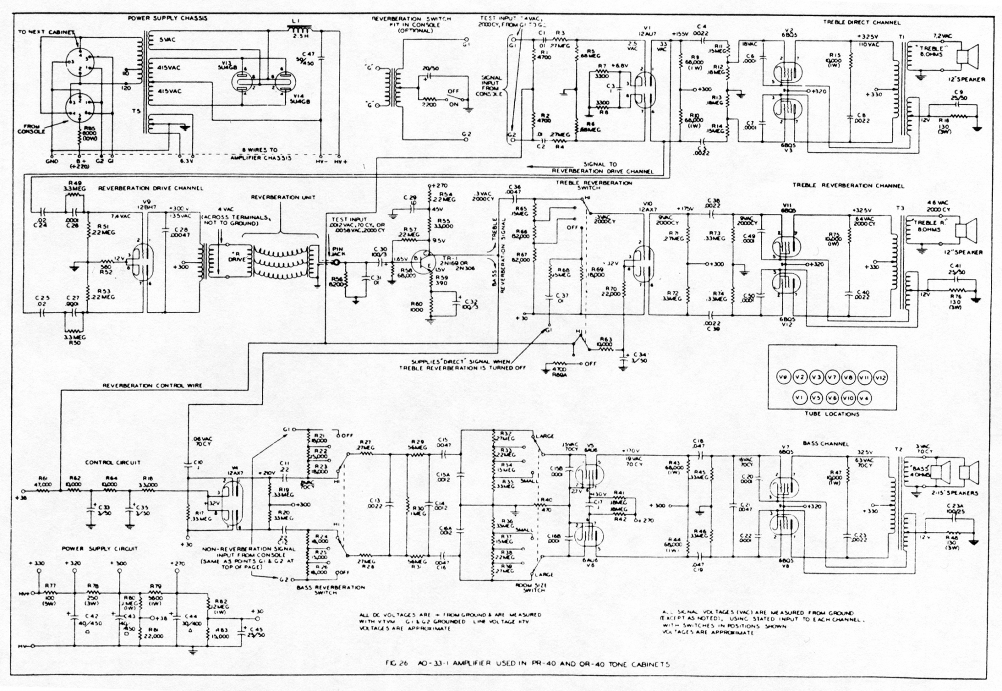

How about trying something different? Forget ultralinear, and regulate the screens with a Maida style LM317 regulator. Run the screens 20V or so below the rating. Simple mod. Pete Millett sells a PCB on eBay No personal experience with this board, but he has been selling them for years with good feedback. Recommend using the 1uF 400V film caps for C1 and C2 in the original schematic in LB-47 Fig 1. I use a TV horizontal sweep transistor mounted directly to the chassis as a heat sink.
